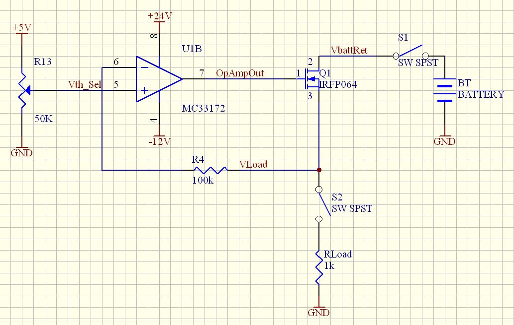

This is a continuation, hopefully the finalization of a long standing project.
It doesn't appear to be working as expected. I suspect a wiring issue but it could be design. We talked on this in the past and I have simulations, so I don't think its design. It could be the FET, it's been a while since I have worked with discrete FETs.
I have attached to AA batteries, not new so they only read 2.1V total.
When I closed S1 and S2, VbattRet and Vload go to 0.
I have some data points. but what I'm having trouble with is why when S2 is closed, does VbattRet and Vload go to 0?
With S1 open, and S2 open, Vth=1.6V, OpampOut is -12 , VbattRet is 1.67, Vload is 0.93
With S1 closed, and S2 open, Vth=1.6V, OpampOut is -12 , VbattRet is 1.75, Vload is 1.67
With S1 closed, and S2 closed, Vth=1.6V, OpampOut is 24 , VbattRet is 0, Vload is 0
With S1 open, and S2 open, Vth=3V, OpampOut is -12 , VbattRet is 0.93, Vload is 0.93
With S1 closed, and S2 open, Vth=3V, OpampOut is 24 , VbattRet is 1.77, Vload is 1.77
With S1 closed, and S2 closed, Vth=3V, OpampOut is 24 , VbattRet is 0, Vload is 0
Since Rload is between the battery + and ground, and I'm measuring across Rload, I would expect to see a positive voltage. But I read 0. It's acting like a short, but I can't seem to find it. The power supply voltages are stable and correct when VbattRet=0.
Were have I gone wrong with the circuit?

What do you think the chances are I smoked the fet? As noted the OpAmpOut voltage -12V and 24V. The FET is a BUZ101S with a max Vgs of +/-20V.
What happens if the source is floating? Does Vgs apply?
With S1 closed and S1 open, you could have anything up to 24V gate to source on the FET; that may have blown it.
I'd add a series resistor from the op-amp to gate and a 15V zener from gate to source, so the FET gate voltage cannot get too high.
The resistor value should be high enough so you are not taking excess current from the opamp with 9V across the resistor; eg. 3k3
The circuit is designed to test NiCad battery packs, ranging from a single cell to 20 cells. The drain voltage will vary from 1 to ~26V (1V for 1 dead cell and 26 for 20 1.3V charged cells). The source voltage will be equal to the number of cells being testing (1V to 20V in 1V steps).
How do I keep the output of the opamp from exceeding the Vgs max limit while also being able to test 1-20 cells? Is it possible?
You don't limit the output of the opamp, you limit the gate-source voltage as I mentioned in the last answer.
That's why you need the resistor as well as the zener; the "excess" voltage above the zener limit will be dropped by the resistor. When in normal operation, the gate current is zero so the resistor will have little effect.
Though, you may need to add a small capacitor (100pF ?) across R4 to prevent oscillation.

rjenkinsgb, I think I have run into a snag with your plan to add a zener/resistor from gate to source. IIRC, this circuit is basically a constant current source based on the current flowing through the FET then through RLoad, based on Vload = Vth = 1.0V * number of cells in the pack being tested. If additional current is added to Rload at the source of the FET (noted as VLoad) then the current through the FET and Rload will no longer be correct as controlled by opamp.
The zener needs to be between gate and source, to protect that; not in series with the gate.
When the circuit is operating with both switches closed, the FET will conduct as needed and the zener will have no effect at all.
It purely protects the gate when the circuit is not operating normally.

That is not true. As VbattRet drops and approaches Vth (or Vload) OpAmpOut will increase to reduce the resistance of the FET. OpAmpOut will start at -12V drawing current from Rload through the Zener (problem #1) and rise to +24V but be clipped at 15V by the zener and start conducting through Rload (problem #2). The ONLY current through Rload can be that through the FET, or the accuracy and measurements will be useless trash.

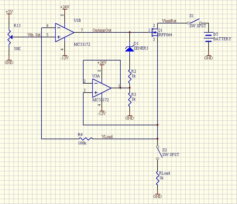

The zener cannot be connected directly to the FET source from the gate/opamp output. There can be no contribution of current through Rload by any other point. With that given, how do you suggest to prevent the gate-source voltage from exceeding the Vgs limit?
As you stated, the point of the zener is to clamp Vg to less than 20V (15V or so based on using a 15V zener diode) above Vs. The opamp added to the circuit above provides an isolated copy of Vload (aka Vs) as a reference for the zener diode. As OpAmpOut rises to more than 15V above OpAmpVs, the zener will clamp Vg to 15V. I am not sure what value to use for R2 and R3. Actually I debate on the need for R3 and the current should be able to go through the opamp output. Additionally I think a standard diode is also necessary to prevent current flow from ground to the opamp output when the output is at the lower rail (-12V).
OK, I see what you are trying to do.
You need to move the series resistor to the output of the other opamp, or the zener will have no effect.
That needs a direct connection and the output from the first opamp needs to be limited, so the second one can override the gate voltage via the zener.
Try 4k7 for the series resistor. R3 should not be needed.
Or, if 24V to ground is sufficient, just eliminate the negative supply? That avoids any negative feed via the zener and the positive limit can only put current through the load with the switches off, when nothing is being tested.
I will try that. I was working on simulations last night and could not get them to work and I think this is the reason why. (I'm doing simulations because I don't have any 12-18V zeners on hand).

I reduced the voltage to 18V to stay below VgsMax and changed batteries. As I hypothesized, one of the previous batteries did not have the ability to take a load (voltage cropped to 0 under a 1k load). Upon replacing the batteries with new batteries (well actually used, but I checked that they could/would handle a load), the circuit performed as expected.
I will be building v2, with the zener diode included to clamp the output to less than VgsMax. I believe the zener diode will work to clamp Vg to <15V above Vs, but is there another way? Is there a way to limit the opamp output, or add another stage where the output is limited? I' thin king the circuit would have to work such that stage 2 out = stage 1 out, unless/until stage 1 out >15V above Vs, then clamp to 15V+Vs?
