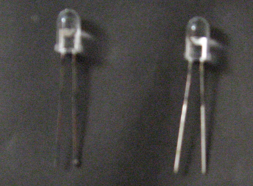

I don't know the forward voltage drop and also the part number. I can give you a pic of these LEDs. These LEDs emit RED light.

OK,
Please do the following test:
Connect one LED, via a 470R resistor to a 9 Volt battery.
Use a voltmeter to measure the voltage across the LED and tell us what you measure.:)
connected a LED to +9.6V (adapter) with a 560ohm (don't have a 470ohm) and measured the voltage across the LED which is +1.70V

Connect 3 LED's in series, 3 * 1.7V = 5.1V
Assume a 9V battery, when discharged 7V.
Assume 20mA LED current.
So 7V - 5.1V = 1.9V/0.02 = 100R [if you dont have a 100R a 120R will be OK]
So connect a 100R in series with three LEDs also connected in series.
Question: what colour do the LED's glow when lit.?
LED's glow in RED when lit. I have six LEDs. Do I Connect Six of them together in series or just 3 of them?
You will have two separate chains of 3 LEDS and a 120R
Do you follow.?
When the battery is new and the resistor is 120 ohms then the current is 33mA which is higher than the max allowed current for many LEDs (30mA max).
Only one LED was measured. Maybe the others have a forward voltage of only 1.6V and maybe the 120 ohm resistor is 5% low at 114 ohms. Then the current will be 37mA.
Use 150 ohm resistors.
It's awesome! LEDs are very bright!!! I've used 100ohms as resistance to connect the 3 LEDs in series. I have a dumb question to ask: Can I connect the LEDs to +12V instead of +9V? Will it burn out the LEDs?
