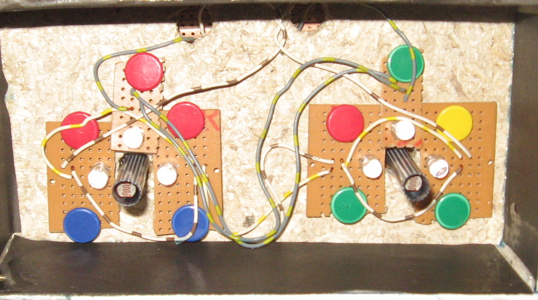

Can you please suggest me what's the best combination of resistance and voltage for making the LEDs brighter? I have used six LED (transparent which emits red light) but the light is not bright enough. that's why my LFR is not working satisfactorily.

Will you please post a simple sketch showing how and where the LED's are connected, also what type of LED.
I have looked back thru the posts and I cannot see a circuit for the LED's.:)
Here's a picture of how i placed the LEDs:
I have connected the LEDs with a common wire. The wire is connected to +6V with a 320ohm resistance (100 and 220 in series). Should I add more LEDs? I have run my LFR over a black surface with track made of white tape.

Are you saying you have connected 6 Red LED's in series like the drawing.???
Each LED has a forward voltage drop of 2Volts.
OR...
the second drawing. Which is it.?
Look at this drawing.
Three pairs of 2 LEDs [Red].
The LEDs are too dim because their current is too low.
