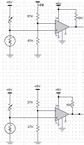

I need to clear another thing. I'm a bit confused. Two resistors are used as voltage divider in the comparator at the inverting I/P. Now I my question is that do I need to use the same value of resistors for both Comparators I'm using?? I have used two 57K resistor for the first comparator and two 27K for the second comparator. Plz clear me out.

ruzfactor said:
hi ericgibbs,
Looking at your photograph of the LED's and LDR's I would say the two comparators should be the same.?
The use of the 27K and 57K in the comparators will set the switching voltage levels for the comparators.
What switching levels have you designed the circuit for.?

Actually I have connected like this schematic. Please check it. For Both inverting I/Ps i get about 2.9~3.0 Volts (I'm using +6V instead of +5V). Is it necessary to use same values of resistors for both comparators?
If you use two equal values for both comparators you will get the same voltage at the Vref input.
The variable resistor in series with the LDR's will set the comparator switch point voltage [light/dark]
Are the two LDR's going to be located either side of the line they have to follow.?

From the picture, I would say the two LDR detectors are identical.
Whats the voltage at the LDR's when dark and light.?
Track background is black and two 470ohm used for the two LED series.
At first I tune the pot to set the Input voltage(2.9~3.05V) close to Reference voltage (which is around 3V). When No light is detected, I/P voltage becomes about 3.4~3.5V. And when the LDR directly comes below the white tape, the I/P voltage becomes very low(around 1.17V) and slight displacement would make it vary between 1.85~2.4V.
Plz correct me if I'm wrong: when V I/P is less than V ref then the O/P is LOW
When V I/P is greater than V ref then the O/P is HIGH.

The LDR signal is connected to the Non Inv input of the Comp, so when the LDR signal is less than the Vref the Comp output is Low and vice-versa.
It sounds OK to me.
