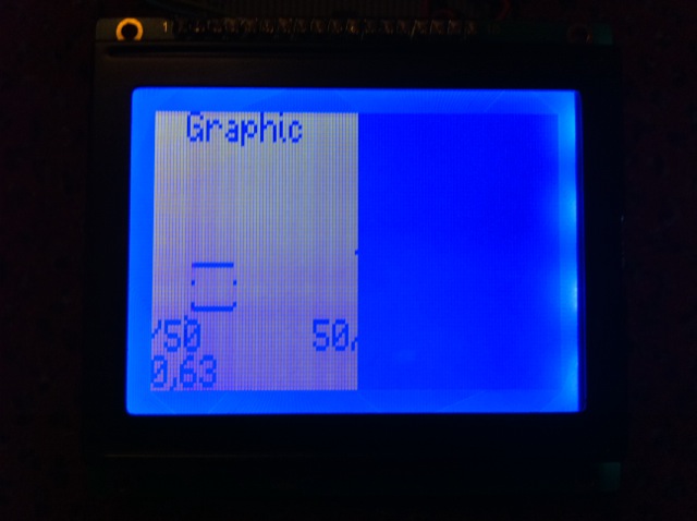

I've just tested your library and program freezes exactly at the same position :
in your code , it stops at return glcdData;
unsigned char glcd_Read(void)
	GLCD_EN = GLCD_EN_HIGH;
	glcd_Delay();
	glcdData = GLCD_DATA;
	GLCD_EN = GLCD_EN_LOW;
	[COLOR="Red"]return glcdData;[/COLOR]
If i comment out return glcdData;, then program runs properly.
But it only lights the left hand side board, if i try to Put a Message that is located in the middle on the display it is not working properly !
What should i do to have all display available ?
If i put a text longer than pos (64,64) then the display returns to x = 0 position but keeps y postions ( see attached picture for message : "50/50" written at x=50 y=50
Here are the instruction i used to display the attached picture:
glcd_SetPos(10,0);						// Positionner le curseur (x,y)
glcd_PutMessage("Graphic");				// Ecrire un message
glcd_SetPos(50,50);
glcd_PutMessage("50/50");				// Write "50/50" at position x=50 y=50
glcd_SetPos(0,63);
glcd_PutMessage("0,63");				// Write "0,63" at position x=0 y=63
glcd_Plot(63,32);
glcd_Box(12,35,25,45);
glcd_HorizontalLine(10,40,50);
By the way :
Can someone tell me why glcd_Read returns glcdData , why this is usefull ?
It looks that glcd_Data is never been changed during glcd_Read function ...
if i understand well, gllcd_Read function sets some pins to proper state and do only glcdData = GLCD_DATA;
Many thanks for your help,

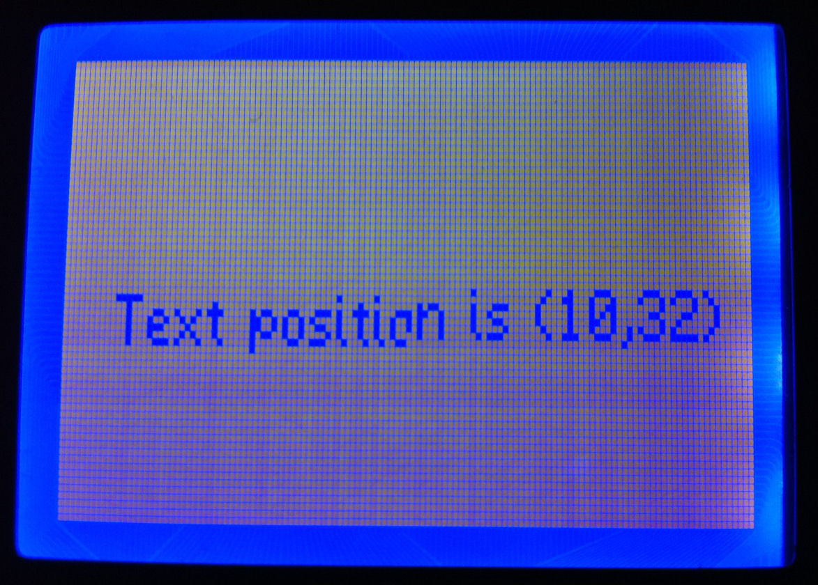

Hello,
I finally succeeded to get hkBattousai GLCD library working ...
( I've got a problem with CS2 pin )
But this library looks getting outstanding results :
- It looks that it is reverse displaying method : White on Black instead of Black on White
Is there a way to change this ?
- When i try to display a long text that uses the 2 controllers ( CS1 and CS2 ) :
Text well displayed until x position is < 63,
when x position is > 63 the rest of text 1 pixel shifted up.
( see my attached capture, "n is (10,32)" is centered with the beginning to the text.
Also "o" letter is also a bit overwritten. ( 2 pixels are missing at the right hand side )
- When i try to display only one pixel with Plot function, i do not get anything on the screen.
I will appreciate your help and advices,
Best Regards,

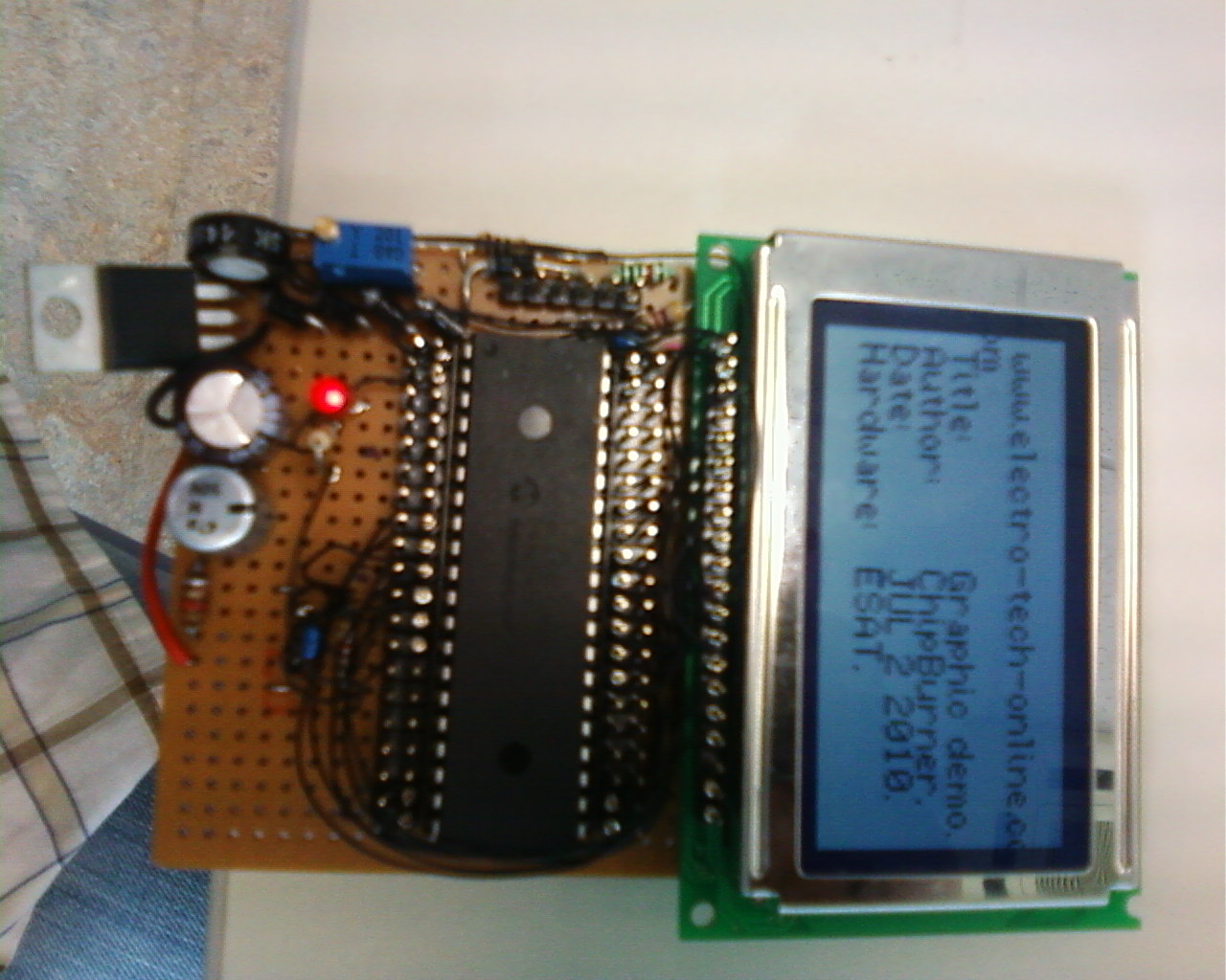

wg12864b lcd problem
hello hkbattousai,
i have a similar graphical lcd like the one that you have, i got it from turkey, its a wg12864b and i'm using a pic 18f4550 micro controller.
i have wired up the lcd to my pic using a breadboard and i will attach a potentiometer to adjust the contrast soon, but the problem is that my lcd does even come on! i burned the code successfully to the pic and everything looks wired properly, i hope you could help me . i shall attach the code and and my project schematic. to open the second file simply remove the .zip at the end of the extension and open using proteus simulator
  • TetrisPrograma.c
  • TetrisDesign.DSN.zip
^ Your zip file is not opening, it is corrupt.
The C file is a very big (+2000 lines) and messy (probably in Spanish), thus very hard to understand and I couldn't find any glcd commands in it.
Can you briefly write here (between
 tags) your relevant glcd code?
 tags) your relevant glcd code?[/QUOTE]
 thanks hkbattousai for the quick response, i dont know much about glcd part of the code as it was sent to meby another programmer . my goal is to write a small game on my graphical lcd. if you could show me how to get my glcd working and putting some graphics on it then i might succeed in writing my game for it. i'll reupload the schematic. thanks again.
  • TetrisDesign.zip
