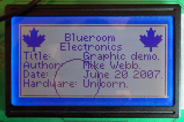

I've just written two new functions using my basic analytical geometry knowledge:
void glcd_DrawLine(unsigned char x1, unsigned char y1, unsigned char x2, unsigned char y2)
	// y = ((y2 - y1) / (x2 - x1)) * (x - x1) + y1
	float m = (float) (y2 - y1) / (float) (x2 - x1);
	for(glcdI=x1; glcdI<=x2; glcdI++) glcd_Plot(glcdI, (unsigned char) (m * (glcdI - x1) + y1));
void glcd_DrawCircle(unsigned char x, unsigned char y, unsigned char r)
	// y = y0 - sqrt(r^2 - (x0 - x)^2)
	// y = y0 + sqrt(r^2 - (x0 - x)^2)
	unsigned char rt;	// The root term
	signed char i, j;
	for (i=x-r; i<=x+r; i++)
		rt = (signed char) sqrt((float) r*r - (float) (x-i)*(x-i));
		if ((i < 0) || (i > 127)) continue;
		j = y - rt;
		if (!((j > 63) || (j < 0))) glcd_Plot((unsigned char) i, (unsigned char) j);
		j = y + rt;
glcd_DrawLine() is working good, but glcd_DrawCircle doesn't display anything. Do you guys have any idea why?

It running!!!
I am donkey :eek: I forget rewrite header. I have three versions, I use third but header a had write first.
I added the code to the plot routine to exclude off screen pixels and you can now plot on the edge of the screen. This is what PutCircle(50,50,20); does. I think it looks pretty good for an integer maths circle.
