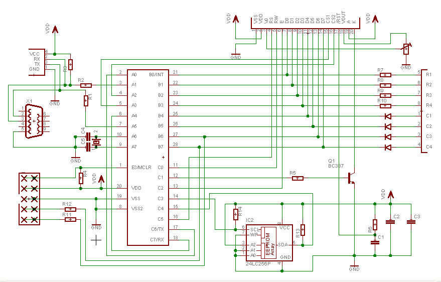

I've been trying to interface 18F2550 and a 128x64 pixel graphic LCD for weeks. I tried several libraries found on the web, but none of them made the LCD print a single pixel on the screen. I'm really stuck at the moment, and I need guidance and new ideas.
The best library I found so far is the one I found in this forum. You can access the thread from here. For simplicity, I'm going to add source source code of the library below.
I also checked the signal levels at both PIC and LCD pinouts by an oscilloscope, there are meaningful pulses, the system PIC is working for sure.
The major parts I used are listed below:
  1. IDE: MATLAB 8.40 Academic
  2. Compiler: Microchip C18 3.34 Academic
  3. LCD: WG12864B, with KS0108 Controller (Detailed datasheet, Electrical specifications)
  4. PIC: PIC18F2550, with 20MHz crystal(Page, Datasheet)
These are photos of my LCD:
**broken link removed**, **broken link removed**
And these are photos of my circuit:

Maybe you have it connected up wrong.
Do you have,
Reset to 5V?
Vee to a pot with the slider to V0 and other end to Vss?
I've attached a schematic for a project I did that shows how mine is connected up. As you can see my pinout is different to yours but most of the designs I've seen have the same pinout as mine.
Reset to 5V?
I did both of these, you can see it in the photo of the circuit.
I connected 5V to reset, my blink-a-led code is working.
One of the end of the pot is connected to Vdd instead of Vss. I did so, because datasheet recommends to do that way. Since you said it, I tried connecting to Vss, but it didn't change anything.
