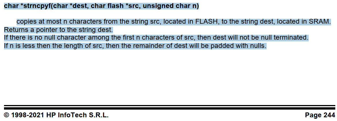

I'm using codevision AVR. in string.h lib when one of the arrays is const an error occurs.
for example i want to put a array of string from one array to another like this :
unsigned char A[11];
const unsigned char B[11]={"HELLOWORLD"};
when i use strncpy like this:
strncpy(A,B,10);
i have this error
Error:, #included from: main.c: function argument #2 of type 'flash unsigned char [11]' is incompatible with required parameter of type 'unsigned char *'
and this is the same for all of string.h lib functions.
in ARM and keil compiler i didn't had this problem but in codevision error occurs.
i know i can use for loop but is there any way to avoid this error?

i droped the unsigned and still have the same error it says that flash char is incompatible with char so the problem is the const type if i put both array unsigned or signed it work but if one of them become const error occurs I'm looking for a way to avoid this
const types may be stored in program memory rather than data memory. If the CPU architecture in question cannot use the same instruction for both areas, const types have to be handled using special instructions.
Try using memcpy() instead, it looks to use the same arguments & the second parameter is a const *
Normally in this case, they will have thier own "special" routines.. I would also use a workaround.. Sprintf() is normally in the stdio.h and can handle this.
sprintf( A , "HELLO WORLD!");
Will do the same thing.. Most embedded tools have this tool.
Does removing the 'const' from B make the error 'go away'?
If not, what about using: strncpy( A, B, 11 );?

my problem is not only strcpy I'm using strncmp and strstr. i can use sprintf instead of strcpy but what about others?

it doesnt have an error but seems not working after building project char A wasn't helloworld
i think best option is i make my own function with for loop
yes removing the const make the error go away but i want to do it with const.
const char stores in flash but char stores in ram i want to optimize my ram usage so i have to use const.
Then use:
