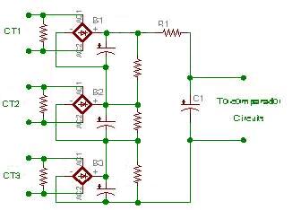

As per your suggestion i drawn following diagram,
Is this what you say to be added to the Comparador Circuit?
do you think this can work?
If i understand you wrongly and if this is not what you say can you draw a schema for helping me out.
Hope i'm not bothering you or other members of this forum
thanks a lot.

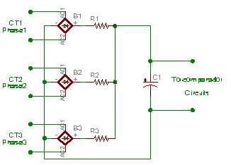

No, for adding three voltages, connect the bridges in serial.

Hi Sarac,
Your circuit is nearly right for what I described as Method 2 (sensing the maximum current in any phase). But you don’t need R1, R2, R3. Instead, connect the +ve output pins of all the bridge rectifiers together and connect them to the +ve of C1. C1 will then charge to the highest phase. You can use the op-amp output (as in the link) for the third phase. Construct it exactly as they show.
BTW, you need load resistors on the CTs – it is most important. They are current operated devices and the secondary current is inversely proportional to the primary current times the turns ratio. In your case, assuming 220V per phase, you will have around 150A max per phase. If you have no load connected across the secondary winding then the voltage across the winding will increase to try to force current through the non-existent load, and that could become many thousands of volts! I don’t know which CTs you are using but load resistors may already be fitted. The turns ratio of the CT and the value of the load resistor will determine what voltage you get.
As I said, the voltage across C1 will be proportional to the highest current in any of the phases (don’t forget that 1.2V will be lost across the bridge rectifier). If you feed this directly to one input of an op-amp, you can feed the voltage you have selected with a pot, to the other input. The op-amp then is used as a comparator.
The circuit shown by Sebi is for the measurement of power, which I called Method 1. Sebi is using the voltages in series whereas I was summing them at the inverting input of the op-amp to get their average value. The end result would be the same.
If you can give some more details, ie. 110v or 220v, CT turns ratio, and loading resistors, I can work out values for the op-amp, if you want.

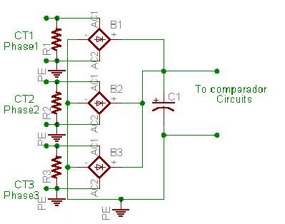

Pepe, Sebi thnks for the reply,
I have redrawn the schema as per Pepe's correction. I assume that parrallel connection of the bridges would be more accurate then the serial connection. I have also included a ground connection ( like shown, in the link )

Attention! Don't connect ground to bridge input and output, choose one, i recommend the DC-side. Resistors value 200...500ohm, capacitor should be 10...100uF, and need a parallel resistor for discharging, because the comparator input no loaded it.
Like Sebi said, don't ground the CT winding - you have already got the circuit grounded at the C1 -ve lead. Yes, you need a discharge resistor across the cap. As I said earlier you need a time constant of somewhere about 1second. I suggested a 10uF cap and a 100K resistor.
You have drawn 3 CTs. Are you not intending to use the circuit from your link which uses two CTs plus an op-amp? I suppose it will depend on the cost of a CT.
Your 132KVA generators produce 200A per phase at full load. With a 50:1 CT you would get 4A secondary current, which I thought was an awful lot to be handling for this application. To get about 5V from them you would need 1.5ohm resistors at 24Watts each!

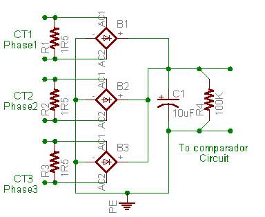

Ok, i have re drawn the circuit ( as your description ) i think all is in order now.
I have well understood everything in this proposed circuit
only one thing need to be clarified is that the resistor No 4 ( R4=100K ), why do i need to discharge the 10uf Cap. for 1 sec. time constant since
the comparador circuit shuts down the generator, this circuit will be
de energised and everything to be reseted, being ready for next use.
BTW i don't want to make this project more complicate for saving a CT thus i will use 3 CT. The link i have provided was just for info.
The CT i am intending to use is regular CT which are generaly used to display current with analog Ammeter. It is supposed to get 5A, when 250A power consumed ( so it is called 250/5 CT ).
i'm using these CTs Bcs i have found only these ones.

Sarac said:
Pepe, Sebi..
..... only one thing need to be clarified is that the resistor No 4 ( R4=100K ), why do i need to discharge the 10uf Cap. for 1 sec. time constant since
de energised and everything to be reseted, being ready for next use....
The reason for the 100K resistor is to discharge the capacitor after a short time. If you didn't, and the current dropped from 100A to 20A, the cap would hold its charge and your comparitor circuit would think that 100A was still flowing. The ideal discharge time is as quickly as possible. But if you make it too fast then the voltage on the cap will pulse high as each phase passes its peak and then fall again as the cap discharges, giving you ripple. As your circuit is looking for a drop in cap voltage to indicate the load current has decreased, it would cut out the 2nd generator before it should.
If you pick a time constant of about 1second, the cap voltage will only drop by a small amount between phase peaks, yet will quickly respond to a reduction of voltage over a couple of seconds.
