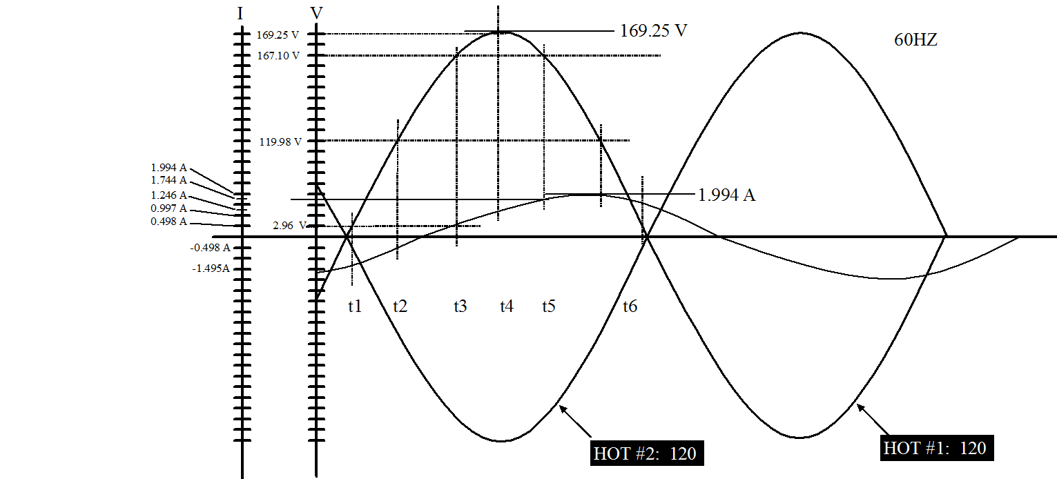

One more thing. This is okay to measure an AC circuit... assuming its a 120VAC (Hot plus neutral) system . Suppose we were to measure a 240 VAC circuit... (Please view attachment) ...you know like the one that powers your hot water tank in your home. I know that in this case the circuit would be purely resistive... but let's suppose it was for other loads which would also have an inductive component as well. Given this type of circuit... since the voltages of one hot is 120VAC and the other hot is 120VAC but 180 degrees apart... can we do the same calculations on one of the 120VAC and doulbe the readings for the other 120VAC side.
For example in our sample we get 120 watts of true power.... if it were a 240 circuit though.... it would obviously be 240 watts.... is this correct?

RobertRoss,
Since there are two separate power sources connected to a common ground on a 240 circuit, I would think that you would need two sets of VI measuring transducers. One for each hot line, and both referenced to neutral or ground. The total power would be the sum of the two.
