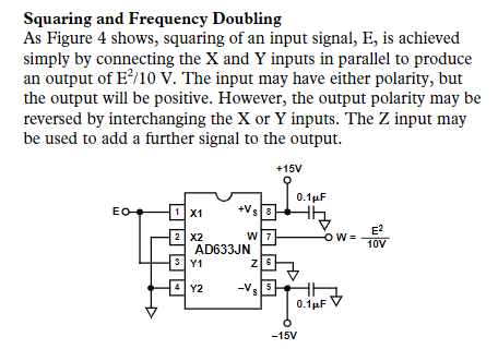

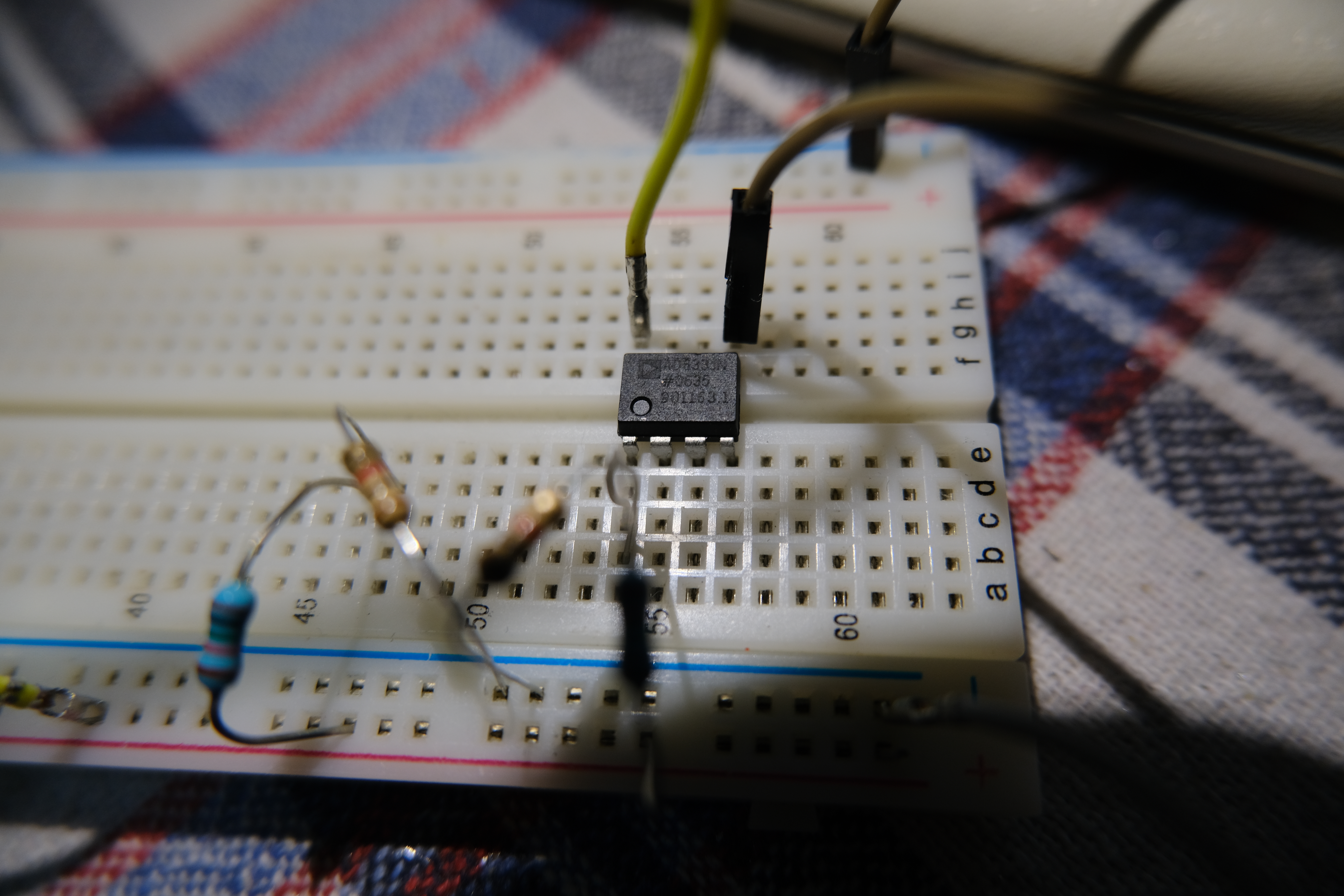

I am trying this setup with 10k and 1K resistor dividers to have around 1V at pins 1 and 3 but when I ground pin 2 and pin 4 it starts heating up rapidly to a point it is too hot to touch. Sine I am suspicious that this chip is fake and I got it for 3 usd when it is sold for around 20 locally I did not expect it to work from start but I wasn't expecting it to overheat like this. All other chips I got from same seller functioned to some degree.

Sure looks like a bad part. Chinese copy ?
Regards, Dana.
Probably. Well it was worth trying. No way on Earth I am paying 20USD for one and seeing it blow up when I connect power in reverse as a mistake.

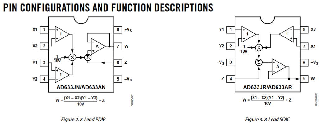

I wonder if you have the "JR" or "AR" chip. The pinout is different in such a way that the -Vs goes right into the Output Op Amp.
Reference: (Page 5)
It is AD633JN which got same pinouts as AD633AR. I tried connecting it both ways from datasheet and both did not work.

"It is AD633JN which got same pinouts as AD633AR" ... but they are different pinouts ....if you wired it wrong the first time then correcting the wiring may not solve the problem since now you may have a damaged component.
