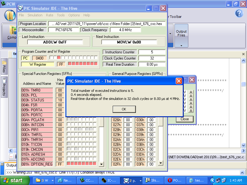

Try this, I think this is what you want.
  • test_676_CCS.c
  • test_676_CCS_01.h
Not sure about that unless its the call 0x3ff. Not sure why the compiler puts that in there.
EDIT: There is no call 0x3ff. It is jumping directly to the return from interrupt, and seems to be crashing at the RETIE instruction. It was working in MPLAB SIM. I'll try it again.
EDIT2: There is a call 0x3ff at instruction 038.

I don't think so, because your never going to get out of the endless loop. EDIT: In order for the default section to be executed, ProcessMains() would have to return something other than LOW_VOLTAGE, HIGH_VOLTAGE, OR NORMAL_VOLTAGE.
Try this. The LED should blink in the interrupt for 3 mins, and then stop. I also added a delay after the A/D conversion because MPLAB SIM kept complaing that a new conversion should not be started until after 2 TADs have passed. The delay is 5 ms. The interrupt fires every 10 ms. Take a look, and let me know.
  • test_676_CCS.c
now working OK. but led1 action only on type not blink .right now i check it only oshon soft ,not real card .on real card i check it letter .
Did you wait for the simulated 1 sec time to pass, because it it was working in MPLAB SIM.
