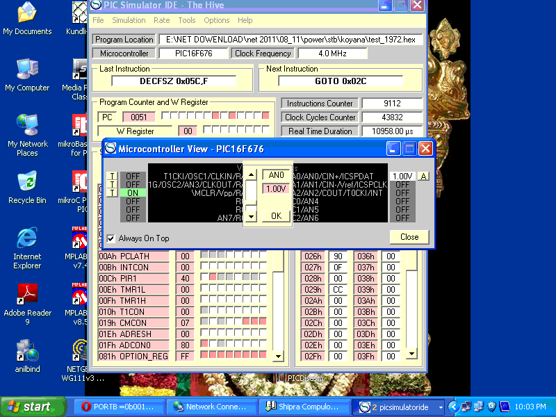

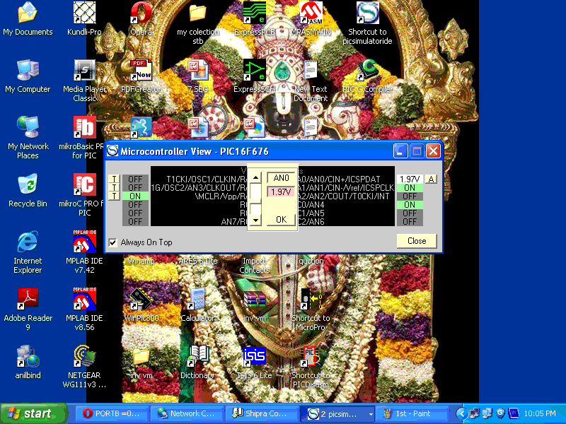

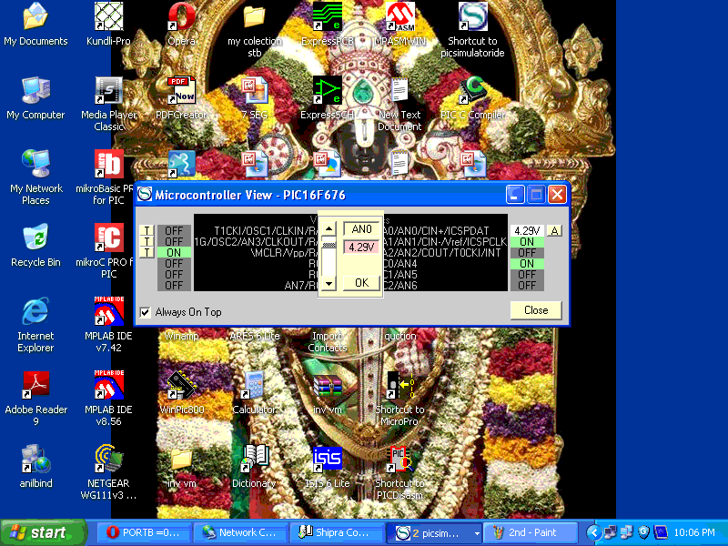

my OSHON SOFT demo ver. it is work very sholo .so for OSHON SOFT testing i use 100ms instead of 1ms.
my problom in 3rd png file.
sorry my bad english...
Ok, I'll study your code tomorrow morning. At 4.26V or ch=4257 what should be happening? All relays off? Another thing you might want to do is make a function/subroutine that processes ch as with your two loops your code is getting a little long. I would try to rewrite the code so that you only have one while (1) loop. After I get your input tomorrow on what should be happening at 4.26V, I'll see if I can help more.
my mean when i\p volt suddenly up or down , mcu goes like hange .its o\p (rl1 to rl4) position show as lost i\p time .
for example... when i\o 2.125==== R1=ON ,R2=Off,R3=ON,R4=Off. if right now i\p immediate goes high\low relay position (R1=ON ,R2=Off,R3=ON,R4=Off ) no change as requited .
I think the sudden jump from 1.9V to 4.26V causes code is not to get executed, which is the reason for the hang. Your if((ch<=4000)&&(ch>=0675)) line only handles ch to 4000. Unfortunately I still don't know what should happen at 4.26V. I have if(ch > 2100) [high voltage protection] and if(ch <= 1300) [low voltage protection] commented out, should they be active at this point? Ok talk to you tomorrow.
oh ohooo may problem solve!
thank u my dear sir !!!!!!!
