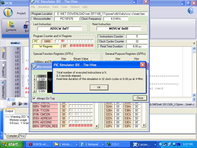

right-now OK..
>>> Warning 203 "main.c" Line 76(1,1): Condition always TRUE
Memory usage: ROM=53% RAM=17% - 30%
0 Errors, 1 Warnings.
but not work with oshon soft ....

I'm not sure why its only running 5 instructions in Oshon Soft. I did notice that there are a couple of gotchas between converting MikroC to CCS. Namely the default data types are different. In MikroC, a int data type is 16 bits; In CCS, it is 8 bits. So I changed int to int16, and long to int32. I'm getting absurd numbers at 4.0V for AN0 in Oshon Soft. I'm looking into it. I'm going to try to use MPLAB SIM because I like the debugger better, but I'm not sure how to set AN0 in it, so I'm trying to do some research.
rmain1972 I complied the code you posted with mikroC and it didn't use but what i posted

Sahu... I run the code on oshonsoft (curious) the 4th instruction is "call 0x3ff"... On some processors this is a reset, but 0x3ff is the last location on the chip and should contain 0x00 (nop) and yours doesn't.... Did you change processors along the way?
It seems to be working in MPLAB SIM. I loaded the AD Result registers through a stimlus file with 0x15E (350 or 1.7V), 0x2BC (700 or 3.4V), and 0x332 (818 or 4.0V).
The processor defaults to the A/D result as left justified. The CCS compiler does not change this. I had to change it to right justified by setting ADFM bit to 1. As well as change int to int16 and long to int32. MPLAB SIM also warned that conversion clock was less than 1.6 µs, so I changed to ADC_CLOCK_DIV_32. This was for a 676 running at 20 Mhz. I never asked at what speed your running your 676 at. In Oshon Soft, it looks like 4 Mhz. Is that correct?

I don't understand what you are trying to say. It runs in MPLAB SIM and Oshon Soft. You'll need to test it for the various voltage levels. My version still doesn't handle ch>4000. You'll have to handle that. Refer to post #25.
thank u my dear sir rmain1972
now its working with OSHON SOFT sim.

SW2 is a define, and it resolves directly to a number; therefore the compiler never created the code for the test. In order to read a pin in CCS, use the input() function.
So your test code should be:
C:
 if ((ch<=674) && (input(SW2)==1)) //Low Voltage protection enable if SW2 is always on(conect with GND).
   	return(LOW_VOLTAGE);  //if SW2 is always off(no conect with GND & +5 volt.) Low Voltage protection disable
Took me a few minutes to figure this out. I would set a breakpoint in MPLAB SIM, and it would tell me that the 'breakpoint could not be resolved." The reason it could not be resolved was that it was being optimized out.
