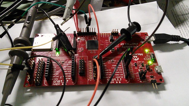

I've just started creating a new (from an existing mips/pic32mz configuration) cpu and board port for this dev board. So far only a few I/O items are working like the debug uart, user leds and rgb led but it boots, runs the 'hello world' and timer serial port examples and the Linux based bare-metal MIPS-MTI compiler/linker creates a mplabx-ipe compatible hex file for flashing.
http://www.microchip.com/Developmen...8Q1&utm_content=DevTools&utm_campaign=Article
Fork for riotos software: http://github.com/nsaspook/RIOT/tree/PIC32MZEF
http://github.com/RIOT-OS/RIOT/wiki/Family:-MIPS
working toolchain: http://codescape.mips.com/components/toolchain/2016.05-03/downloads.html
SDK Installers v1.4
Update the Linux shell path (in .bashrc) to include the correct compiler after the tools install.
export PATH=$PATH:/usr/local/go/bin:/opt/imgtec/Toolchains/mips-mti-elf/2016.05-03/bin

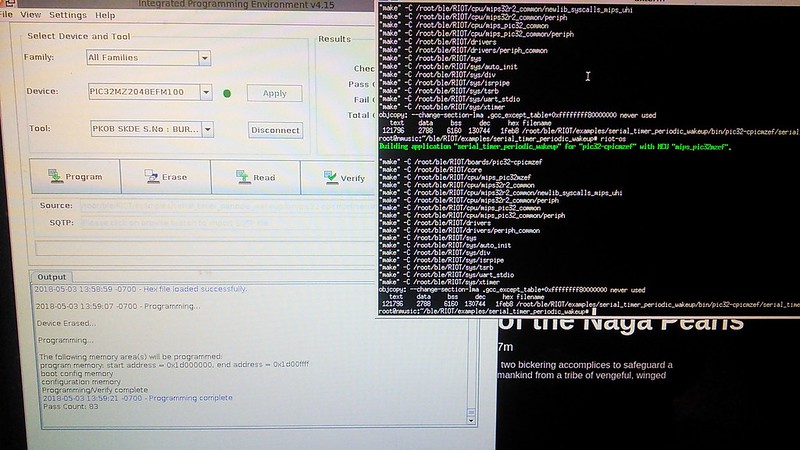

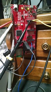

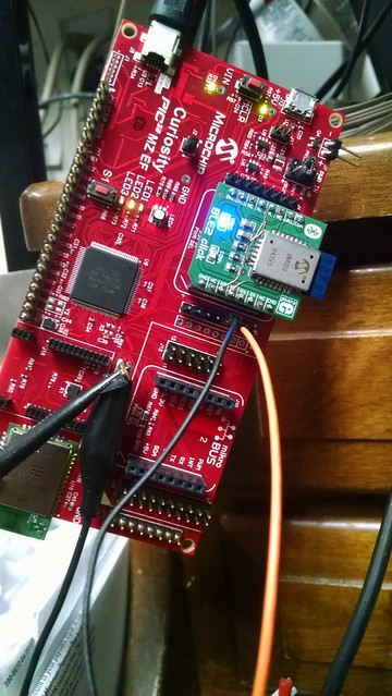

The LEDs, switch, usb power, uart and spi (found a good starting example on the net) drivers are running on the hardware so it's possible now to communicate with radio modules and other serial devices once testing is done.
Still creating a board file with all the pin and device connections but most of the simple communications signals to the Mikro Bus headers are done.

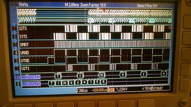

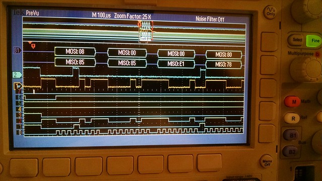

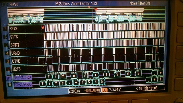

SPI MOSI data with SCK clock on the top and two UART serial ports (and one debug serial port) on the bottom running the driver test program.
Serial data from uart4 out -> uart2 in -> spi2 out as a 4 byte sequence for every uart byte received.
RIOT-OS application testing code for this board after being compiled and flashed on a Linux workstation using the baremetal MIPS compiler with MPLABX-IPE to program the hex file result.

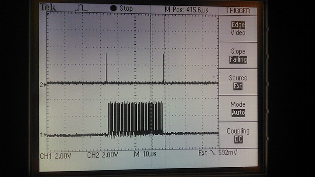

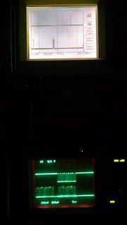

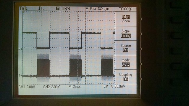

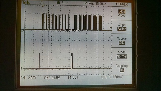

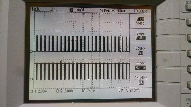

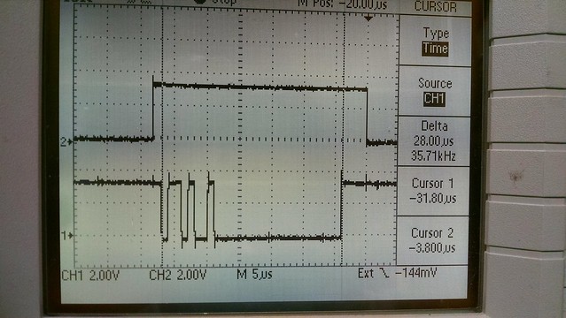

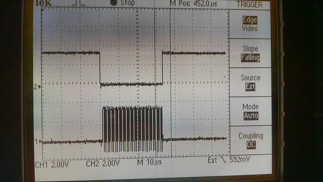

uart tx write processing time on top, bottom trace driver processing time for spi1 clocks started from that byte of data.
The top trace is the rx_irq latency (time between toggles) between uart interrupts, bottom trace driver processing time for spi1 clocks started from those interrupts, top rising debug edge to spi clock edge(depends on the SPI mode).

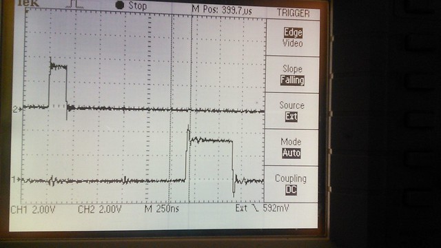

Here I'm sending both uarts (1,2) the exact same signal from uart 4 so the time between toggles tell me how long the processor takes to handle both.
Debug signal timing.

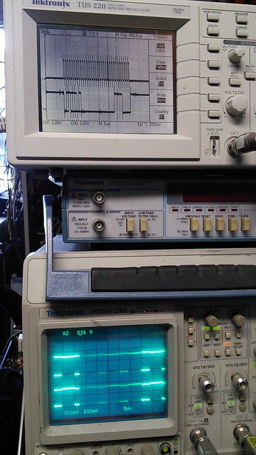

Because the SPI write is in the interrupt context any pending device interrupt flags must wait until the transfer is done as shown above in the toggle after spi write finishes and the uart ISR returns to the vector. With multi-vector the higher priority interrupt would preempt the current interrupt, process the pending flag and return to spi processing when done. You normally wouldn't spend too much time in a typical interrupt so the effect on most real-world RTOS I/O is small outside of testing worst-case examples looking for corner-case bugs.

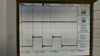

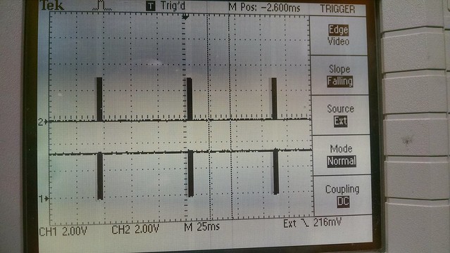

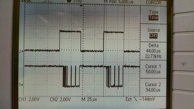

Another issue to examine is processor memory speed in a 32-bit controller with cache and a 200MHz ref clock/sysclock. Using L-1 cache properly is vital to system speed.
The test program uses a cpu/memory bound busy loop for a time delay.
If the system is set for NOCACHE this is the resulting delay.
Delay timing.

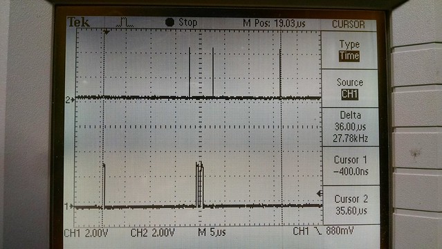

Driver processing timing. 44.00us

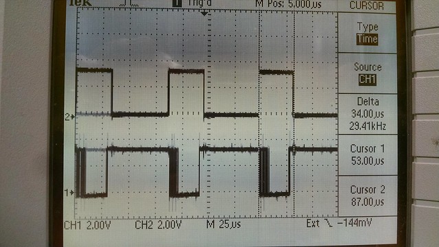

Enable cache using the non-coherent, write-back, write allocate mode.
The delay loop now runs in L-1 cache with a huge speedup. The amount of speedup changes with program execution (pipeline flow) so you can't use
busy loops for precise timing on a pic32 with cache enabled.
Driver processing timing. 34.00us with most of the time spent waiting for the 4 byte spi transfer to complete in 28.00us

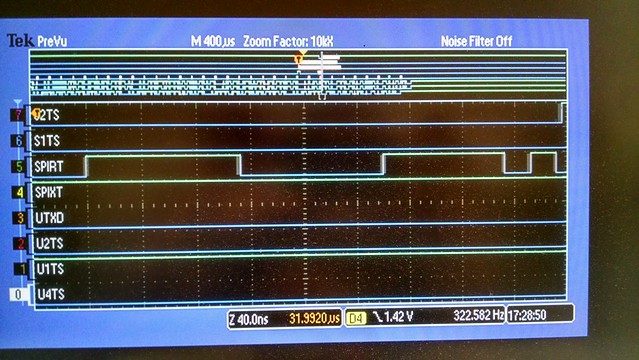

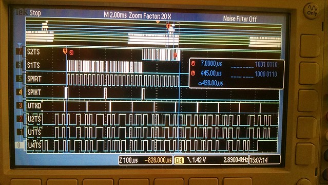

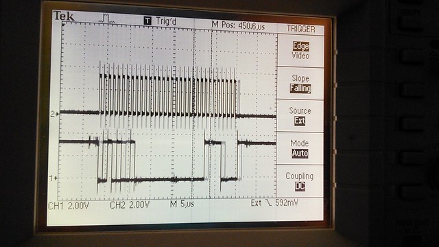

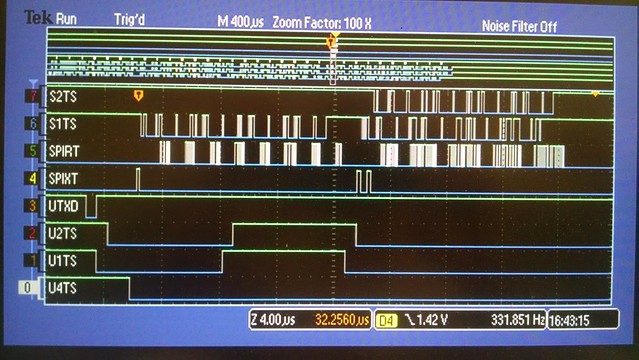

Looks like I may need to expand the RIOT-OS spi API to include ASYNC transfer modes. The current API makes it very hard to use the chips 16 deep FIFO because there it's no provision for receiver callbacks, only waits for a received data after the transmit. I've modified the SPI driver to detect NULL receive buffers for sending data to things a DAC using the transmit FIFO only but it should be possible to have a general ASYNC mode driver at the core of regular send/receive transfers.
S1TS and S2TS are the spi transmit outputs without FIFO support. SPIRT show the toggles for each spi receive transaction in response to each UART byte receive interrupt duration shown by URXD.
Everything looks nice, synchronous and slow.
Here we have the same data-stream but with the SPI FIFO's enabled. (NULL as the receive buffer address to the modified spi driver)
The data rate is faster (uart retransmissions and spi sends) because we don't wait for synchronous data transfer but without a proper receive callback system this can't be used for bidirectional transfers
unless we use a receiver interrupt callback like the uart driver does.
The Linux SPI system is much too complex (I've written drivers for it) for this simple rtos but a spi_async driver (with synchronous wrappers) should be possible without too much trouble.
http://www.hep.by/gnu/kernel/device-drivers/spi.html

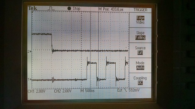

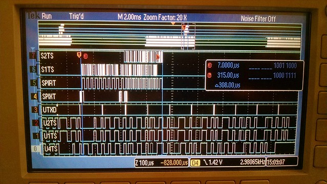

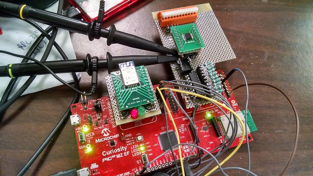

Got the first version of the async SPI engine running for the radio module on the board.
SPI #1 (two 18 byte blocks) and #2 (one 18 byte block) transmit with the sync transfer wrapper on the test functions. 438us
spi_transfer_bytes
The same as above but with the SPI #1 second block using async transfers. Non-blocking transfers automatically run
in parallel saving processing time in the main task using interrupts, the 16 byte deep fifo and asynchronous completion flags
in the driver. 308us
spi_transfer_bytes_async
SPI receive ISR processing time per byte interrupt from the fifo buffer, first edge to last edge, minus about 10 ns per toggle for debug pin operations.

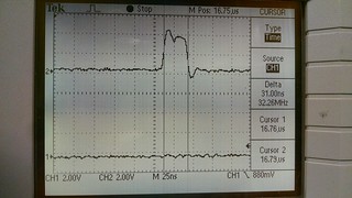

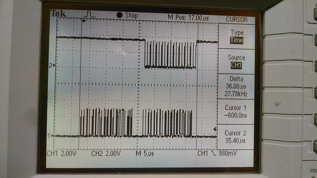

https://raw.githubusercontent.com/nsaspook/RIOT/PIC32MZEF/cpu/mips_pic32_common/periph/spi.c

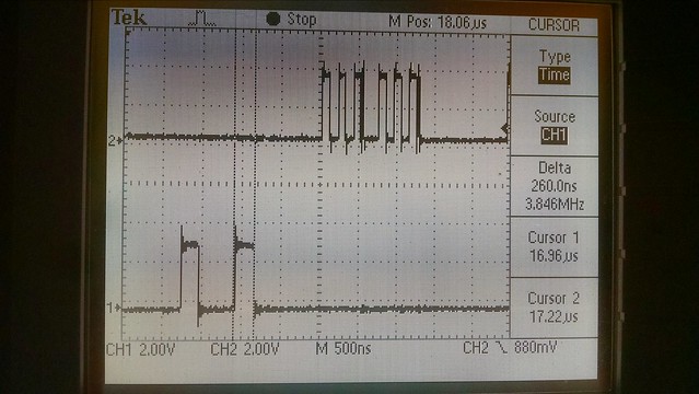

The cpu driven SPI tx/rx works pretty well up to about a 1MHz clock but at higher transfers rates even the pic32mzef starts to slow down. So the final part of the driver is the DMA engine. Here we've only enabled transmit DMA to make a cpu usage tx/rx comparison using a 10MHz sck with three 18 byte blocks on spi 1&2.
1. Cpu usage (SPIXT) during data transmit. 2. Cpu usage (SPIRT) during receive.
Data stream trace, there are times when almost all the cpu is needed to receive the SPI data stream
when both spi channels are transmitting.
traces
1. Cpu time (260ns per block) to transmit 2 18 complete byte blocks on spi channels 1&2. The DMA controller is moving the data from the output buffer uncached memory to the SPIxBUF register in background.
2. Cpu time to receive 2 bytes each of the transmitted blocks on spi channels 1&2.

Once the receive DMA is enabled we're ready to fly.
Full DMA (four channels) send and receive on spi channels 1 and 2.
Home shop test rig.
Nanoseconds of cpu time to transmit and receive the three 18 byte test streams a 10MHz. :joyful:
SPI ports 1 and 2 data.

Things seem to be working well so far. Starting a port of a pic24 BLE application that talks to a Android app to the OS port using one of the mikro BUS socket for a RN4020 BLE2 click board.
Need to finish a rewrite of the original PIC24 UART routines to be compatible with RIOT-OS for complete transfers of of board data but it pairs and displays the basic device characteristic information.
RN4020 test interface code.
https://github.com/nsaspook/RIOT/tree/PIC32MZEF/examples/rn4020_riot/test.X
Still coding up the OS port with general hardware timers and interrupt hardware handlers and rewriting the BLE application to use more riot-os general services. This has the expected side-effect of deoptimizing the application to a specific processor but generalizing the hardware interface for use on a generic riot-os based machine.
MCP3208 (8 12-bit channels) and ADS1220 (4 24-bit channels single/diff unipolar/bipolar inputs) ADC interface vector board in a mikro socket for
driver development with a RN4020 BLE modules on another vector board socket.
I'm mainly using the ADS1220 temp sensor and my hot finger to simulate heartbeat changes in an Android app until a DIY body sensor
is made for the 24-bit adc.
SPI signals (logic and analog traces) to the ADS1220 @2MHz clock with 47ohm spi damping resistors in series with the CPU MOSI/MISO lines on the vector board.
