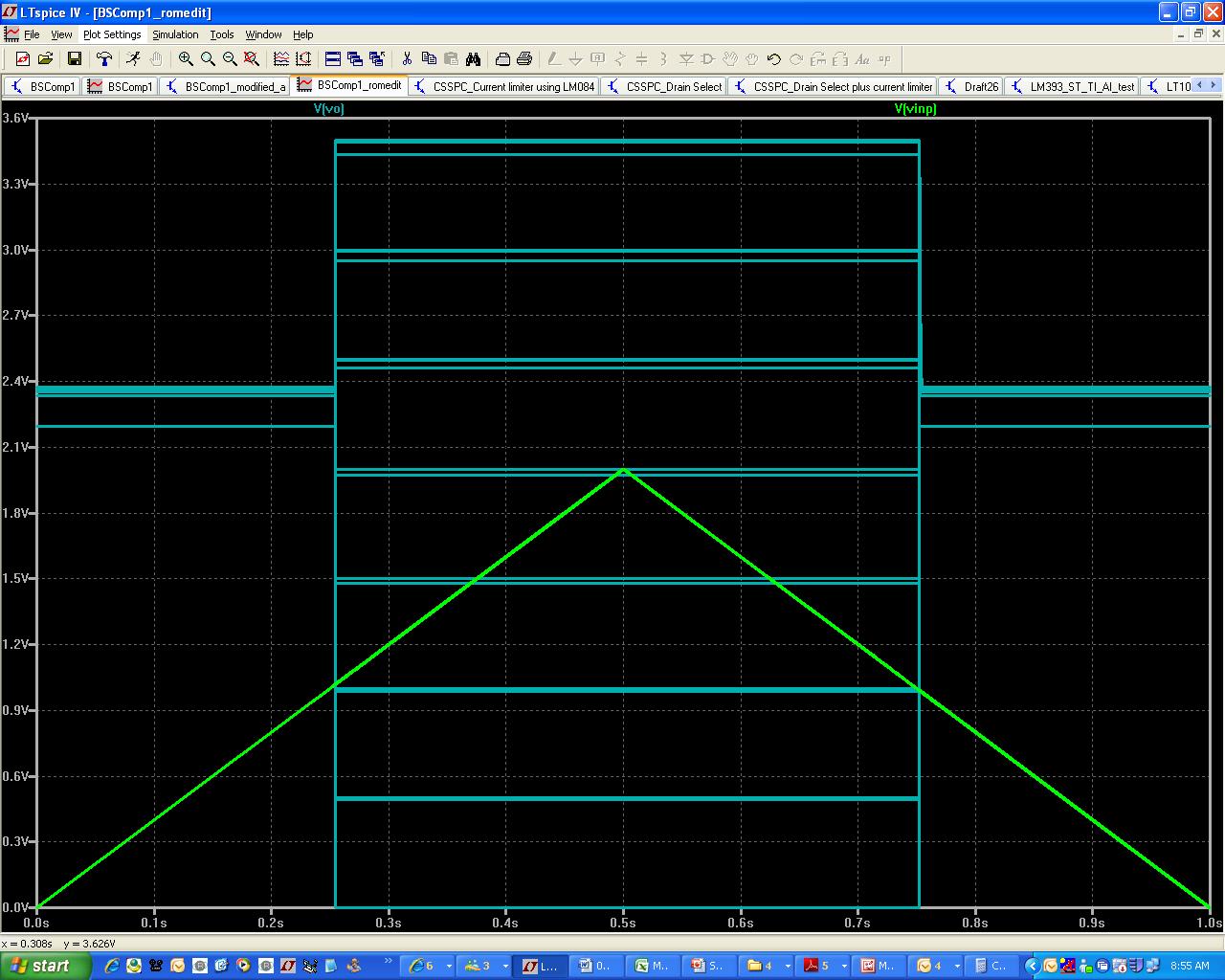

1 remaining question: for the VVAsource (0 to 3.5v), it seems Q2 is on its active region where we needed around 6V to output 3.5V. my challenge here is that i would like to my load to at least follow the voltage at the VVAsource. How about using FET switch for Q2? any new idea?
Hi Eric,
Finally, i have a working circuit which address my key issue above: VVAsource should be directly connected to the VVAload.
I made 2 key revisions from your initial design:
1. R4 is connected to the ground since the 2.2V drive simply works in this condition.
2. I operated Q2 into saturation or a Switch. This is to make my Variable Source directly connected to my load. Instead of Q2's supply tied to the VVA source, i tied it to the 5V source. This would saturate Q2 with its Vbe and Vbc > 0.7.
Do you have any technical objections or probably issue i have with this modifications?
See attachments of the schematic and the voltage output plot with VVA sweep from 0 to 3.5V.
