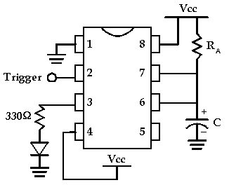

Also, tried schematic below which gives 2sec long output pulse when power applied (if pin#2 connected to Vcc) but again have to wait forever to discharge cap.

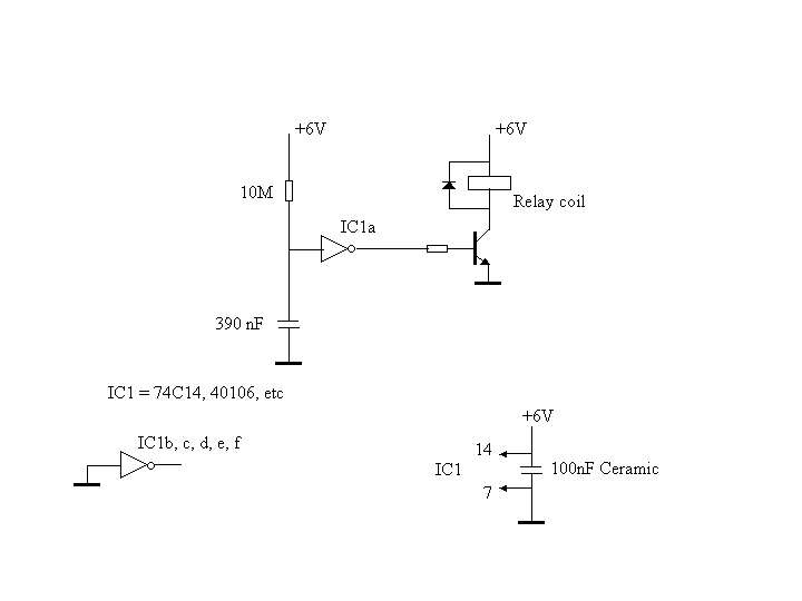

As requested by PM, here is a circuit for you. This assumes that the relay will operate on 6 Volt. If, not, check the relay data and alter the supply voltage to suit.
The IC pin connections can be found on the internet. eg. try www.discovercircuits.com
Len

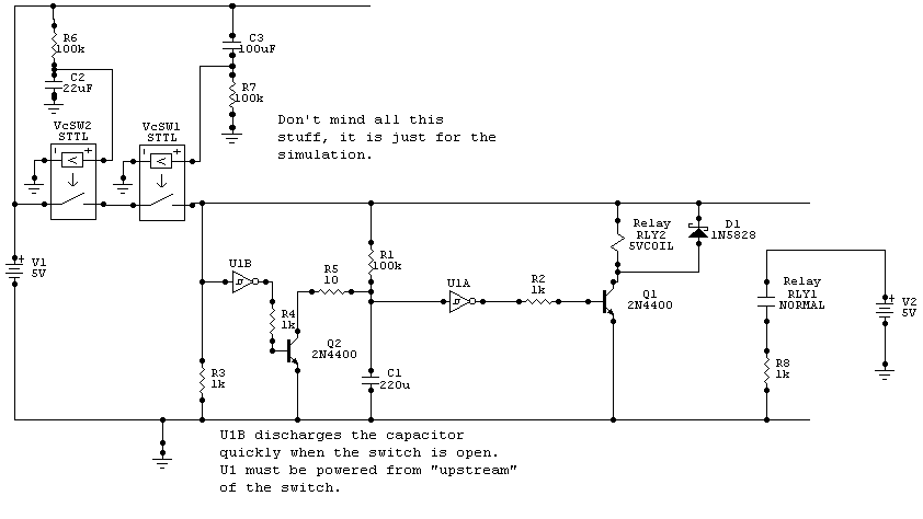

What to do with those extra gates? Use them to discharge that capacitor "right now." Note that the 74HC14 must be powered from "upsteam" of the switch in order to be in control.
j.
BTW, do you have CircuitMaker? It's easy and free for experimenting.
Wow, ljcox's circuit is a BomB! Because small cap needed, discharge time takes probably less then 1 sec., and ready to be used instantly every time after On/Off power cycle. Also it appears to be physically smaller due to very small 0,39uf cap dimensions. John Sorensen, thank you for your schematic, looks very cool!!! but I think its overkill in my case. Also, just downloaded CircuitMaker and will try learn how to use it properly before 30 days trial expiration.
Not to knock other's suggestions, the problem with large resistances in circuits like this is 1) the current into the the NOT gate is non negligible and 2) the high impedences can make the circuit susceptible to EMI/RFI/finger touches. Probably will work fine, though.
fwiw,
j.

Maybe you right, circuit provided by ljcox is not a perfect design from point of view very picky hardware engineer…I don’t know But it works under test for the second day and went through few thousands of Off/On cycles without single failure. Transistor version failure rating was like 30% if switch activated several times within very short period of time.

I disagree with points 1 & 2. The data sheet for the 74C14 CMOS Schmitt Trigger states that input current is about 5 nA at 15 Volt.
This means an error of about 50 mV which is negligible, particularily in view of the wide tolerances of CMOS Schmitt Trigger threshold levels.
On point 2, the impedance at the input to the Schmitt is relatively low due to the capacitor to gnd. So EMI/RFI should not be a problem. Finger touches would alter the timing though, but that is not serious issue in practice.
However, I agree that it is not an ideal timer and this circuit should only be used in non critical applications. I used one to provide a 3 minute delay in my garage door opener circuit to control the light. It has been working successfully for several years. The delay is only approximate, but it is not critical.
Len
But the datasheet I am looking at says input current to the gate can be as high as 100nA, which is not negligible across a 10Meg resistor in a 5V circuit, so obviously it can vary from part to part.
As for the second point, I was merely mentioning that a stiff circuit is generally better than a high impedence one, if you can spare the power and (in this case) the space. I agree that the cap adds an amount of filtering. A finger touch across a (say 1206) resistor can be (easily) an order or two less than the 10Meg.
I know we're not shooting for the text-book example of a timer, but I though it was worth mentioning.
fwiw,
j.
BTW, who said I was very picky?
John,
I don't know which data sheet you are lookingat, but I used the 74C14 which states 5 nA typical at 15 Volt.
The constructer can choose between a high resistor and accept the disadvantages you allude to, or use a larger capacitor (thus possibly an electrolytic) and proportionally smaller resistor.
Len
