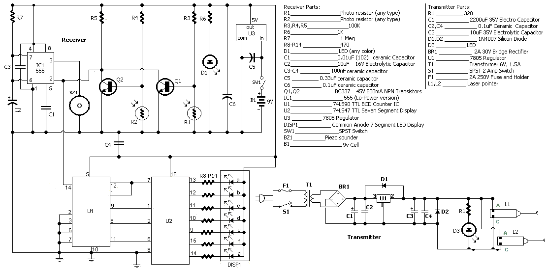

Please help modified a circuit
Thanks, I will test and write the results here :)
If somebody blocks the light from hitting a photo-transistor then the 555 will not time-out and the beeper will make a noise continuously.
Pin 14 of U1 should go to pin 3 of IC1, not pin 2.
Also, do you realise that if one LDR is in the dark, the 555 will not be triggered if the light changes on the other one.

We showed you a few weeks ago to use a series capacitor to couple a short pulse from the collectors of the transistors to pin 2 of the 555 to trigger it. Then if something blocks the light the buzzer will beep until the 555 times out.
Pin 14 of the 74LS90 counter needs to have a low-going pulse as its clock signal. The signal feeding pin 2 of the 555 is low-going.
Pin 3 of the 555 goes high when the 555 is triggered and goes low when it times out. If pin 3 of the 555 is connected to pin 14 of the counter then the count will advance when the 555 times out.

The number on the display will not disappear if you connect Pin 14 of U1 to Pin 3 of the 555.
As audioguru said, the number will increment at the end of the 555 pulse.
The signal at pin 2 is too slow to trigger the counter (unless there is an internal Schmitt Trigger in it)

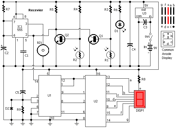

Hello again
I tested the circuit in breadboard
I am facing this problem
When connecting pin 14 of U1 to pin 2 of 555
the counter only shows zero and not changing also I found that the LDR should be in very dark place so the buzzer get activated
That’s why I decided to connect pin 14 of U1 to pin 3 of the 555
and the lDR is working fine and the sensitivity is perfect
but facing this problem
the counter starts from 0 zero and when the buzzer stop making sound
it shows 1 wow it counts
But here what will happen :(
when the buzzer activated again and stops the counter return to Zero !!!!
so it's like this
zero one zero one zero one
how can I make it counts zero one two three ....... and so on !!!
Please re-read this post by Audio.
The 555 needs a pulse to trigger it.

I cannot see any bypass capacitors. You need 100 nF ceramic capacitors across the 555 (pins 4 & 1) and the U1 pins 5 & 10. I think I told you this in a previous post.
I think the reason why the counter is going from 0 - 1 - 0 - 1, etc. is because of the lack of bypass capacitors and your reset circuit (C5, R9, D2). I suspect that spikes on the +5 Volt line (due to a lack of bypassing) are causing the counter to reset via C5.
The transistors are nearly overloaded by the very high input current of the old TTL counter IC. Then the gain of the transistors is very low.
When the input of the counter is removed from the outputs of the transistors then they are much more sensistive to reduced light from darkness coming.
Another reason to use a CD4026 Cmos counter IC. It has NO input current.

I used the bypassing capacitors in my breadboard us you said
and the problem is still
also I tried to remove the reset circuit (C5, R9, D2) and when the power on
I get 8 then after buzzer stop I get 9 then
8 ,9 ,8 ,9 ,8 ,9 like that
I am tired from this old TTL IC's but I can't find CD4026 in Oman
Connect the reset pins to ground then the counter will not reset and will count.
If the display number keeps changing then maybe the LDR is seeing a mains-powered flickering light and then maybe the counter is counting the flickering.
Then the 555 will also be triggered over and over.
Breadboards have loose connections and too much capacitance between wires for high speed TTL ICs. Use strip-board or a pcb.

I connected the reset pins to ground and it's true that it dosen't reset but it's also not counting only switching between two numbers
The output of the LDR and transistor might be to slow to clock a high-speed TTL counter. Then a Schmitt-trigger circuit is needed to feed the counter.
