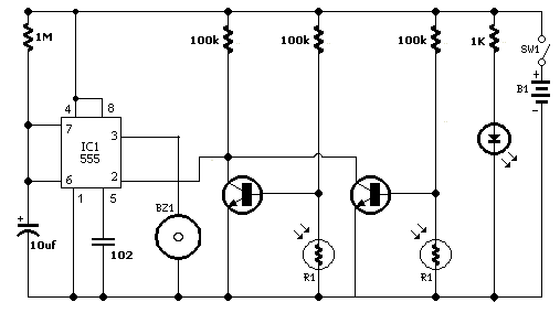

No the previose circuit gets timeout in dark the circuit works !!
by the way I added the capacior and the resistor like you said and the system is not working at all
I perefer to use the previose circuit
it has less parts
you know I will going to use 8 similer circuits with other circuits
total 16 circuits ;)
My last circuit doesn't work because it gets dark too slowly to make a pulse for the coupling capacitor into pin 2 on the 555. The two-transistors circuit is a Schmitt Trigger and its snap action will make a pulse for it to work.

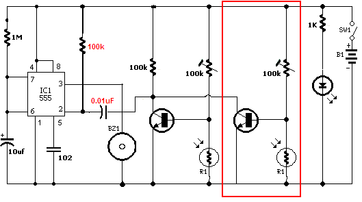

Is this the right way to connect the extra part ?!!!
Now you have two light detector circuits that have an output that is too slow to trigger the 555. They trigger the 555 only if it gets dark very quickly.
You need two Schmitt Trigger darkness detector circuits and an OR gate.

The transistor won't work. It gets dark very slowly. Then there isn't a pulse through the coupling capacitor to trigger the 555.
You need two of the Schmitt Trigger darkness detector circuits which have a snap action when the input is slow. The two circuits must be combined with an OR gate that feeds the coupling capacitor.

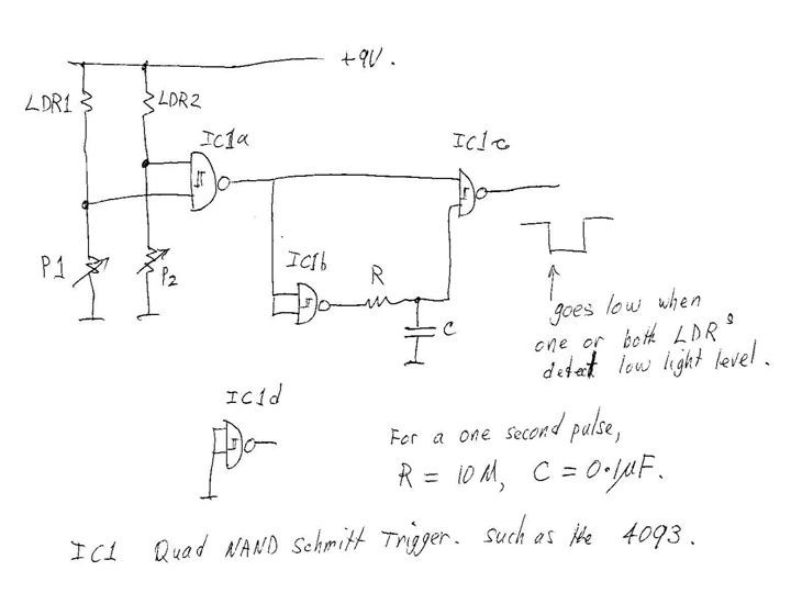

Here is how I would do it.
This circuit solves the issue about slow changes of light level since the IC is a Schmitt Trigger NAND and will trigger at a particular voltage level.

in the attachment I see 3 IC's
so if I apply this circuit it will cost me more then making another saprate circuit with other photoresistor
The new circuit uses 3 of the 4 gates inside a CD4093 IC. The unused 4th gate has its inputs connected to ground.

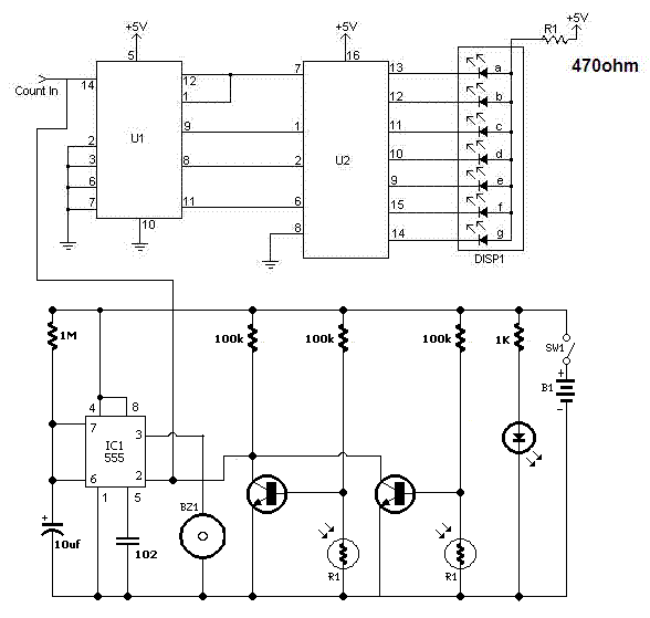

I want to integrate this (7 Segment LED Counter) to my circuit
https://www.aaroncake.net/circuits/counter.asp
I bought the components but you know lack in knowledge and lack in connections skill
I want that when the buzzer is activated it will send pulses to the new (7 Segment LED Counter) circuit then the number will appear then when the buzzer is activated again then it will add and the number will be 2 and so on just like counting system
The number should rest when the switch is close (power off)
I think its simple task but not easy for me
So help please in (the knowledge and connections)

I already bought the IC's shown in that site
please see if this connection attached will work or not
and by the way the circuit without the counter is working just fine
The 555 and transistors must be connected to the 5 Vol;t supply line.
You need a 100 nF capacitor connected between pins 5 & 10 of U1.
