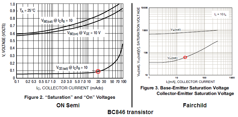

Here is how I would do it: The Sim shows the LED current and LED Vf as a function of the emitter resistor. This method draws less current from the port pin, and has a more constant current through the LED if the 5V supply changes than the circuit the OP posted.
The collector current is nearly the same as the emitter current. Since the transistor is operated as an emitter follower, it is not saturated, and the base current is tiny compared to the common-emitter configuration.

how can you know that Ic/Ib = 10 if your transistor is saturated?
The datasheet for nearly every transistor says that the base current must be 1/10th the collector current for the transistor to saturate properly. You calculate the currents and select the value of the base resistor that does it.
