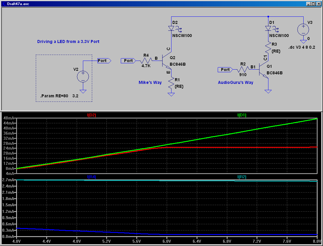

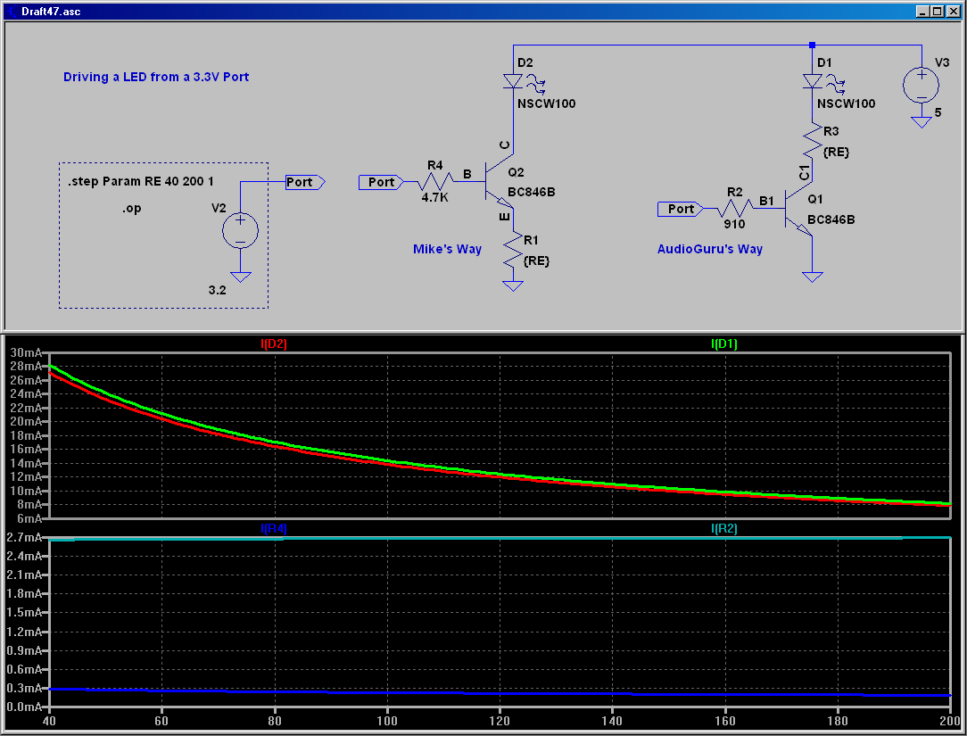

Please comment on my LED driver.
Here is how I would do it: The Sim shows the LED current and LED Vf as a function of the emitter resistor. This method draws less current from the port pin, and has a more constant current through the LED if the 5V supply changes than the circuit the OP posted.
The collector current is nearly the same as the emitter current. Since the transistor is operated as an emitter follower, it is not saturated, and the base current is tiny compared to the common-emitter configuration.

Not quite: I put the base resistor there on purpose. Look at the simulation below. Note that in my circuit, the transistor is not acting as a conventional emitter follower because its emitter voltage is much lower than it would be if it were not for the voltage drop across the LED.
The simulation shows a comparison of the LED current vs RE (the current determining resistor). Note that both circuits put essentially the same current I(D1) and I(D2) through the LEDs for 40Ω ≤ RE ≤ 200Ω.
Now look at the current through R2 and R4; note that AudioGuru's way loads the PIC Port a factor of 10 times higher than Mike's Way. For what benefit????
To see Mike's circuit act as a constant current sink for RE=80Ω (which makes the LED current 16mA), we would have to increase the supply voltage above 6V. The second sim shows the LED current as the LED supply sweeps from 4V to 8V. Note that above 6V, Mike's circuit keeps the LED current constant. Also notice that if the LED supply is operated at 6V or higher, you could leave out the base resistor, R4. If the circuit is going to be operated at less than 6V, then the base resistor is required.
