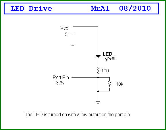

I think i see what you are trying to do now audioguru, i think you are trying to make a constant current source for the LED. That is interesting, but im not sure how good it would work out in practice with all the other possible variations. Maybe you should look at that too.
However, there is a much simpler implementation that can be used here anyway. Since the LED always drops at least some voltage even when it is drawing a very small current (LED curve) all we have to do is force it to draw at least some current at all times and we can drive it with a port zero '0' (low output) rather than a port one '1' (high).
To achieve this, we connect a 100 ohm resistor in series with the LED, and a 10k ohm resistor in parallel with the port pin. The 10k resistor goes from the port pin to ground however, while the LED and resistor go from Vcc (+5v) to the port pin. In this way the port pin is always shunted by 10k so the LED always conducts at least some current. The idea is to get the LED to be out or very dim with the 10k resistor, so this might mean raising it's value to 20k or maybe even as high as 100k. The limits are: we can not go too low on this value or the LED will look a little lit up even when it is supposed to be out, and we can not go too high on this value or the port pin might see more than the max input allowed (less than about 4v with a 3.3v supply).
With the 100 ohm resistor and a range of green LED voltages, the LED current would range from about 12ma to about 20ma, or the 100 ohm resistor could be dropped to get that range from around 15ma to 23ma which should be good enough.
This solution only requires two resistors and does not require any transistors (plus the LED of course).
Drawing...
Sorry.
I was thinking about another thread where the OP wanted to adjust the LED current by changing the base voltage of a constant-current transistor driver.

Hi again,
Oh ok too bad. Well, you could double check to see if the LED looks bright enough with 4ma i guess if you feel like it. Otherwise the circuit you have posted looks like it should work ok. You may end up raising the resistor to 75 ohms though. Try it out.
