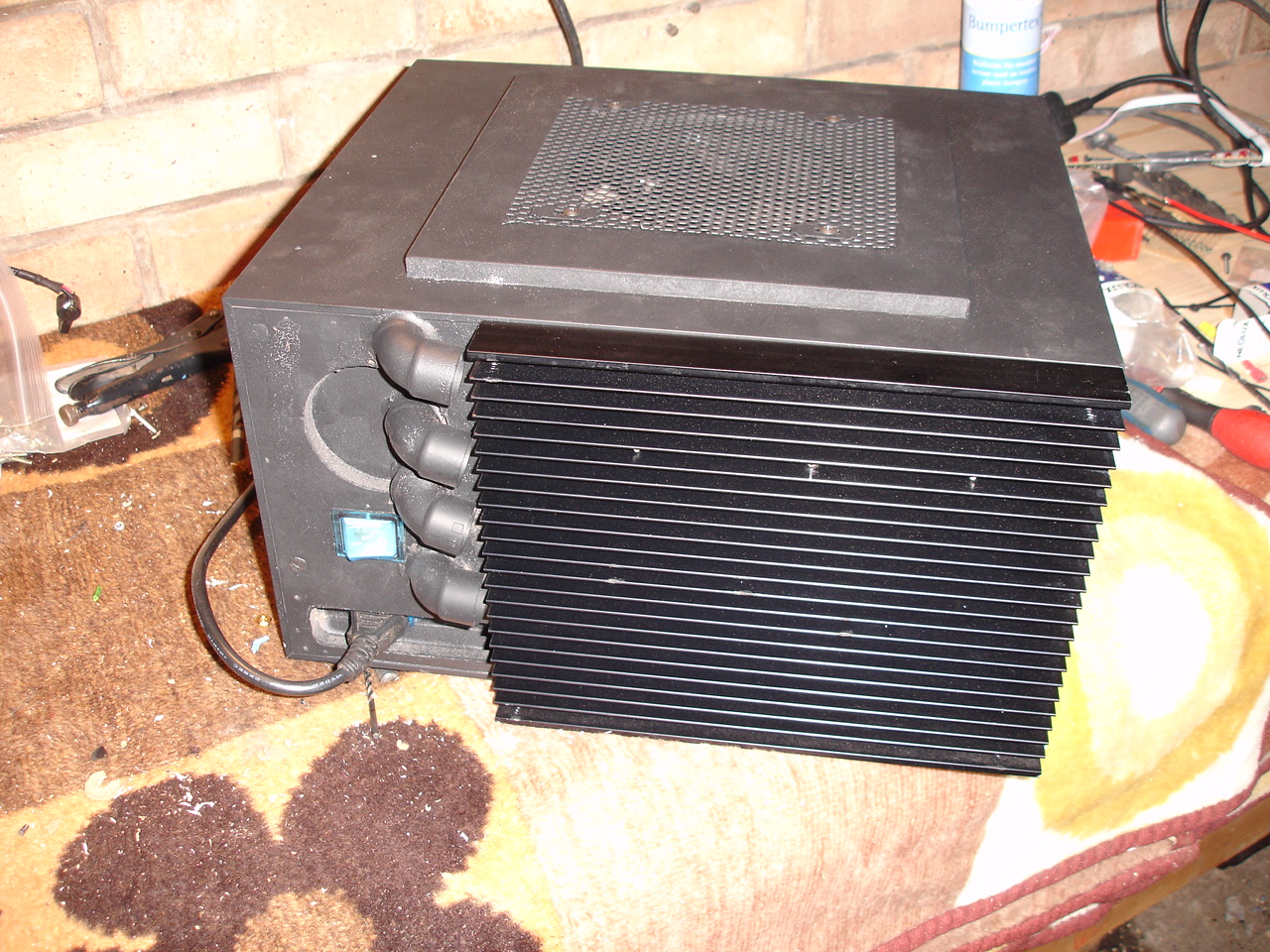

Hi all, the project is well on it's way( see pics). I have put a 140mm fan in the top which exits through the back and across the heat sink, just waiting for the digital volt and amp meters to come from China. I did as Bountyhunter sugested and fitted 6 LM338's to reduce load on them. This question is to Mr RB, I changed the potentiometer to a 100Ω and lowered the LM117 resistor to 100Ω as you suggested, but when I switch on with a 12v/55w halogen bulb connected across the outputs I am getting 1.91 amps@3v output across the bulb even with the pot set on its lowest, any ideas? would like it to turn lower because some parts I do are tiny. Only other change I made from original circuit is replaced current sense resistors from 0.24Ω to 0.22Ω as couldn't get 0.24Ω ones. Hope you can help with this problem.

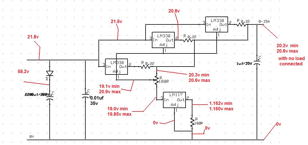

can you post a schematic with voltage readings at the pins for diagnosing problem?

I can't really diagnose it because it is not working correctly. The pot should linearly adjust the current.
Hi, I have done the voltage checks and attached a schematic with results. The min/max refers to current adj pot turned from low to high. The circuit i have made is the same just with another 3 LM338's tagged on. What can I connect across to test under load as I can't adjust it much with the 12v bulbs to test the voltages at load

The current control mechanism is based on 2 factors;
1. The LM117 is constant current drain so it always draws the same current through the pot. That makes a set voltage across the pot (end to end) regardless of the output voltage.
2. The pot adjustment makes a reference voltage which is subtracted from the current measured voltage on the current sense resistors.
So the LM338 always regulate to 1.2v, like this;
Pot = 1v, current sense R = 0.2v
Pot = 0.6v, current sense R = 0.6v
Pot = 0.2v, current sense R = 1v
So pot=0v = full current
pot >1.2v = no current
So to fully turn the anodising current off you need to set the pot voltage at >1.2v (from pot top to wiper). Just decrease the value of the LM117 resistor a little, say from 100 ohm to 82 ohm. That gives more current through the pot and a little higher pot voltage.
Now if you are doing small parts a lot and need fine adjustment, you could get a 10-turn wirewound pot. I have one on my main bench PSU and I love it.
Or, you can put a range switch in. That's a bit tricky, it involves changing LM117 R to 200 ohms, and adding another 100 ohm resistor above the pot. That would give you a range of zero current to half current instead of zero current to full current.
You can do range adjustment by switching out one or two of the LM338, but that leaves just one doing all the work, the other system is better.
If it was me I would definitely add a 10 amp analog panel meter, and I would probably change the 0.22 current resistors to 0.33 ohm, that will give you about 10.8A max instead of 15 which increases reliability and makes current adjustment finer. Later, if you really think you need 15A then you can add one or more LM338 which will be pretty easy job.

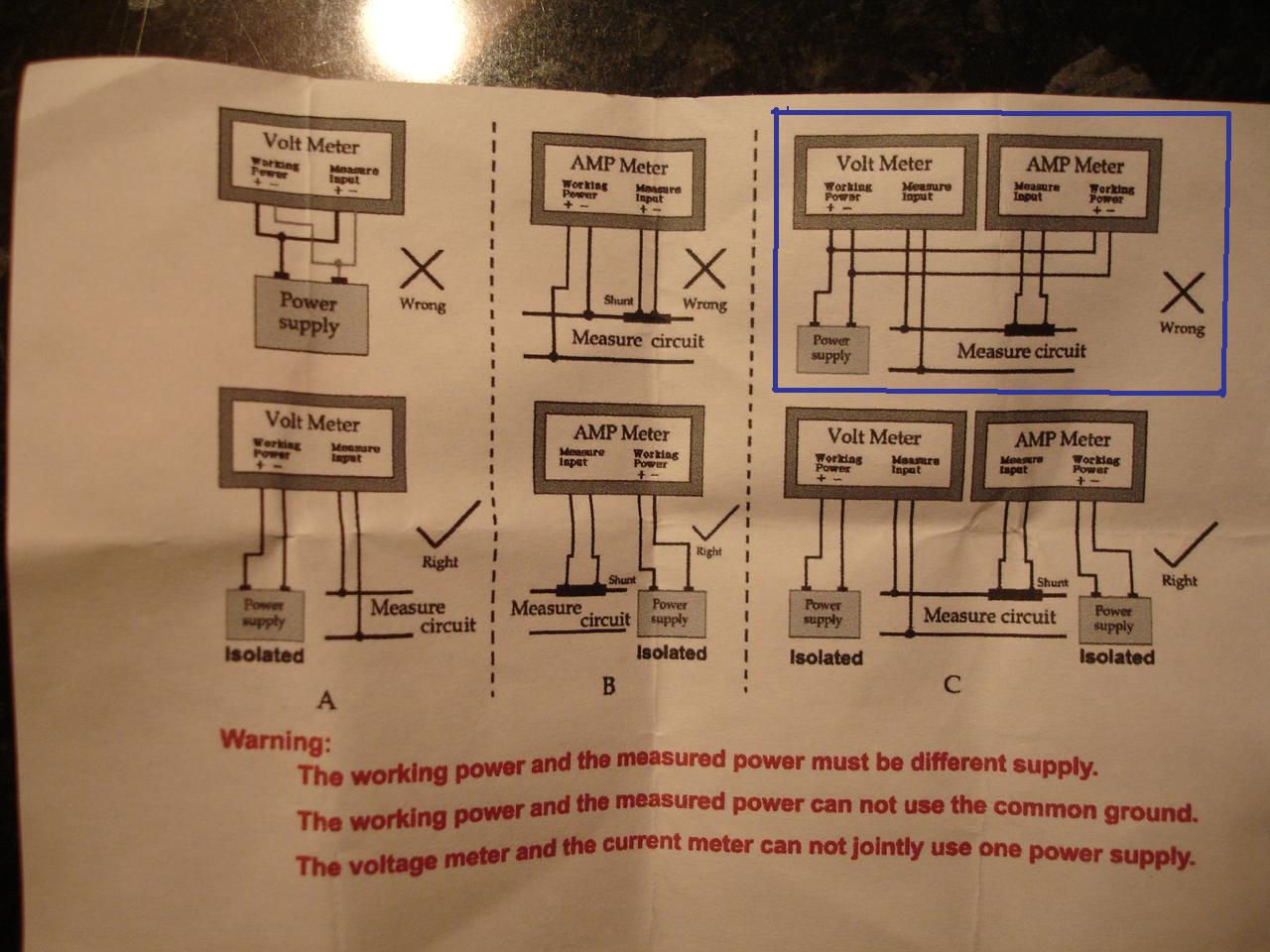

The digital volt and amp meters turned up but in the supplied paperwork it says they can't share the same power supply, why is this? I fitted an ATX power supply in the case to power both these meters. Is there any way I can use the ATX or do I have to fit another 12v source?. I have attached a picture of the paperwork and circled the way I was going to wire them in blue.
It looks like it's because the current meter will have a floating ground with respect to the voltmeter. In other words: the shunt resistor means the current meter's ground point is not system (power supply) ground which is the ground for the voltmeter. That means the power to the current meter must be isolated so it's ground can float with repect to system ground.
