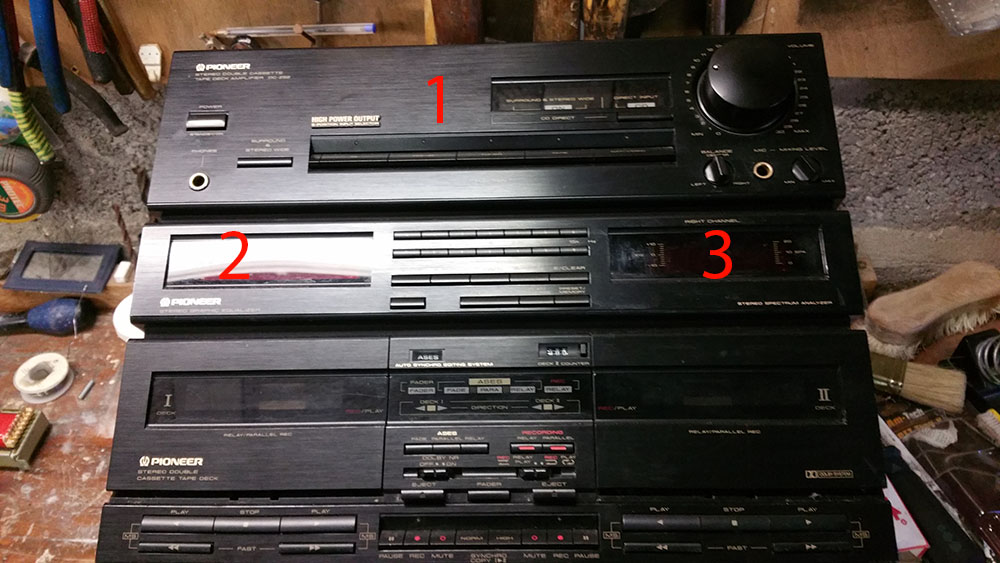

It thik there are two (Possibly more.) dispalys
3..........please refer to photo
I can see what looks like two bar graph displays on the schematic
Correct..........equalizer

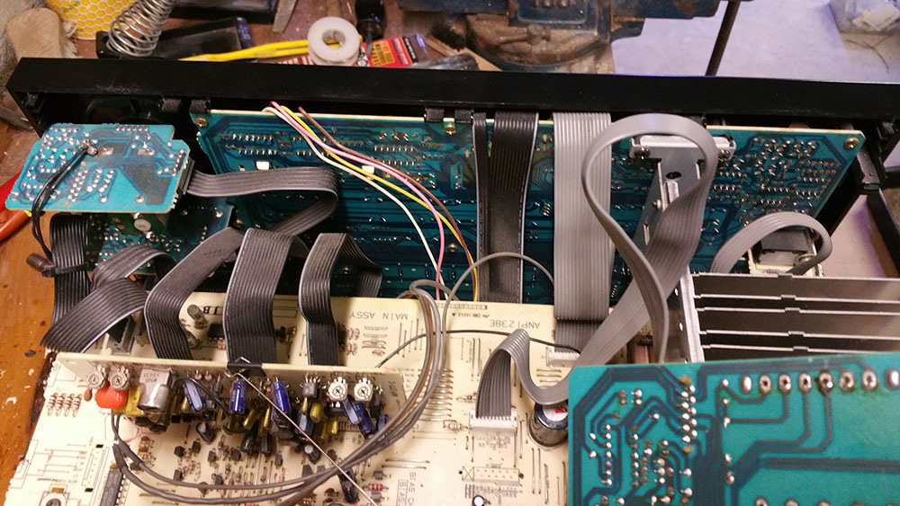

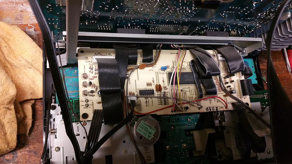

I suggest measuring directly across the filament pins on the dispalys
I have been and tried.............but I just do not know where to start.......It is a complex piece of kit with boards and wires everywhere. Cannot get to the displays.
Please see photos
