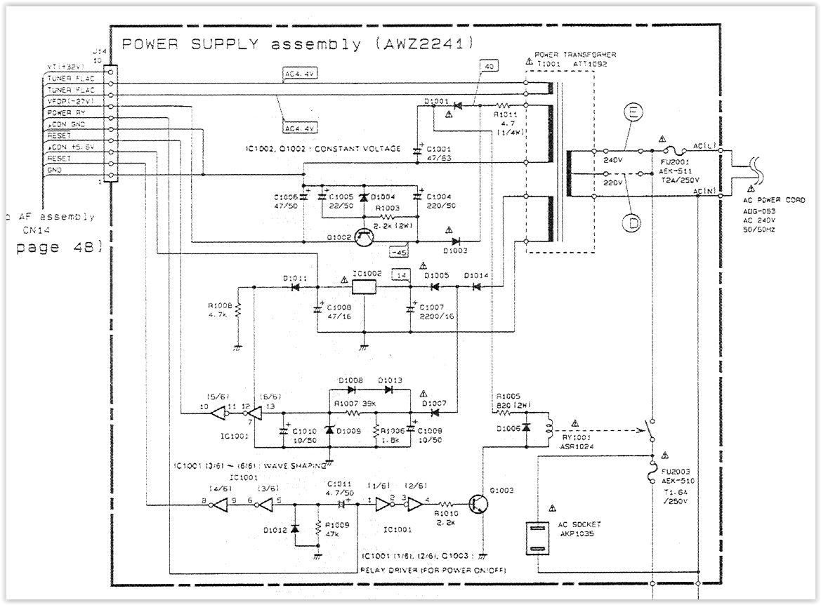

I have copied the schematic of the power board from your manual.
This is the part that shoul;d be most help. The top secondary winding is marked as 4.4 volts. The middle one will be about 24 to 27 volts and the bottom one will be about 6 volts.

I saw the 4.4v for myself, but I do not know how you have established the other 2 windings.
Also I don't know what VA I will need for replacement transformer or transformers ?
As this drawing above is only schematic............how do I establish which terminal on the board corresponds to which voltage ?
On the primary side of the transformer there are 5 pins and they are all connected to the board..............why would that be ?
John
Hi John,
The 6 volt winding is regulated down to 5.5 volts by a regulator with a number something like ???78M056 so I think this will be a 1 to 1.5 amp regulator to 5.6 volts output. It would require about 8 volts DC input so 6 volts ac when rectified and smoothed would provide this. The winding providing the 27 volts DC is estimated by the same method. I suspect this will be at a fairly small current as the first smoothing capacitor is only 220 uF (I would guess 200 mA max.) The thing that concerns me is that I think the 4.4 volts AC will be feeding the filaments of the fluorescent display and this voltage would have been higher that this while the mains was high so it is posible the display could have been destroyed. I have just had a thought about the transformer. Some transformers are protected by a thermal fuse whick may be under the insulation tape on the windings. I will have a closer look at the pictures. Identifying the pins on the transformer should be easy by looking at the etch side of the board and seening which components they connect to.
Les.

Look like the top transformer is:
(1) Primary: 240V RMS
(2) Secondary #1: 4V RMS
(3) Secondary #2: 32V RMS
(4) Secondary #3: 12V RMS
spec
If the primary of the top transformer has gone open circuit, you could put 4V RMS from another source (transformer), across the 4V terminals and measure the other seondary voltages.

I think you are right. I was reading those numbers as test point numbers rather than voltages. I was planning to read through the text to find what voltages were on them. I was just about to suggest what spec had suggested in post #10 but then noticed his post.
John, if you remove the transformer from the board it may be worth looking closely at the transformer to see if there is any lump in the insulation tape round the winding that could be a thermal fuse.
Les.

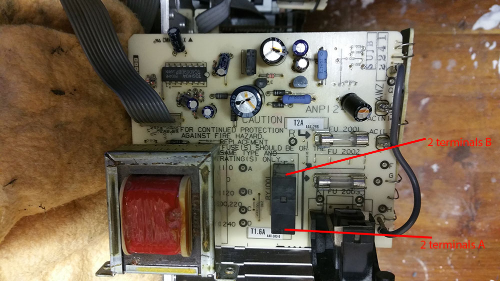

I have been and had a look.............and yes there is another transformer..............looks like that is blown as well.
Please refer to attached photos.
Terminals B is power in side (fuse-side) and there is no continuity on x10K ohms
Terminals A looks like the 12v output side..........and there is continuity
So probably this transformer is burnt out as well ??

If there is room in the Hi Fi for an extra transformer then you could feed 12 volts AC into bottom winding (That supplies the 12 volts for the relay and 5 volts for the electronics.) If you try this disconnect the 4.4 volts output (For the display filaments) in case the voltages from the original transformer are different to the assumed values.
Les.

Hi John,
When you said that there was another transformer (In post #12) I thought that you were talking about a larger transformer than the ATT1092. (When I first read post #12 I thought you had inserted the wrong pictures by mistake as they show the ATT1092 tranformer.) Looking through the service manual I thought you were referring to item 2 on the exploded view on page 6 (As shown as 6 of 73 at the top of acrobat reader.)
What is the little black trnsformer you are talking about ?
Les.
Hello Les,
No, sorry................I was talking about the little voltage convertor........I have put terminals A and Terminals B in red on the photo.........it is that little black voltage convertor that I was talking about
The other larger transformer ATT1092 is also faulty on the primary.
If this is not clear, please just tell me, and I will try again.
It was Spec who said "Looks like there are two mains transformers"...........so I went looking for another one inline with the fuse...........and found the little black voltage convertor !
Many thanks
John
Hi John,
The black thing with A & B pointing to it is a relay. (I am assuming this controls the power to the main transformer.)
Les.
