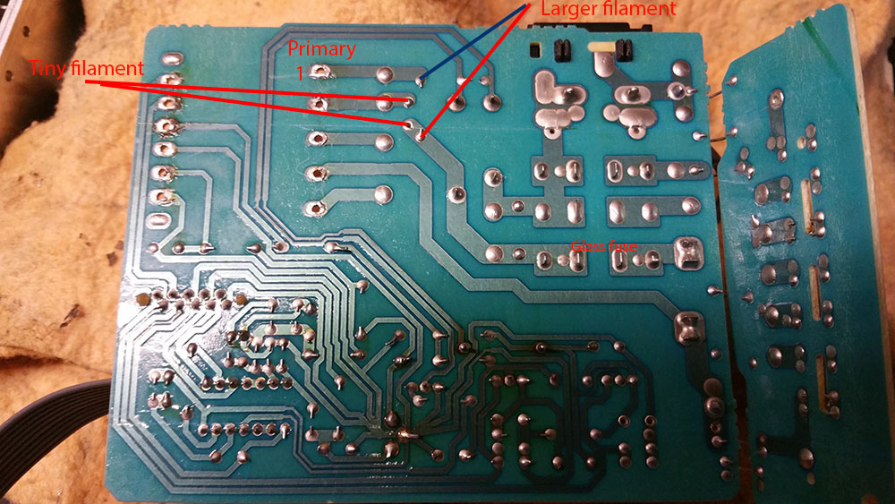

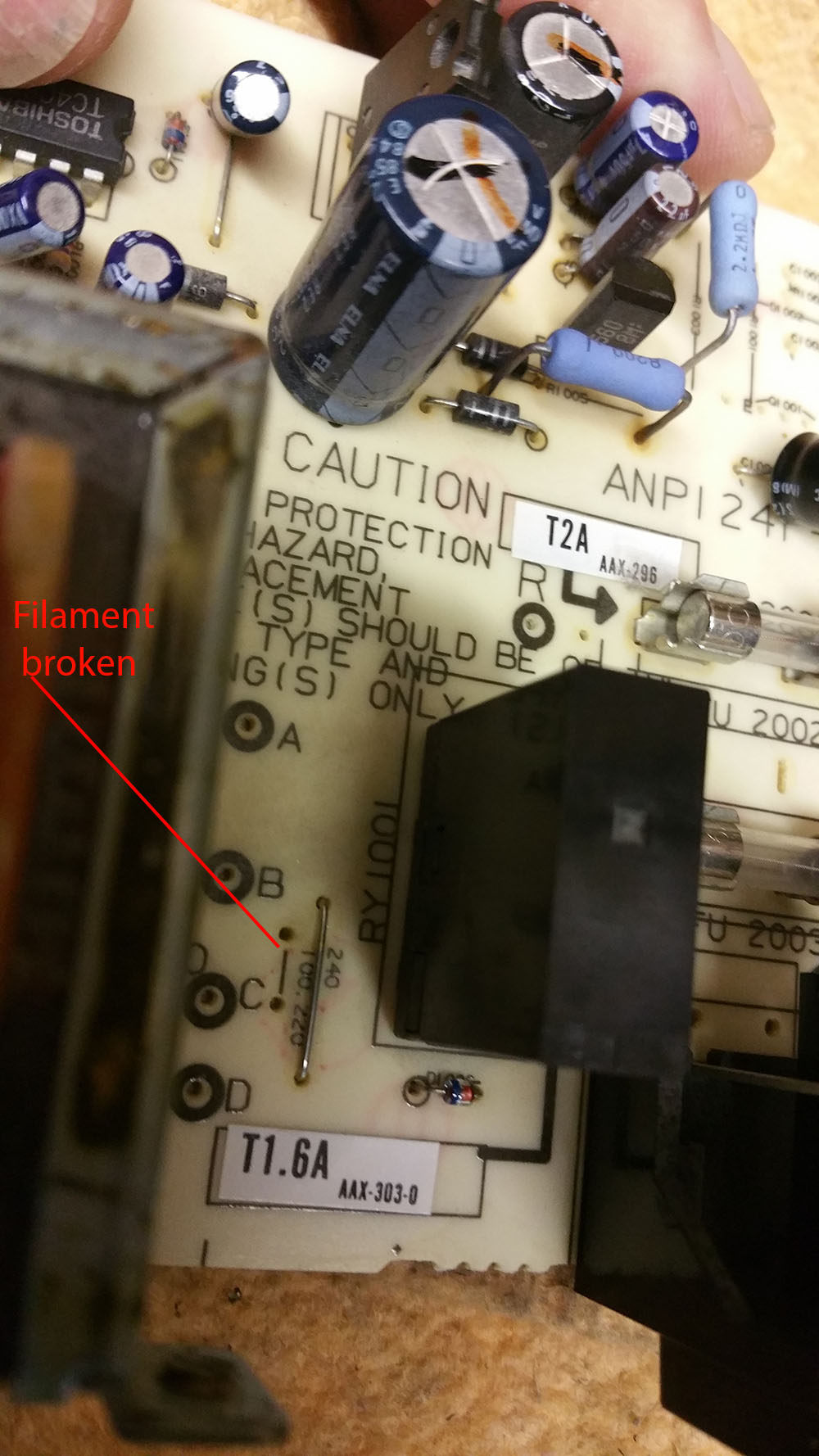

I have removed the transformer from the board, and while doing so have noticed that a filament (probably acting as a fuse) has burnt. It is a filament in line with the glass fuse with the power into terminal 2 on the primary. See photo.
The other larger filament (to the right of the broken filament ) is inline with the glass fuse and goes into terminal 1 on the primary. The larger filament is not burnt out.
Hope this makes sense !
So there is no connection to terminal 2 primary...........open circuit.

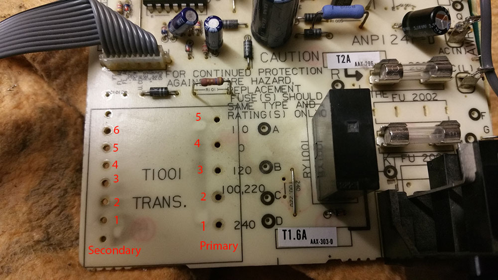

With the transformer removed from the board :
Primary: Terminals 1-2 = zero ohms
Primary: Terminals 2-4 = 20 ohms
Primary: tried all other combinations...........nothing, zero ohms.
Secondary: Terminals 1-2 = 15 ohms
Secondary: Terminals 3-4 = 50 ohms
Secondary: Terminals 5-6 = 20 ohms
ON THE BOARD ITSELF on the secondary terminals with the transformer removed:
Resistances everywhere except Terminals 1 & 2...........open circuit.

Thinking this through now that I have established that Terminal 1 and 2 cannot be the primary windings on the transformer.........could they be terminal 1 to terminal 4 (for 240 volts) OR terminal 2 to terminal 4 (for 220v).
I don't really understand this
It looks like the little filament which is broken saved the winding Terminal 2 to Terminal 4 on the primary.
However there is nothing (infinite ohms) between terminal 1 and 4.............the larger filament did not burn !
What are your views please ?

Hi John,
The things that you are calling filaments are wire links to set the unit for a mains voltage of either 220 or 240 volts. ONLY ONE OF THEM SHOULD BE INSERTED. As the resistance between 2 and 4 is 20 ohms (That is the 220 volt connections .) I would expect the resistance between 1 and 2 to be about 2 ohms. There would be 20 volts between these two points. (About 10% of the 220 volt part of the winding so about 10% of the resistance. It looks like the primary is not open circuit as we thought. Have you checked the fuse on that board ?
Les.
Hi Les,
Have just checked again.
On the transformer (off the circuit board) Primary Terminal 1 (240VAC) is open circuit with all terminals on the primary side.
On the transformer (off the circuit board) Primary Terminal 2 (220VAC) with Terminal 4 (0vAC) has a resistance of 20 ohms.
Now on the circuit board (with the transformer removed)............... there is a resistance of about 10 ohms because of the thicker wire link.
