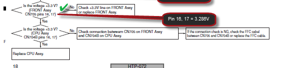

I have a Pioneer VSX-324 AV receiver whose only problem is the power button.
Schematic of the receiver: https://www.manualslib.com/manual/1027739/Pioneer-Htp-072.html?page=1#manual)
The problem I'm having is that when I use the remote to turn on the receiver, I just hear a click, but it doesn't turn on.
The only way to turn it on is to hold down the button for 2-3 seconds and it turns on without any further problem.
Holding the buttons down, I hear the clicks every fraction of a second, about 3-5 clicks. Then it turns on.
This problem started one day when I wanted to activate the receiver and TV using the remote control.
As far as I know, I've never had a power cut or power surge, nor a cable change. I have no other problems, such as sound quality or anything else.
I'm thinking that the problem may come from the button connection himself or maybe in that part of the circuit.
Do you have any ideas on how I should start looking for this problem?

Well well well. What did I just find?
If I disconnect the CP2200 cable from the D-Main ASSY card, I can use my remote control normally without any problem.
The problem may therefore lie with this card. The cable looks OK after testing it.
Now I need to find the real problem. I think it might be one of the jacks, because I think that for one of them, I had a problem with the sounds while the picture was correct. But not sure yet if this would be the cause.
I don't get 12V on pins 1, 2 and 3. On the resistor, I get 12V with the tester. So now I'm wondering if it's the C292 capacitor that could be faulty in some way.
But i still also think that one of the HDMI jacks could be the cause also, and who knows if the IC chip EP9442 could also be impacted.

CB2021 & 2022 are shown as inductors, so fit with being ferrite beads. 2022 is a direct link to VSS (0V), and 2021 is in VDD.
Those and the two caps are interference filters in the power connections, to reduce radiated noise, by the look of it.
