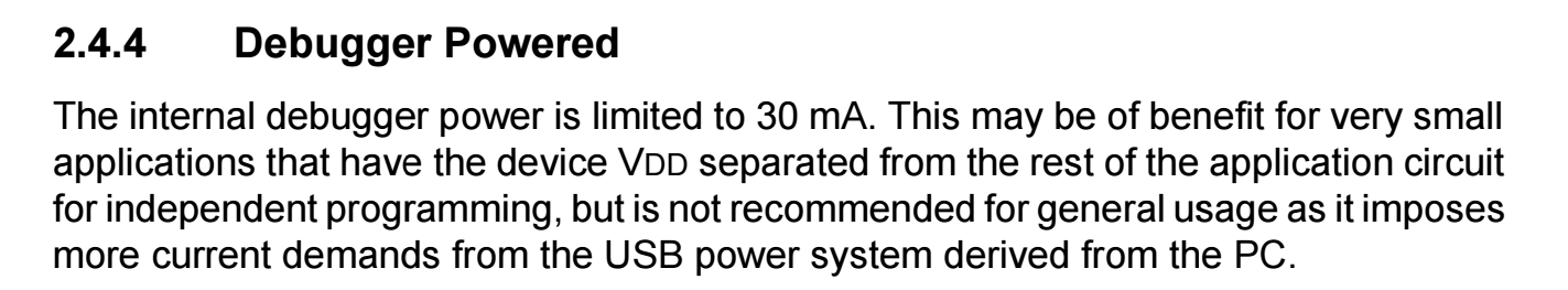

Regarding power, here is what the PICkit 3 documentation says. The PICkit 3 can supply 30mA, compared to 100mA for the '2.
