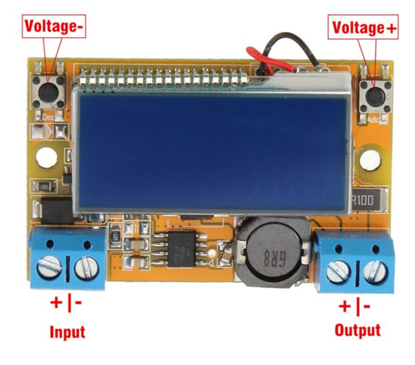

    I recently bought some....call them utility power supply modules...from Banggood. They are switching buck regulators that will handle up 23 volts DC input, and supply an adjustable output voltage at up to 3 amps between 0 and almost the supply voltage. The output voltage and current are shown on a bright clear LED. Connect a wall wart of between 12 - 23 volts and you have a handy way of powering circuits when the PICKLkit 3 is being picky :)
    These power supply regulators are US$25....for 5! It's just kind of amazing some of the stuff coming out of China. There is a simple calibration step to adjust the voltage readout. After this is done, the levels indicated are accurate.
