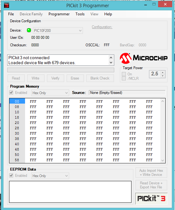

Ok lets see I'm sitting here looking at it I set power on hit program and watch the thing turn off and tell me to make sure my chip is set right and then the program window tells me I no longer have a chip hooked to the pickit 3.
I then toggle the power setting and bang the power comes back on and I have a chip hooked up hit program and bang no power.
Hit read and it powers that works to read it hit program and power goes off. plus every time the power goes off it tells me to check the chip to see if its a 3.3 volt part

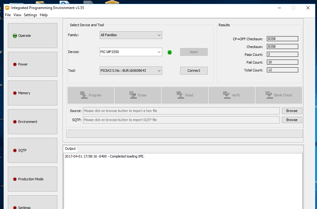

Why I haven't figured that out I changed chips to a 5 volt 18f2550 the IPE had no problem the app didn't work at all I'm about to think I got a bad programer Its a clone

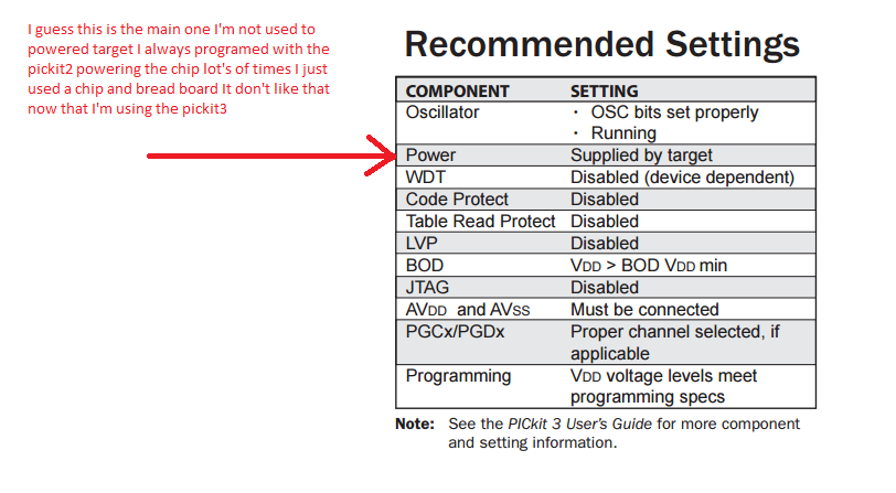

Well I received the pickit3 in the mail today and it says on the directions DO NOT USE PULL-UPS ON PGC/PGD.

I guess it's how I've been doing the pickit 2 always worked with a unpowered chip.
The pickit3 dosen't like that It works and JonSea your right the MPLAB is nothing like the app

You want use THE IPE that comes with MPLAB it let's you use the swordfish hex the easiest way
It's probably the best way to use the pickit3

I've had no problem programming if the chip is powered only if I'm using the pickit3 as power witch is what I always did with the pickit2.
The ipe works fine if you login and us it that way but that's kind of crazy to me but it works fine after doing so that lets you set setting for powering and stuff

I use the pickit3 to power the target, but only for simple boards that don't need much current. I normally don't have much more than 10uF of total C on the VDD line, if that much. The pickit2 can supply more current.

Use a board that has NO pull-ups on PGC/PGD. The tap-28 board has pull-ups that I need to disconnect.
All the boards that I have for my Mexi train have pull=ups but are battery powered so I guess I can't use the pickit3 on them either.

There is a exact replica of the old PK2 stand alone program for the pk3, how come no one seems to use it??
