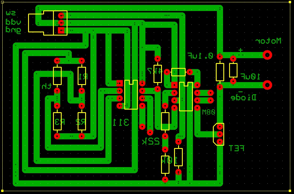

You fool (smile) if you look at your circuit design you are not even using pin 1 and 2 as inputs it is pin 3 and 4 you are using as inputs.
Output 2 goes to the fet.
You need to change your code to suit the pins used.
input pin4 goes to the switch
input pin3 goes to the 311
output pin 2 goes to the fet
Pin 0 is not used
pin 1 is not used
Also note you have pin3 pulled high and you have pin4 pulled low with resistors.
The right pins in the code might just solve your problem.
Pete.

I found out I may have put the FET (2n7000) the wrong way around where the drain was connected to ground so I have now changed that. I have 2 main problems
1. The chip does not do what the code says (unless I just say that the output is HIGH all the time or LOW all the time)
2. There is voltage across the motor terminals (around 2.8v) when the FET's base is 0 (no output voltage from the PIC)
For the time being, the motor wont actually start when the voltage is 2.8v (as it runs on 3-5v I think) so I can ignore that for now. I just want to make sure I have the PIC working according to the code and when that's done I can trouble shoot further.
If you guys help me check I have the circuitry for the PIC correctly set up I would be very grateful!
As for adding a pulldown all i do for things like that is to solder it to the bottom of the board, one of the advantages you will find with using wide tracks as you have done, is you can always drill a hole in the track to add a missed component later, no need to remake the board.
As i said send me your code so i can check there is nothing in the code that is causing the problem, as it could be causing the output to switch on and off at a fast rate and effectively PWM the motor and if so, yes you will only see a reduced voltage at the motor.
I see nothing wrong with the circuit.
Pete.

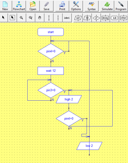

PS: I actually removed the 12s wait in the actual code as I just want to see it working first. The way I may do it is just use a flow chart in the PICAXE Editor as shown in the attached image.
Im not 100% sure on this but do feel your code should be layed out a little different, even though it might not show a syntax error i would advise it to be done this way.
A application should not follow the "then" on the same line unless it is a direct command like a goto, or gosub or the " : " is used in between.
Some syntax will work without fault and others will not when all included on the same line.
I also would add some pause statements for testing to slow down any strange operations so they may be detected.
