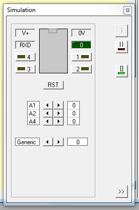

This should give you something to start off with that will be close to what you want, i tried to keep it simple so you can follow rather than do some fancy sort of code you might not understand
The reason it waits 1 second and then goes through the for/next loop 12 times is so the input pins can be checked each second rather than to wait for 12 seconds to detect any change.
The code was a lot simpler but i need to change it because if you had run the code in the simulator it filled the stack and gave an error, even though in real life it would not have mattered and worked fine.
This version runs fine in the simulator, give it a go and you should see how it functions, remember pin3 = 0 and pin4 =1 for it to enter into the 12 second counter to turn the motor on, if you change pin3 or pin4 while its counting the 12 seconds, it will abort and go back to main.
See how you go and report back with the results.

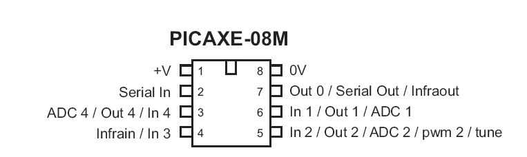

The 08m2 will work fine, if you have the latest version of "Programming Editor" 5.4.0 it will automatically convert code written for a 08m chip into compatable code for the 08m2 chip during a download to the chip.
NOW you see why i told you to add some pins to allow programming of the chip in circuit, it makes life much easier.
I often use a 3 header pins in the same style as the pins you have used for the switch to plug in on, it costs very little and takes almost no space on the board.
Once you make a addaptor cable from your serial cable to the 3 header pin socket you have it for ever more.
The other avantage with this is you can run "Debug" in your program and see all the values from the picaxe on screen while it is operating in circuit.

Heres a thought ........ solder a small wire on the bottom of the board from the broken pin 4 across to INPUT1 which is physical IC pin #6 and then we change the code to suit INPUT1 instead of the broken pin4.
This way you can still use the 08m chip.
In picaxe we speak in pin numbers as per the data sheet and the picaxe I/O numbering and NOT the physical IC pin numbers, as it just gets very confusing otherwise as might be the case above in your earlier post.
I will change the code back to 08M picaxe and move INPUT4 to INPUT1 but should this not be the correct pin4 you broke then the code will need further changes.

One of us is not correct here and i think it is you, as for starters the switch is connected to INPUT PIN4 and the 311 is connected to INPUT PIN3 not as you have listed above.
The switch is in pin3 of the chip, but in the editor pin3 is called "input 4"
pin1 = Input1 = V+, pin2= Input2 = RXD and then it shows the pin3=Input4 also it shows pin4 = Input3
If there is NO flame then the thermistor stays cold and the output of the 311 is Low, the 08M output is now Low and the motor is ON.
Ah your correct,
The thermistor's resistance decreases with temperature so its an NTC thermistor. When its hot, the thermistors resistance decreases until its around 5k (it was initially10k) which means that most of the voltage will be across the positive terminal causing the output of the 311 to go High...your right I was being stupid, we should program it so that when the 311's output is High AND the switch is ON the motor's ON.
Work from the diagram in the manual (in the PE help section under manual 1)
There is this diagram and when we talk code and pin numbers we use the numbers on the outside of the drawing and NOT the numbers inside the square.
Pete.
Pete.
Yeah I think we both agree! okay so what needs to be done it program the chip so when In4 and In3 are High , wait 12s and Out2 is High. else Out2 is Low.
By memory the LM-311 has an open collector output so with the thermister cold i would expect the LM-311 output to be off and pulled high via the pullup resistor and when the thermister gets hot the LM-311 output would go low as the transistor inside the LM-311 would be switched on.
This is opersite to what you have just stated so i think you need to test the output of the LM-311 with a multimeter to see if the output is high or low when the thermister is cold.
Measure between ground and the LM-311 output and see what voltage you read.
We need to know for sure how it is operating.
IE:- thermister cold = 311 output high
thermister hot = 311 output low
Pete.
