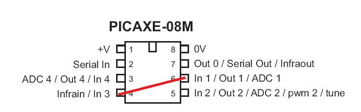

You are talking the wrong pin number again. Use the numbers on the outside of the drawing
What i was trying to get you to do was instead of the 08m using the broken pin which you said was pin3, is to get you to move what is conected to pin3 (the broken pin) to pin1 which is a input pin that is not being used.
Then the chip with the broken pin can still be used, and we just change the program to suit the new pin change.
Solder a small wire to the bottom of the board connecting the 2 pins like this in the image.
Then you will need this code with the pin changes made to it.
Well, I thought its pretty clear what we say if we say inputs/outputs we are talking about the numbers outside. If we say pins then its the numbers on the inside. I mean the pin numbers never change, the inputs/outputs do.
So in your picture, I would have said connect pin4 to pin6 or input4 to input1 (not pin1).
Anyway, I think its pretty clear what I have to do, so I will connect the wire as you said and test it.
Actually now that I think about it, I'l just wait for the new chips to arrive. It was dispatched today so should be here on Monday or something. I will then test out the code again :)
With every picaxe forum and discussion i have ever been involved with it is always reserved that the word PIN is only used to denote refference to a input or output pin, if you want to talk about the physical IC pin numbers than that is expressed as LEG 1, leg2 etc.
This solve a large confusion problem and we all know what is being reffered to.
The later model chips (M2 and X2 chips) use a bank letter (A, B, C) prior to the pin number which makes it easier to know what is being reffered to, but the earlier chips only used the number that was derived from the raw PIC used as labelled by microchip.
Pete.

Ah I see, alright. When the new PIC arrives I will just refer to it by A1, B1 etc
and the old ones by LEG 1, LEG 2 etc so we have no confusion :) (thanks for the info though!)
Finally! IT WORKSSS!!! I just tested everything with the motor and it all works as predicted! thank you SOOOOOO much for your help!!! I actually tried re-writing the code that you gave me just so that I can do it myself, but found the way you did it the most logical way ( as I wrote my code it just become more and more similar to yours lol).
