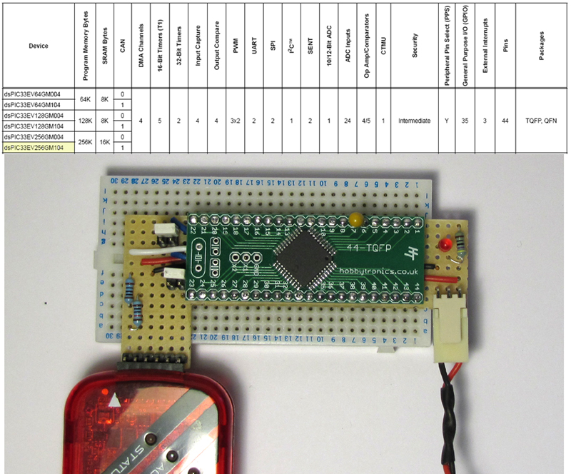

I have an MC 'Explorer ' still in its box , I found out there is no on board means of programming a pic you need a IDC or at least pickit3 , also the USB not what you imagine , I gave up with it at that point. now i put larger (44-100 pin) PIC24's on a breakout board or use dip versions , I think you should consider using the faster PIC24 or dsPIC33 chips 70 MIPS with up to 512 memory, there are also 5volt versions very useful.

Mike... I was lured by a discount for the explorer , even got a couple of pigtail boards from different supplier . I already had 2x PK3 and PK2 . but explorer data sheet (have a look ) suggested this was all i needed to program and debug up to PIC32, with usb, lcd etc etc.... not the case usb is conected to another pic onboard , lcd has problems with ADC , and needs a mod. easier to build my own dev bd ( and more fun) , PS have a look at PIC24 microstick , has prog and debug onboard and will plug into bread board...

Programming and development with explorer 16 cannot be done alone , asis you need PK3 , ICD or simlar. and possibly some daughter pigtail boards ( there is a small dev area ) I thought it was messy . Don't get me wrong I think PIC24 & dsPIC family are the best thing since sliced bread but I prefer the diy approach.
