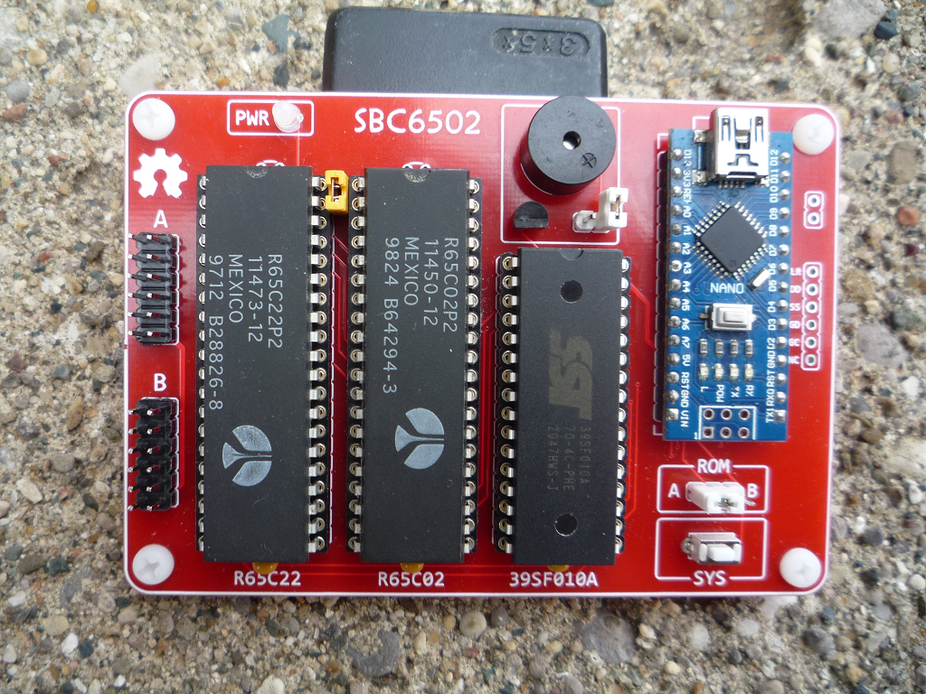

If you're interested... here's how the 65C02 prototype turned out;
Looks nice - but just weird having the far higher powered Nano sat there :D
I'd still like to make a 6502 board - but I just can't see the point, as a simple one chip PIC wipes the floor with it - I've also still got my original MicroTan 65 :D (and a Plus4).
I like the little beeper, is it a tone generator, or just a 'speaker', I've got a wide range of piezo's at work in my quest to find the loudest one :D
I purchased a handful of Nano clones several years ago for $1.75 each, including shipping, and more recently for about $3 each. At that price it's easy to justify sticking one on a retro project PCB for nothing more than the built-in USB-to-Serial adapter. However, you may have noticed I also use it to provide the CPU clock (1, 2, 4, or 8 MHz), an "econo reset" function, and as an in-circuit EEPROM or Flash ROM programmer. Nano clones can still be had for around $5 today.
I don't have an Apple II anymore and I'd like to run Nick Gammon's G-Pascal on this little board.
The piezo speaker is quite loud when you drive it at its 2000-Hz resonant frequency.
