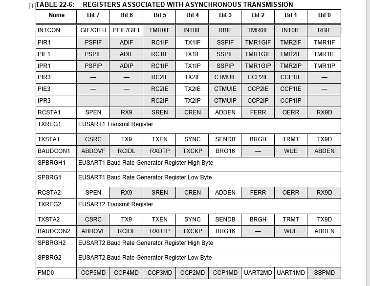

I have PIC18F45K80. I am using MPLABX 5.40 and XC8 2.30. I was reading the datasheet. I looked table that show required register for UART communication
1) my doubt, Does it means only timer0 will be used and other timer will not be used for UART serial communication ?
It says Timer1 will be used if you use asynchronous.
Edit, I don't recall any timers being used by the UARTs. I think the above is a typo.
given in datasheet If using interrupts, ensure that the GIE and PEIE bits (INTCON<7:6>) are set. Only Timer0 given in INTCON register and PIR1 doesn't show bit for timer 0
I am confused How to configure INTCON and PIR1 register for UART ASYNCHRONOUS TRANSMISSION ?

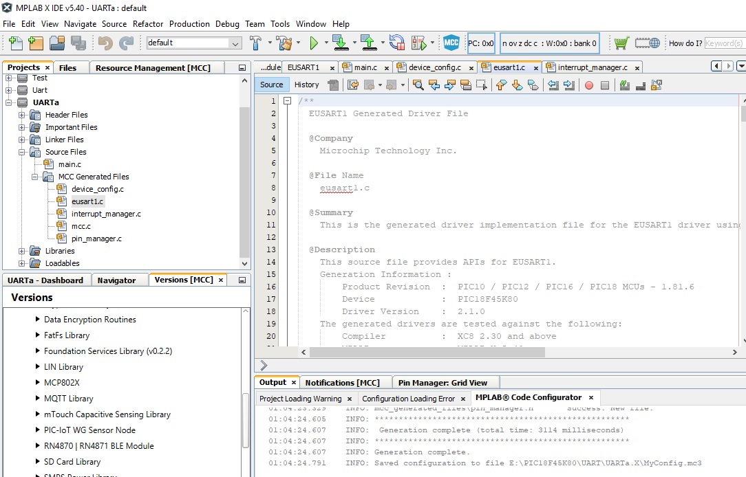

I am following link https://microchipdeveloper.com/mcu1101:project-12
I have reached up to step 10 but I don't get I don't get tmr1.c file
perhaps it may be eusart1.c file

Why do you expect to?, you're not using a timer, and you're not configuring it.
As Pommie said, the timer1 mentioned in the webpage appears to be a typo (presumably they cut and paste from a previous tutorial, and messed up).

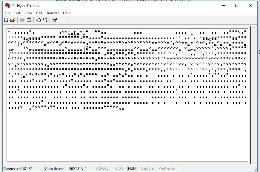

Here is my program when I run code I am getting garbage value on hyper terminal.
Hyper terminal settings
baud rate 9600
Data bit 8
parity none
stop bit 1
I can't see where you set OSCCON.
PIC is configured to use an internal RC oscillator
C:
#pragma config FOSC = INTIO2    // Oscillator (Internal RC oscillator)
#pragma config PLLCFG = OFF     // PLL x4 Enable bit (Disabled)
#pragma config FCMEN = OFF      // Fail-Safe Clock Monitor (Disabled)
#pragma config IESO = OFF       // Internal External Oscillator Switch Over Mode (Disabled)
Do i still need to configure OSCCON register ?
On the older pics the default was 32kHz but I just checked the datasheet for the one you're using and it defaults to 8MHz.
To be sure you're running at 8MHz, try blinking an LED at 1Hz.
Edit, you're also not waiting for the oscillator to become stable.
What do you mean by stability of an oscillator?
It can take a couple of milliseconds for a crystal oscillator to start up and become stable. There is a start-up timer in some PICs that can be enabled to prevent code from running for the first few milliseconds after start-up. Alternatively that can be done in code.
However, it won't make any difference here. If the first character were getting corrupted, then maybe look at start-up.
My suggestion would be to send one message per second as a test. You can time that against a stopwatch to check if the code is running at the speed that you expect. You also avoid any confusion of signals due to start-up or one instance of the message starting as soon as the last one has finished.
On that last point, if you are transmitting continuously (HelloWorldHelloWorldHelloWorldHelloWorld etc) the start and end of a message isn't easy to see, and we understand words and capital letters. Put it into hexadecimal and it's 48 65 6c 6c 6f 57 6f 72 6c 64. In binary with the start and stop bits it's
0 00010010 1 0 10100110 1 0 00110110 1 0 00110110 1 0 11110110 1 0 11101010 1 0 11110110 1 0 01001110 1 0 01110110 1 0 00100110 1
but without the spaces, which is what the voltage on the pin does, the start and stop bits just look like bits:-
0000100101010100110100011011010001101101011110110101110101010111101101001001110100111011010001001101
if that is just sent once, then the conditions before may not allow the receiver to see the start bit. If it is sent continually:-
0000100101010100110100011011010001101101011110110101110101010111101101001001110100111011010001001101000010010101010011010001101101000110110101111011010111010101011110110100100111010011101101000100110100001001010101001101000110110100011011010111101101011101010101111011010010011101001110110100010011010000100101010100110100011011010001101101011110110101110101010111101101001001110100111011010001001101000010010101010011010001101101000110110101111011010111010101011110110100100111010011101101000100110100001001010101001101000110110100011011010111101101011101010101111011010010011101001110110100010011010000100101010100110100011011010001101101011110110101110101010111101101001001110100111011010001001101
then it may be impossible for a receiver to work out where each character starts and stops.
If you send it with big periods of idle in between, the start becomes obvious:-
11111111111111111111111111111111111111111111111111111111111111111111111111111111111111111111111111111111111111111111111111111111111111111111111111111111111111111111111111111111111111111111111111111111111111111111111111111111111111111111111111111111111111111111111111111111111111111111111111111111111111111111111111111111111111111111111111111111111111111111111111111111111111111111111111111111111111111111111111111111111111111111111111111111111111111111111111111111111111111111111111111111111111111111111111111111111111111111111111111111111111111111111111111111111111111111100001001010101001101000110110100011011010111101101011101010101111011010010011101001110110100010011011111111111111111111111111111111111111111111111111111111111111111111111111111111111111111111111111111111111111111111111111111111111111111111111111111111111111111111111111111111111111111111111111111111111111111111111111111111111111111111111111111111111111111111111111111111111111111111111111111111111111111111111111111111111111111111111111111111111111111111111111111111111111111111111
because the data wire is high when idle, so it is like transmitting binary 1 continually.
The receiver can then start reading a character on the first transition from 1 to 0 and the data can be decoded.
Mike... That chip defaults to 8Mhz... BUT!! Serial transmission with the internal OSC needs tuning... The OSCTUNE register needs attention.. However!! You have selected high speed mode... Have you set the hyper terminal up to 9600 baud? Do as Mike say's (just in case) set the OSCCON to 8Mhz
I've never had a problem with RS232 and the internal oscillator. However, I always use two stop bits on the transmit end and one on receive end to prevent framing errors. Don't think that is the problem here and like Ian's suggestion of sending a string once per second to check timing.
