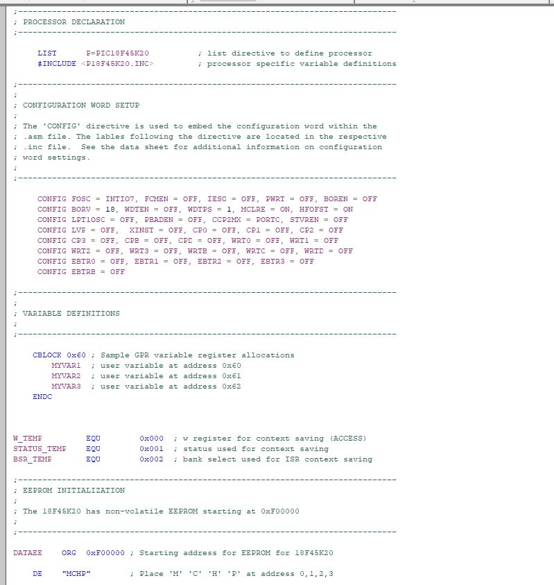

Also have a look at the Templates folder which gives the basics of how to set up the code.

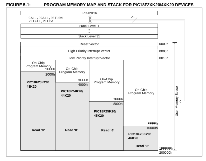

In the picture I see that the program memory is up to 3FFFh and the GPR starts from 4000h?
Where can it be used the memory?
Program memory and Data memory (RAM / registers etc.) are two totally separate areas with their own independent address maps.
Instructions that read or write RAM or registers etc. cannot access the program part, and the program instructions (code) is never read from the registers/RAM.
(It needs special indirect instructions to read data from program space, it cannot be done directly).
That's the "Harvard architecture" Nigel mentioned; very different from many other CPUs that treat program and data space the same.

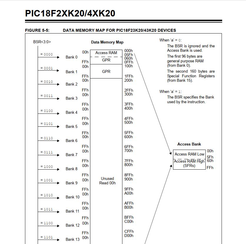

In the file register 000h-2FF is the data memory 768 bytes. From 300h in turn restricted. What does that mean?

For the Pic18 the Ram area can be quiet confusing.

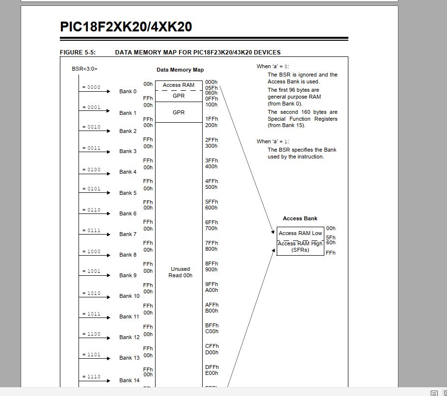

From the picture below you can see that you have two "banks" of Ram , Bank 0 or Bank 1, other similar chips may have many more Banks like 2 -8 etc.
To use Bank1 or above you need specify in your code that you want to use a particular Bank with the BSR.
However for Bank 0 you do not, its contents are always available to the system regardless of what other Bank you may be using, thats why Bank 0 is called the Access bank.
To confuse matters, the system needs some Ram for its Registers and they reside in part of both Bank 0 and Bank15, as shows in the pic below, and you must not use those areas in your code,
Where is says" Unused, Read as 00" , simply means there to is no Ram there to use.

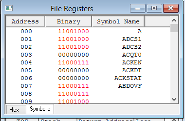

Now I understand the memory map. I still have so many questions that there are symbolic names next to the titles at the beginning of the file register. What does that mean?
I chose this PIC because there is a lot of it out there.
The assembly language is very sympathetic to me. I also programmed in C but the assembly is much more interesting. Although I'm still in trouble with math operations.
Hi!
You need to read the datasheet - it's all explained in there.
For a clue, many of those are bits in ADCON2.
