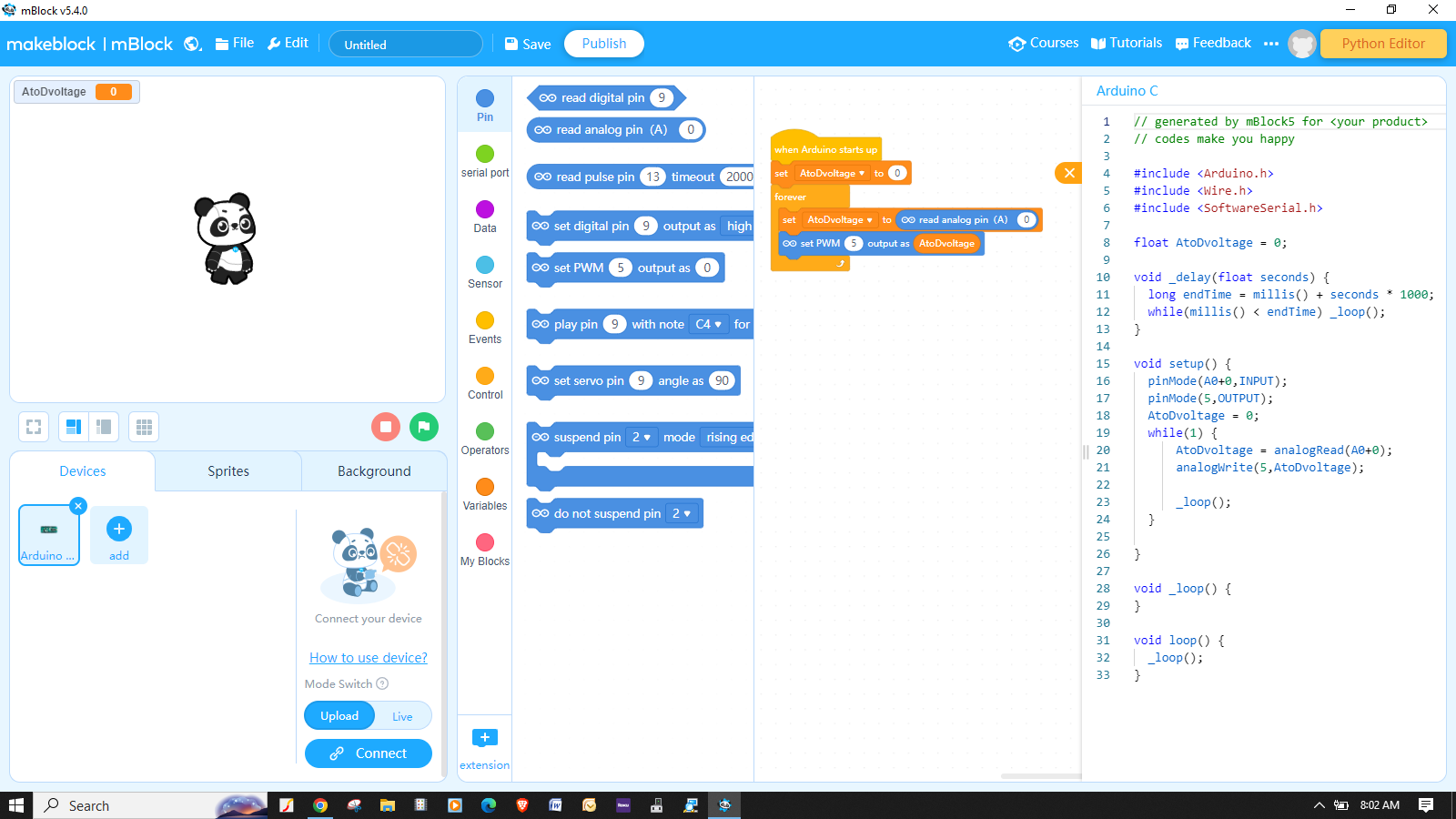

This is an aside on block based / visual programming.
There are a number of block programmers developed for folks that learn in visual fashion.
MIT with its Scratch, mBlock, Snap4arduino, Flowcode, Nodered, Visuino, Tuniot.....
Here is an example of what a simple voltage to pulse width converter looks like (just 5 blocks) :
You take blocks out of second window, place them in design area (3'rd window),
configure them, and then hit the connect button and mBlock generates C/C++
code and then uses the Arduino IDE programmer to program the target board/part.
The rightmost window is Arduino C/C++ code that mBlock generates from your block
configuration.
I am not advocating this as a way to learn C, rather an adjunct to easily program
simple designs and be able to look at what C/C++ code looks like. Its not optimal
code by any stretch but for simple one off projects fast to get something going.
