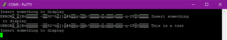

Hello everyone, Im playing with a PIC16F887 to practice my coding skills and I managed to connect it to my computer via UART. I made a simply code to
Send a text to my pc and then answer back anything inserted, then procced to show it back and confirm what i wrote. But im facing something weird when i do this because after the word is completed, next to it appears a chain of garbage chracters, i have tried to limit the array and set a null value to the last digit of the array to let it know that the word will end there. I dont know if you have give me a hand to succesfull enter any word of X characters and then show it back with no garbage in it. Excuse me if some part of my redaction doesnt make sense at some parts, Im not a native english speaker. thanks !
Info:
Compiler XC8
Config.h = are the config bits made into that file for quick working (PIC16F887 , using inner osc)
https://prntscr.com/j4lpsc (image of the test result)
Main code (for any reason i couldnt not use the insert code command, it just hangs and does nothing so i ll paste the code here.

Your char arrays don't have a length and when you write to them you don't write a terminating zero.
I also don't see how your UART_Write_Text() function ever writes anything but the first character or how it terminates (the pointer isn't incremented!). Or how your read function returns anything more than 1 character.

Thanks again for your time, right now im at the work, in about 12 hours i will go back to home and try the code, since i cant test it right now, the way you arranged it, it doesnt show garbage anymore ? and if not, whats the reason behind the garbage characters ?
I still have no idea how that code worked and suspect the pic was running earlier code.
The garbage characters are due to there not being a terminating zero on the strings.

As I promised, Im back home to test the code, thanks for your effort, here is the screen shot.
no more garbage... I have read about that Circular FIFO buffer, can you help me to build one, at least with [15] chars, or if you know a good source to read and try to understand first a little more.
