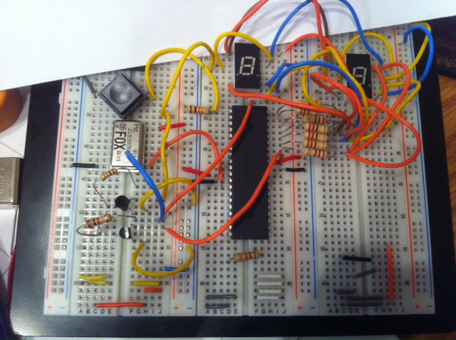

When I put it on my pic16f877a It wont count from 00-99. I have tried figuring out how to set up multiplexing and i thought it was in the program but i guess its a hardware issue, In that case do you happen to know a schematic? here is a parts list that i thought i could use to perform this my 2-digit seven segment display(HDSP-523G SERIES)common cathode
Parts List:
-Pic16f877a
-2x 2n3904 (NPN) transistors
-7x 330kohm resistors
-1xpushbutton
-3x1kohm resistor
I appreciate the help

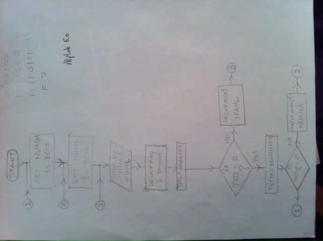

Okay so for the past week I have been struggling with getting the 00-99 Counter to work I need someone to help me out I have attached a picture of a flow chart of what the program needs to do I cannot get the program above to work i am using a pic 16f877a configuration 3F73 this needs to be in assembly and use port D Can Someone PLEASE HELP ME?
PLEASE SOMEONE HELP PIC16F877A 00-99 couunter Assembly
I have been working on a counter all week and i have code that isn't working out and I need someone with more knowledge to possibly write it for me as i do not have the skill to do so Below you will find the code i wrote which isn't working. My configuration is 3f73 on a pic16f877a PLEASE HELP ME.

Trying to debug code without knowing the hardware is extremely difficult. So, do you have a schematic?
no not really i can take a picture of the board but its kind of messy there are 2 npn transistors bottom left taking care of multiplex port B RB0 is where those transistors are being powered etc...board.JPG
How can 1 npn be on and the other off when they are both powered by the same pin?

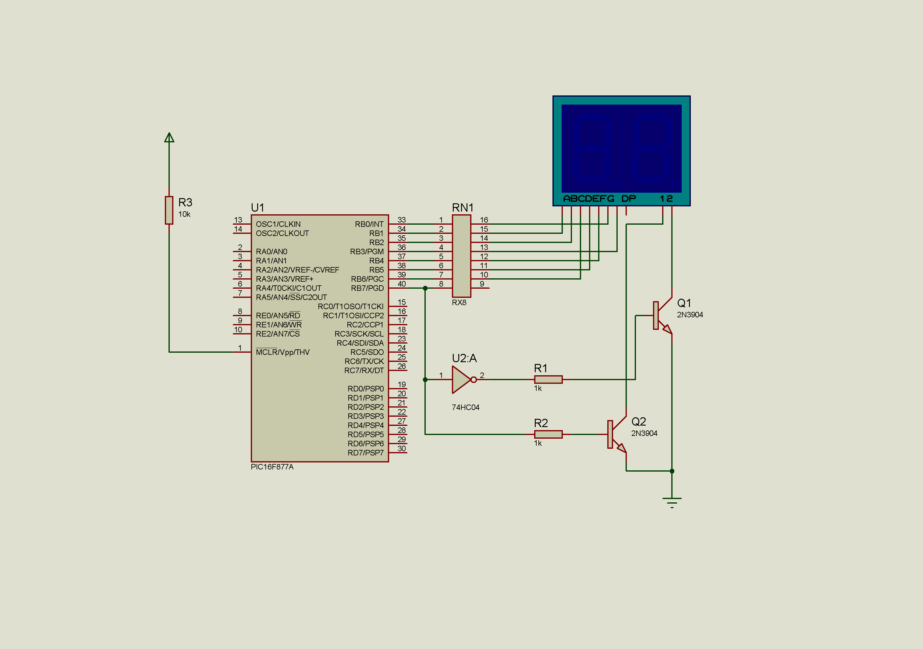

If you are using common cathode LED, your schematic would look like something as attached.
But then your program code was designed to run on common anode LED. As segment to be ON is at logic "0".

So you need to add 2 instructions here:
; Timer (TMR2) timeout every 1 milli second
		bcf	PIR1,TMR2IF	; Clear the calling flag
		btfss	SEG_PORT,7	;check which LED was last
		goto	Do_tens
		movfw	ones
		andlw	0x0F		;make sure in range of table
		call	LED_Table
                XORLW     0x7F        ;ADD INSTRUCTION here
                andlw	0x7F		;set to correct LED
		movwf	SEG_PORT
		goto	INTX
Do_tens		movfw	tens
		call	LED_Table
		XORLW     0x7F         ;ADD INSTRUCTION also here
                iorlw	0x80		;set to correct LED
		movwf	SEG_PORT
Shouldn't this be 330 Ω resistors?

Except he doesn't list an inverter.
Good:) So at least he has to use his brain power a little bit to figure it out.....

The problem i am having is that it isnt showing any numbers on either 7seg its just random i know its hooked up right because i have just a single 0-9 counter on another chip and it works fine when i swap out pics.
my mistake i had it that one was being powered by RB0 and other was just to ground
Are you sure it is powered by RB0 and not RB7?
Are you able to understand the schematic that I've posted?

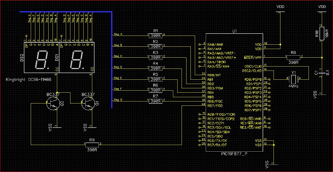

Your code is more or less OK. I have got it working with minor tweeks.
Check your config directive.
Check your banksel directives.
Careful where you clear TMR2IF.
I used 2 x 2n7000 mosfets on RB7 to multiplex.
I used common cathode displays (all I had available)
Edit:
Had another look at this.
Cut and pasted your original code and it built / ran ok. Only change made was to the lookup table as my cct has CC LEDs
Used 2 x BC337 NPN transistors in place of the 2n7000s
