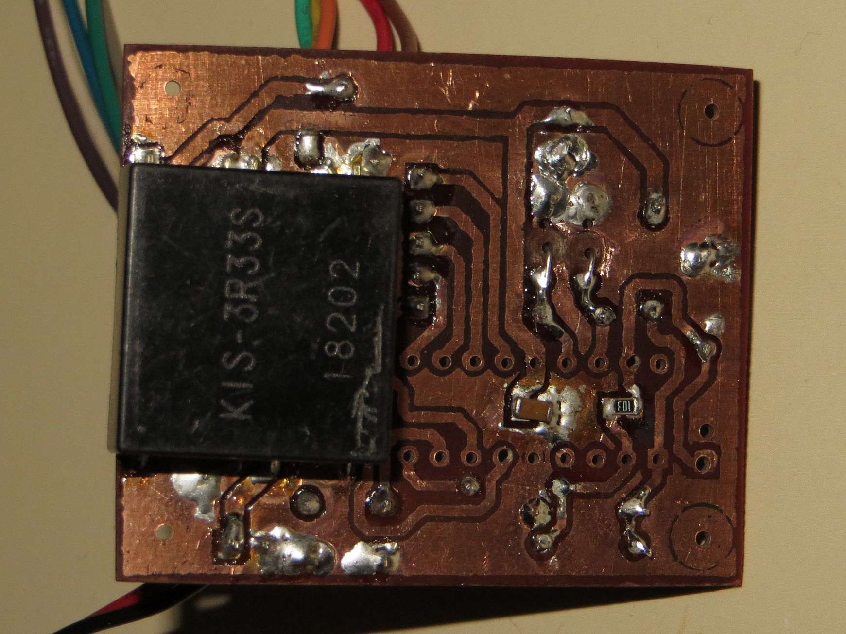

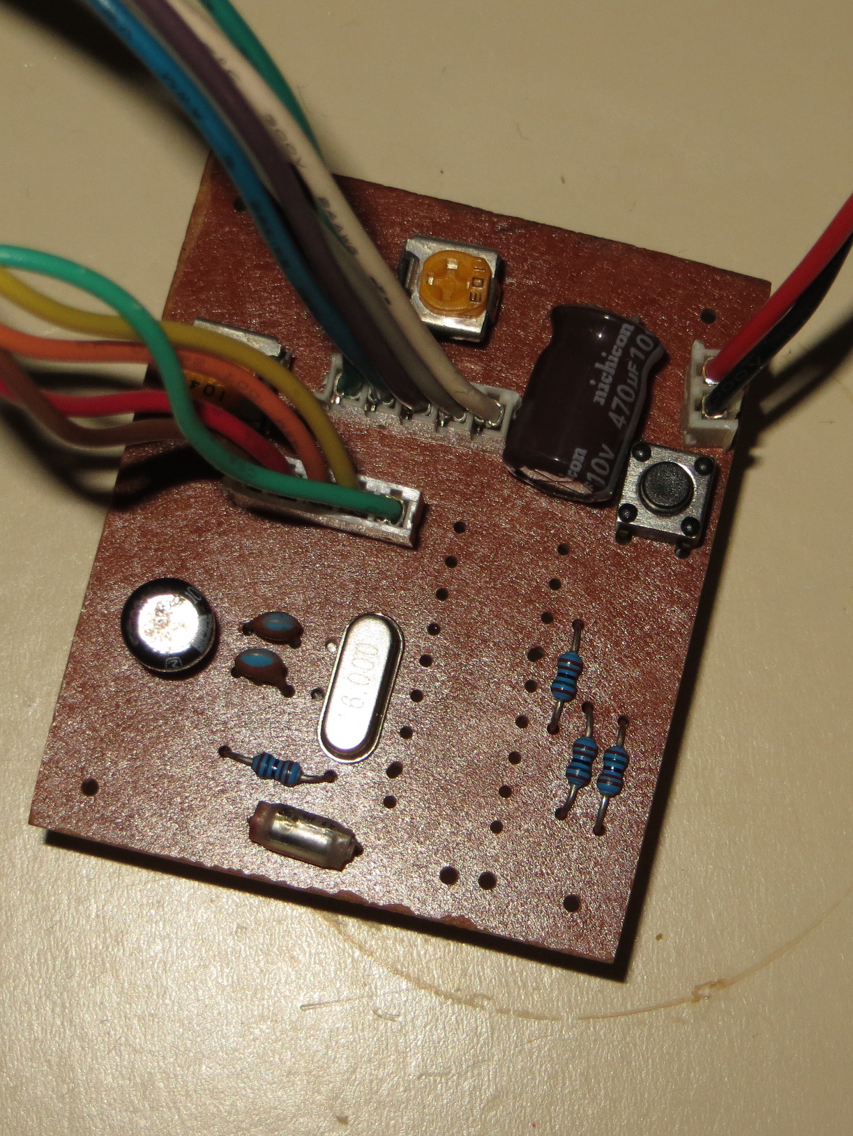

Waiting for PIC to arrive in post from China now. Will be first test of homebrew PIC programmer. Photo's of top and bottom of board. The SMD's on the bottom are decoupling cap for the PIC and the 10K resistor. SMD resistor was cheaper since I decided to use 0.1%. Cap is board pull. Other caps also board pulls. The big black thing is a buck module I used instead of a 7805. The headers with the wires I pulled out of an old monitor or something. Had to chop them up a bit. Didn't have a 270pF cap so used 220pF - hope is ok.
I put the 22pF caps too close to the crystal and had to re-drill. Pity. It's because Design Spark's standard xtal case is smaller than the real one. Anyway, it's my first proper toner-transfer pcb. It's just about acceptable.
Soldering looks rough because I'm waiting for a new element for my soldering iron, so I used a home-made blowlamp-heated one. Drilling is a bit off because I'm waiting for collet chucks for home-made pcb drill so did it by hand. Switch is a long way from front panel, but I'm getting quite good at making little button extension type thingies out of plastic tube from hand-soap bottles now....

That PCB looks pretty good for a "first proper toner transfer PCB". :)
The 220pF/270pF cap swap should not matter, because it is zeroed out later anyway.

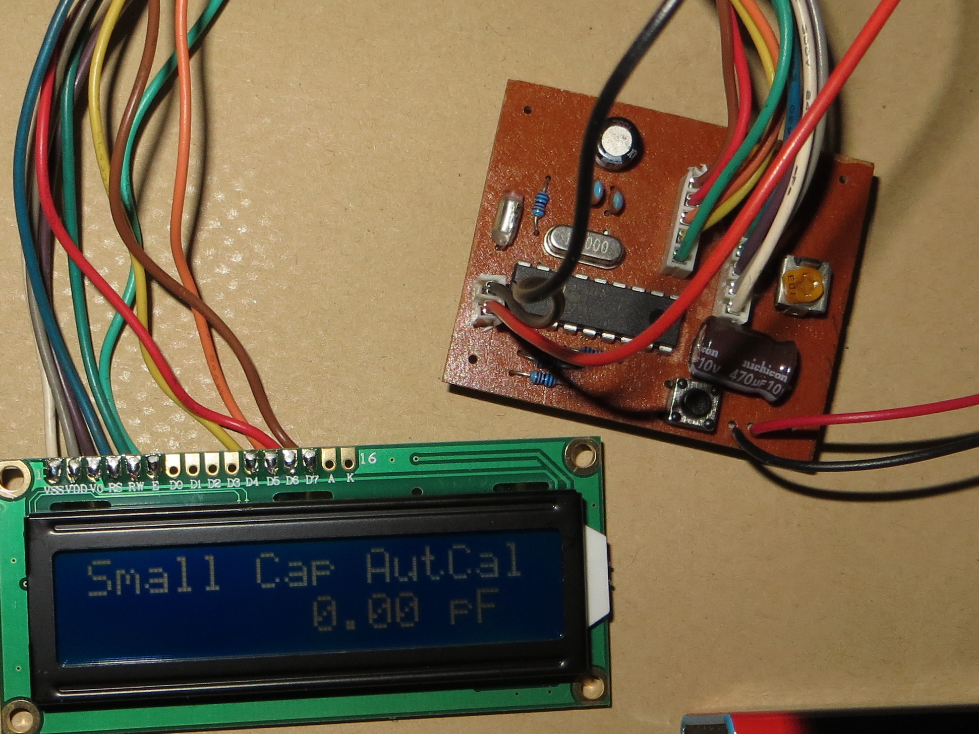

I finally built a PicKit 2 clone with some help from friends on here, so was able to finish the cap meter. You can see in the photo how a backlit LCD looks without the backlight, too...
BUT, I tested it with a fairly ancient 1% 39nF cap, the meter reads it as 35.8somehing nF, way out of tolerance, even though I used a 0.1% resistor for the 10K. I suppose it's possible I've cooked the resistor, but I don't think so. I tried some other caps as well, all read low. What else could be upsetting the reading?

Hmm, I'm not sure about why the calibration is out, reading 36nF on a 39nF cap is a fair size error. The osc is running about 7-8% fast. I assume you zeroed the meter before testing?
I would leave the Vdd voltage at 5.0v, but add a decent sized tantalum (>=10uF) under the PIC on the bottom of the PCB right between the Vdd and Vss pins. If the PIC is not decoupled well with a cap then the Vdd might be pulled down as the comparator oscillator switches which could affect the 1/3 and 2/3 threshold points the comparator oscillates between. What tolerance are your 1k5 resistors?
Otherwise if none of that helps it is no big deal, you just need to change the 10k resistor until you are happy it is right. As the oscillator period is linear to the cap value, changing the resistor to be correct at 39nF will make it pretty accurate across the whole range.
Since your osc is running fast, all you need to do is add a 500 ohm or 1k trimpot in series with the 10k resistor (ie needs >10k), and adjust the trimpot until the meter reads exact. :)
There's a 0.1uF SMD ceramic cap under the PIC, but I'll try stuffing a tantalum (or bigger ceramic) one under there. The 1k5 resistors are 1%. The crystal was in a pack of 2 - if better decoupling doesn't work maybe I should try the other one? Actually now I read a little, is it possible I have series cut crystal? The Microchip doc on oscillators says it must be parallel cut or the frequency might be off. I just got the cheapest ones, from here: https://www.ebay.co.uk/itm/11107354...eName=STRK:MEWNX:IT&_trksid=p3984.m1439.l2649 This is the datasheet: https://www.electro-tech-online.com/custompdfs/2013/08/hc49slf.pdf. Can't actually tell which I have.
Of course it's possible I copied the schematic over to DesignSpark wrongly...
Edit: since it's reading low, it it possible this is because I put a 220pF instead of the 270pF? Going to try 330 after I've had another hunt for a 270. Hey I now have a nearly working cap meter to help find one!
Mystery solved. I cut and rerouted the track leading to the test lead pads after I realised it passed close to the oscillator, also added an extra decoupling cap to the vcc end of the top 1k5 divider resistor. So doing those increased the reading by 400pF - shows what a difference board layout can make!
The biggest difference appeared when I tested some 2.5% and 5% caps which measured ok. Seems my 1% cap is out of tolerance. Duh. Suppose I should get a new one to test...

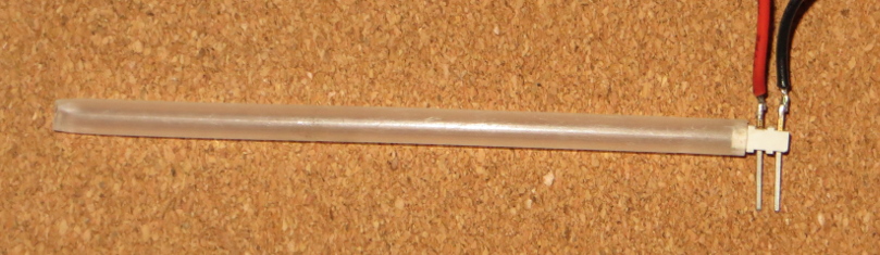

Picture attached of the probe I made - someone might find it useful. The handle is cut from a piece of pipe from a household cleaner spray bottle.

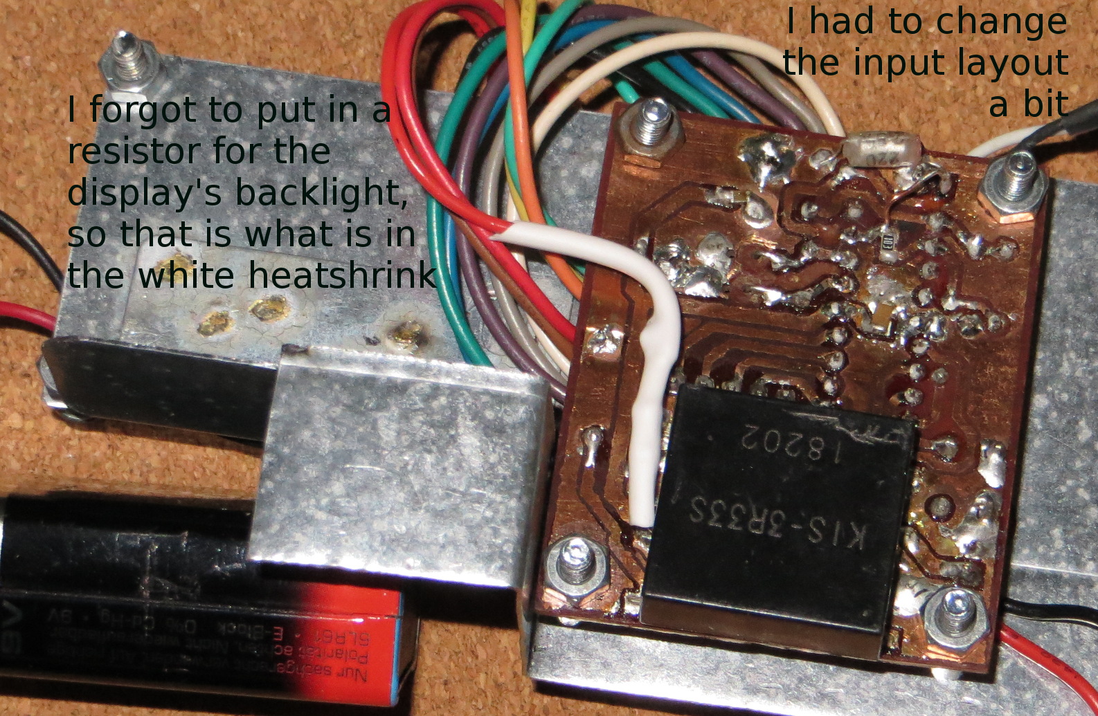

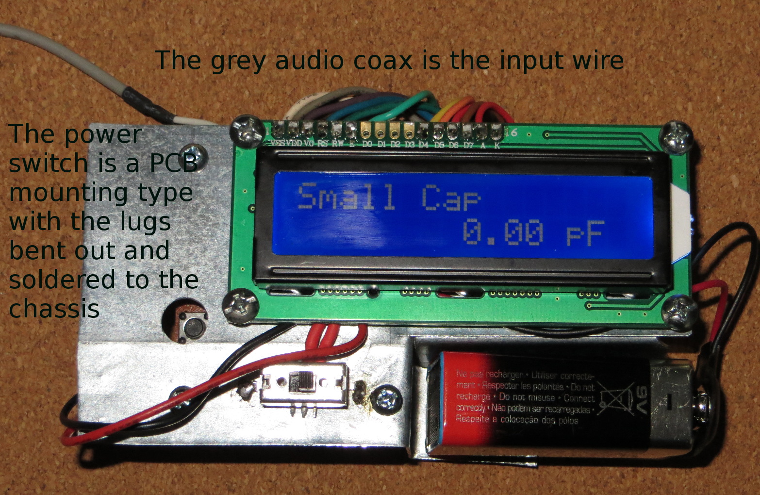

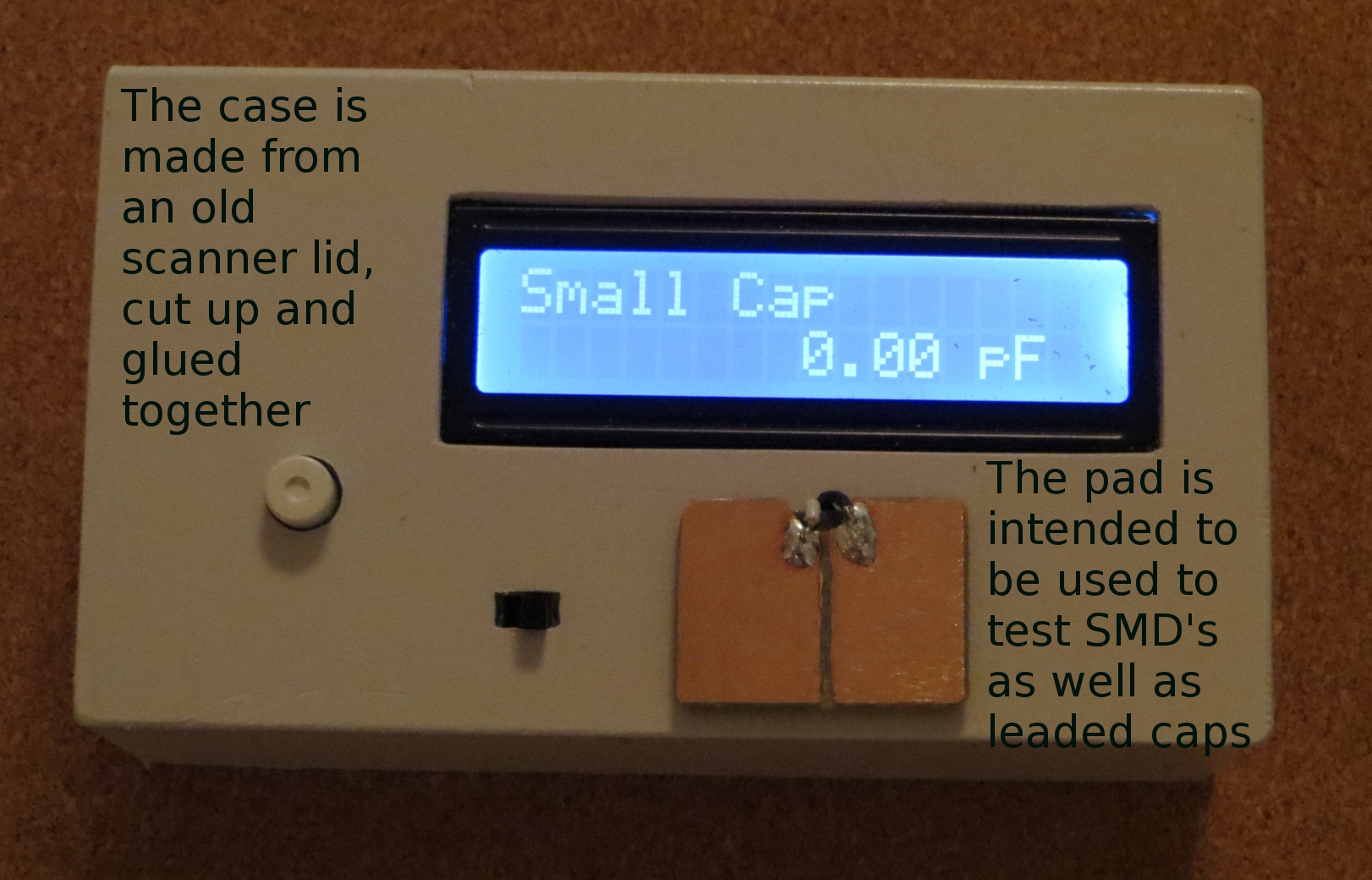

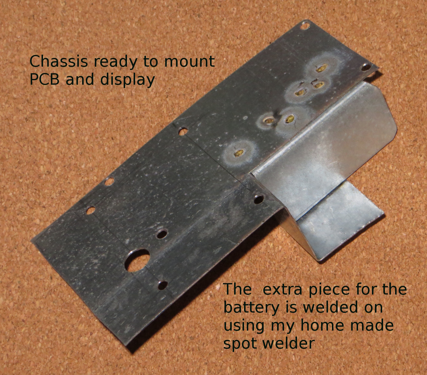

I mounted the pcb and display on a chassis, then made a box for it out of an old scanner lid. The zero button is from a biro, it pushes the tactile switch via a mis-align-able push rod. I made a test pad so it can be used for smd caps... See photos (I am very pleased with it!)
