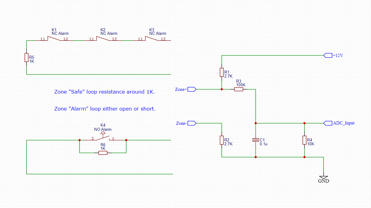

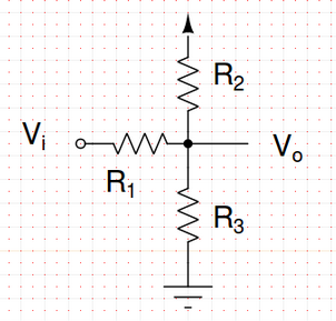

Not quite; like this:
The 100K and 0.1uF form a noise or spike filter; those and the 10K act as a divider to scale the input voltage to a suitable low range for a 3.3V ADC input.
You only need the analog multiplexer if you have more zones than ADC channels; the boards I photographed have sixteen zones each, making up to 48 in the main unit and the version I use here works with remote expanders up to 192 zones total, though I only need one for the garage.
There is only ever one EOL resistor on a zone.
The loop supply should be a minimum of 12V, as low voltages cannot guarantee contact "wetting" and conduction with switch contacts.

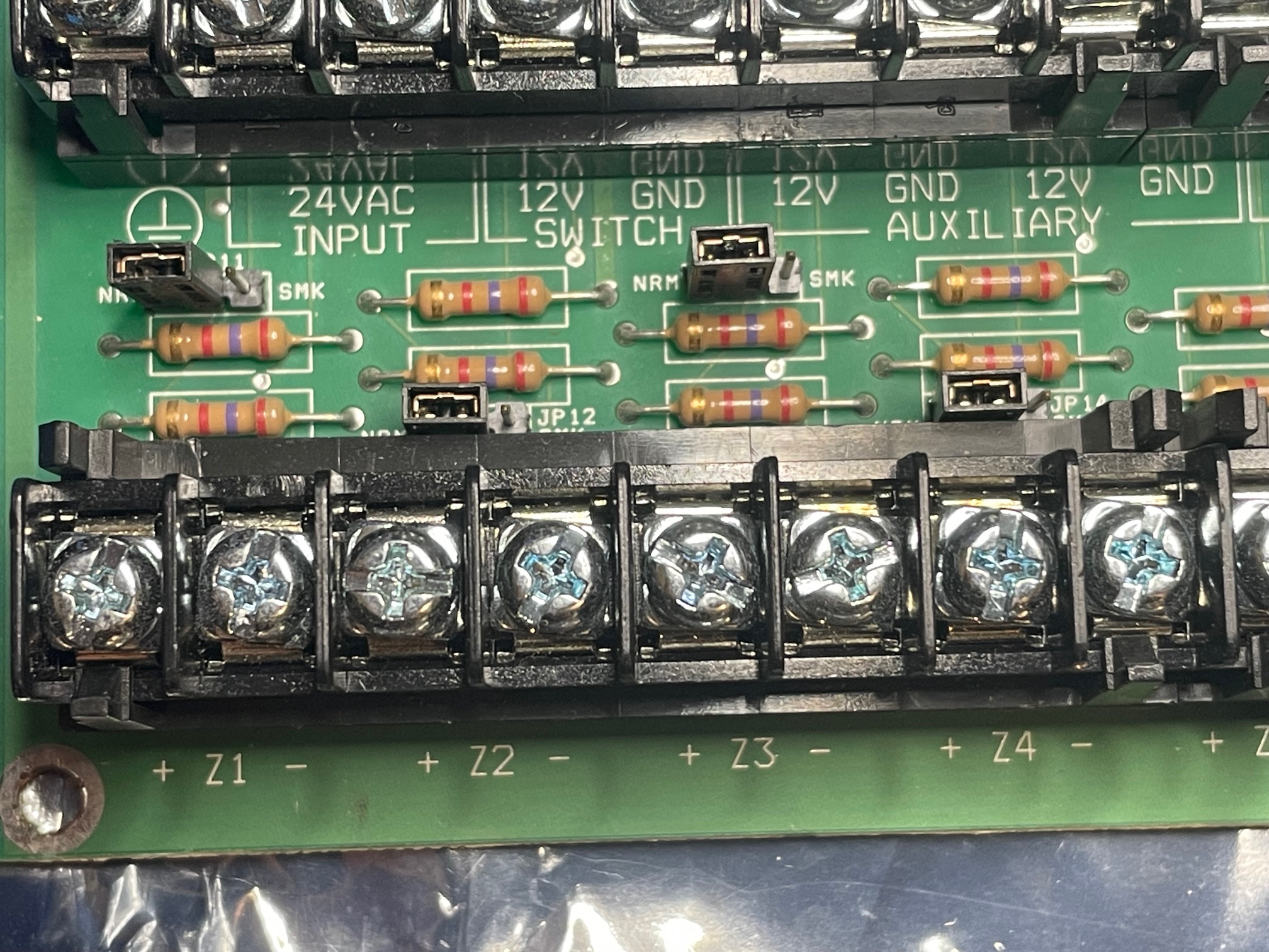

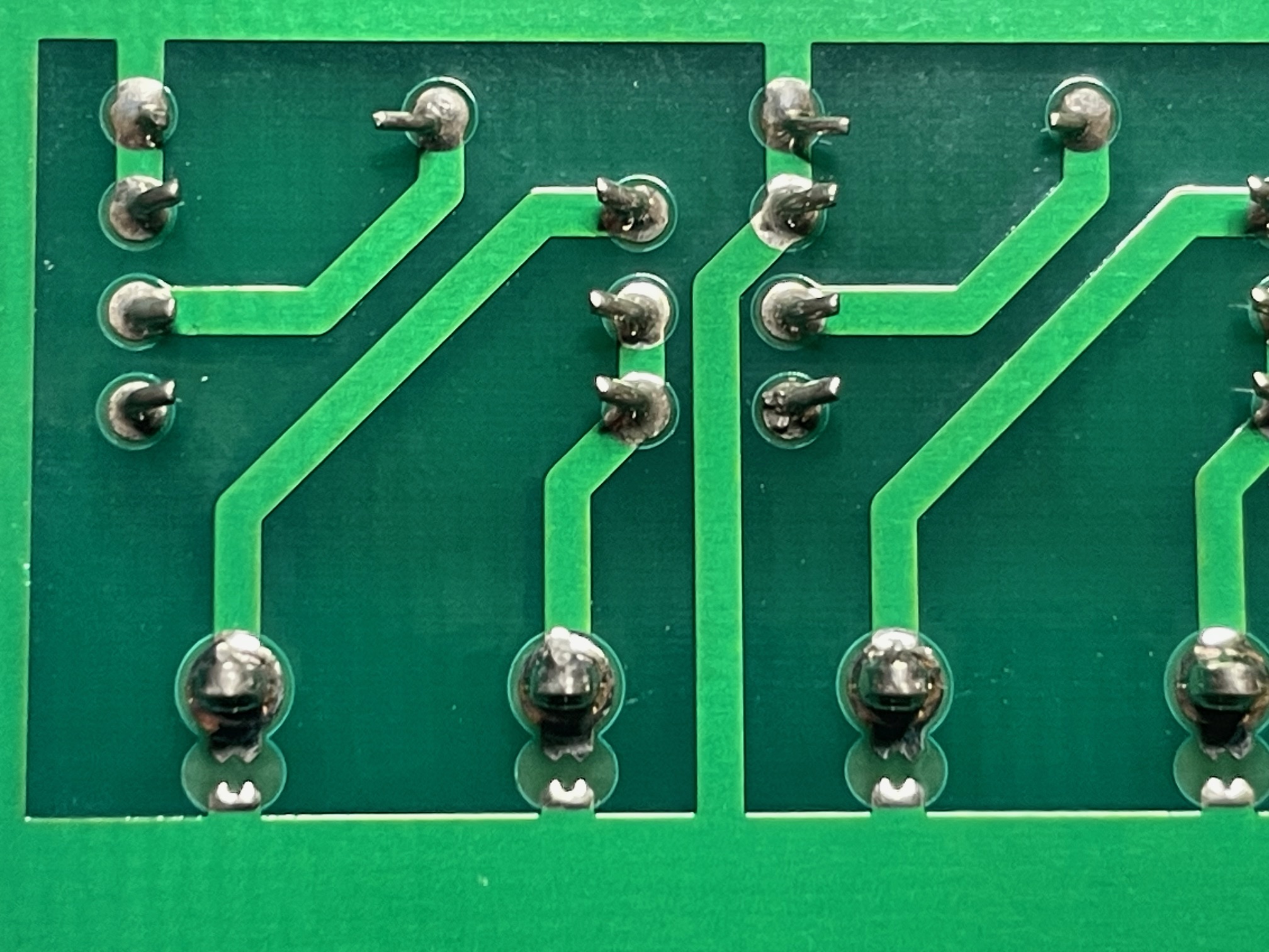

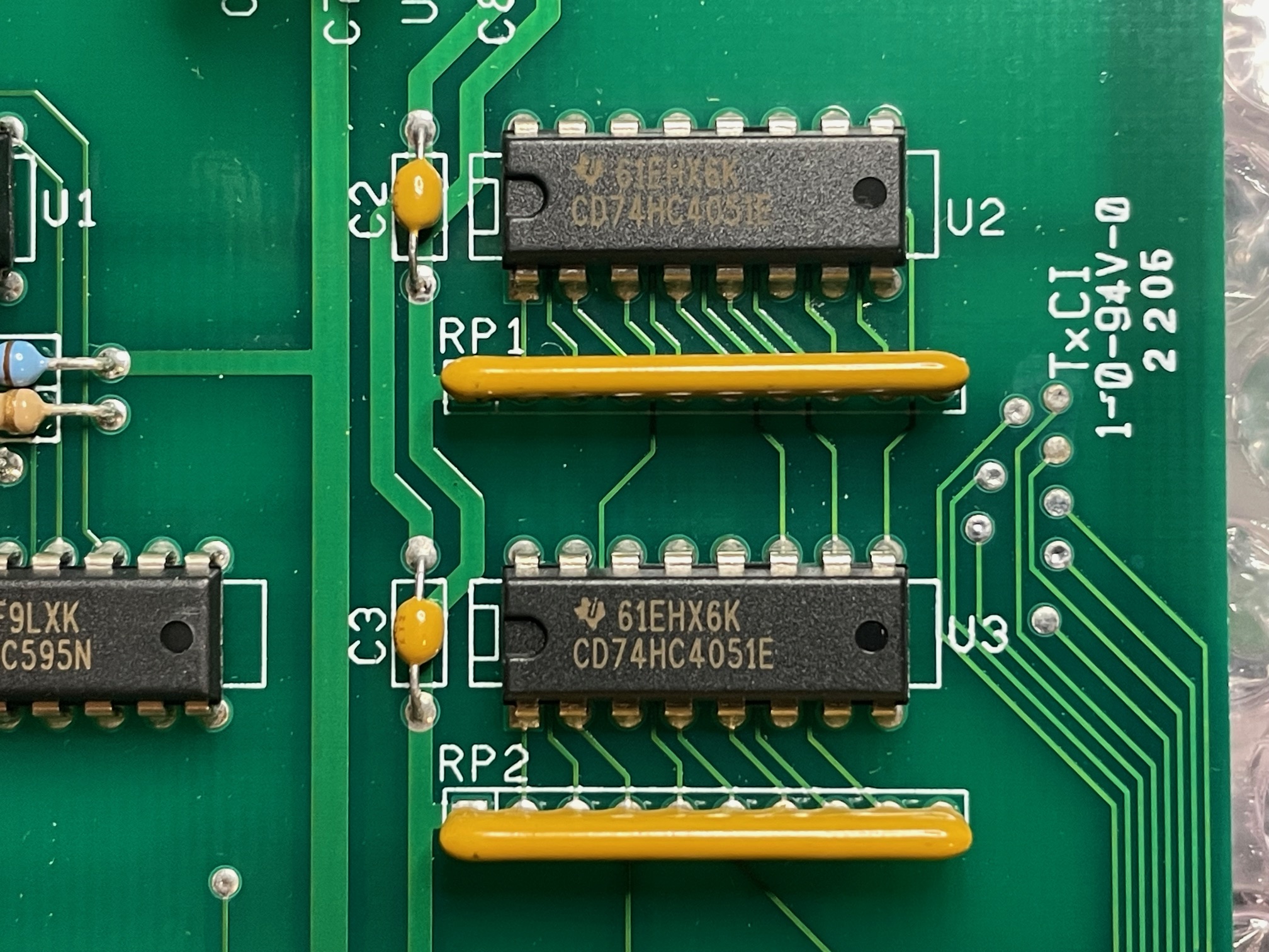

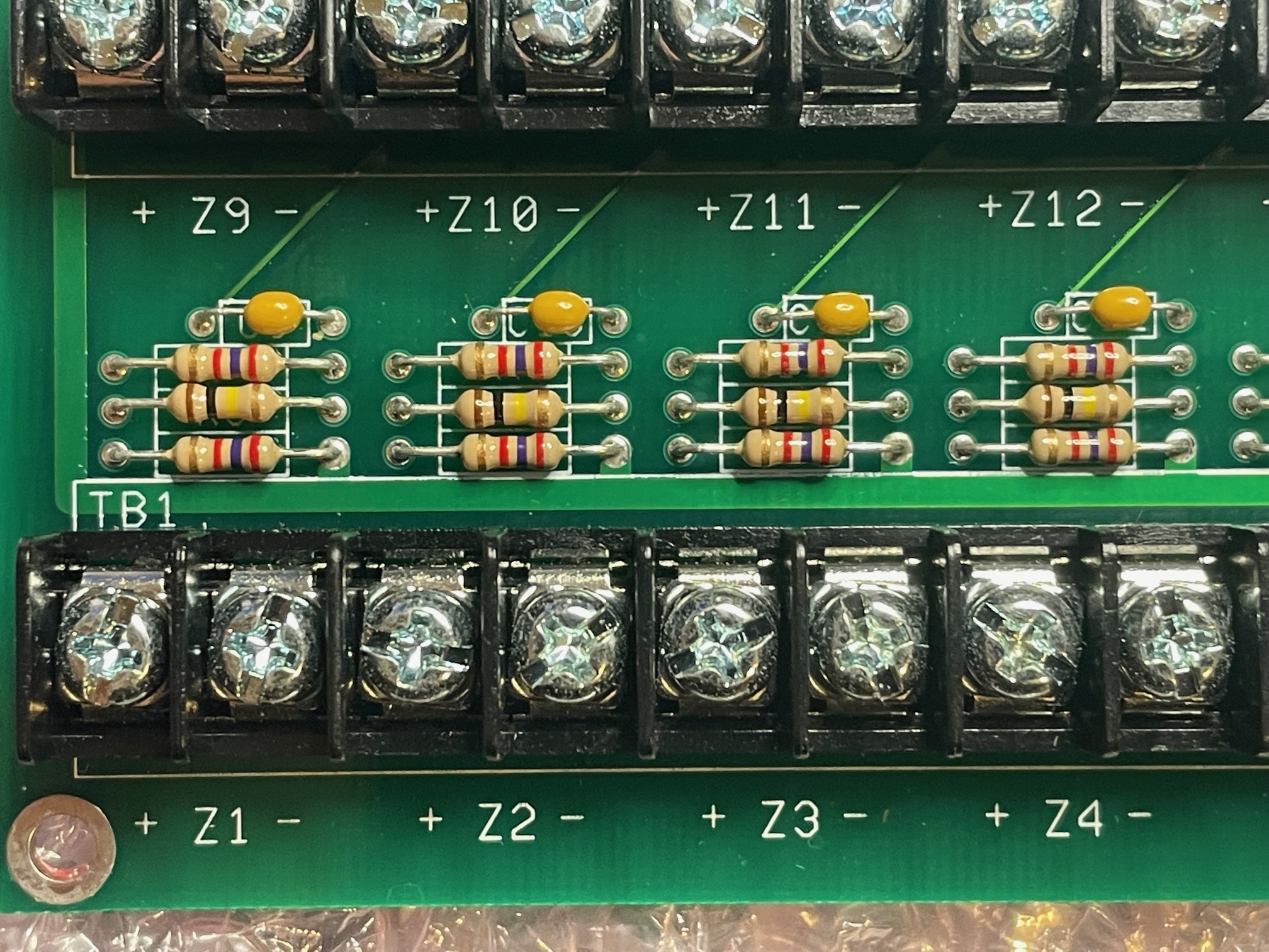

This is a live reading of some zones, from the system setup program:
The zone input circuits on the high end commercial systems I use have this:
2K7 so ground from zone -, 2K7 pullup to 12V from zone +
Then, 100K from zone + to a 10K pulldown paralleled with a 0.1uF cap, with the divider junction connected to an analog multiplexer (4051 or 4052, depending on the board).
The multiplexer output goes to an ADC input with 0 - 3.3V range.
The zone terminals also have small spark gaps to ground built in to the PCB.
It uses 1K zone terminating resistors, in series for normally closed sensors or parallel for normally open.
The photo with only the 2K7 resistors visible is a system controller, which has the rest surface mount on the back.
The one with three resistors and the cap all visible is an input expander board for the same series system.
The input circuits are pretty much identical on each, other than the first four on the main board having jumpers to set an alternate mode for some USA two-wire smoke detectors, that I've never used in the UK. (I use Texecom 4 wire ones connected to standard zones).

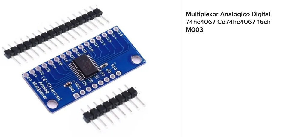

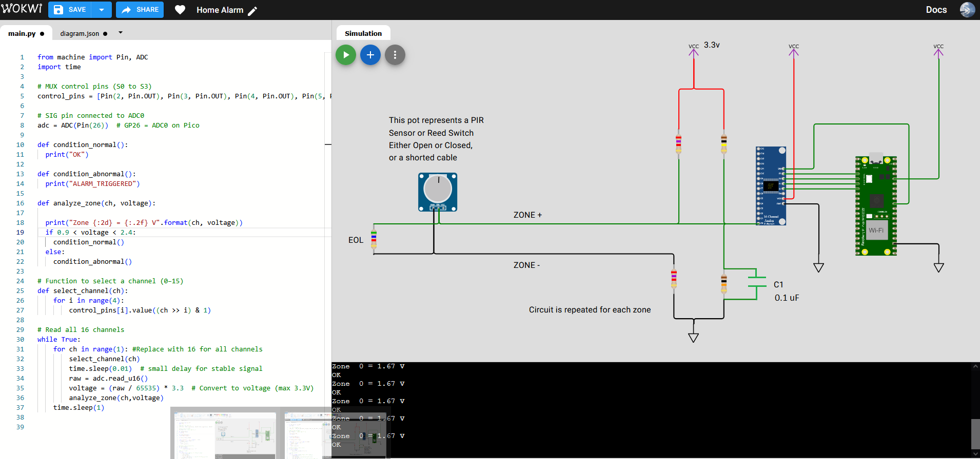

First of all, thank you so much Rjenkinsgb for investing your time writing this explanation, and even including beautiful photographs!
I was not able to get the CD74HC4051E, but found a little cheap module model Cd74hc4067
Armed with my very basic simulation program I made the following abomination:
Please apologize me if I grossly misunderstood your instructions, I'm not exactly the brightest bulb in the box. The circuit detects the open and closed condition of the sensor just fine, but not the removal of the EOL resistor or shorting the cables. What could be the problem?
Thank you!
EDIT: Maybe the goal is to build a three-resistor voltage divider?

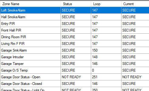

Around 150 is safe, near zero or near 250 is an alarm state.
I'm not sure of the exact range considered "safe", it could be between 100 and 200, or 125 - 175.
The cable resistance will not be more than a few ohms even on long runs, so is negligible compared to the 1K.
(The garage o/s temp one is a data link zone; low speed serial data using a zone input and one of the outputs).
Zones on these systems can be configured for many things, general inputs & sensors as well as the perimeter & day/night/away/fire etc. alarm modes, that's what the garage door status ones are, status inputs; it's all networked with my home automation system.

ps. Using all the same values, 12V and 1K EOL resistor, it looks like the "Zone secure" input at the ADC should be around 0.5V
Try using 0.25V - 0.75V as a "safe" input range and outside that as an alarm?
