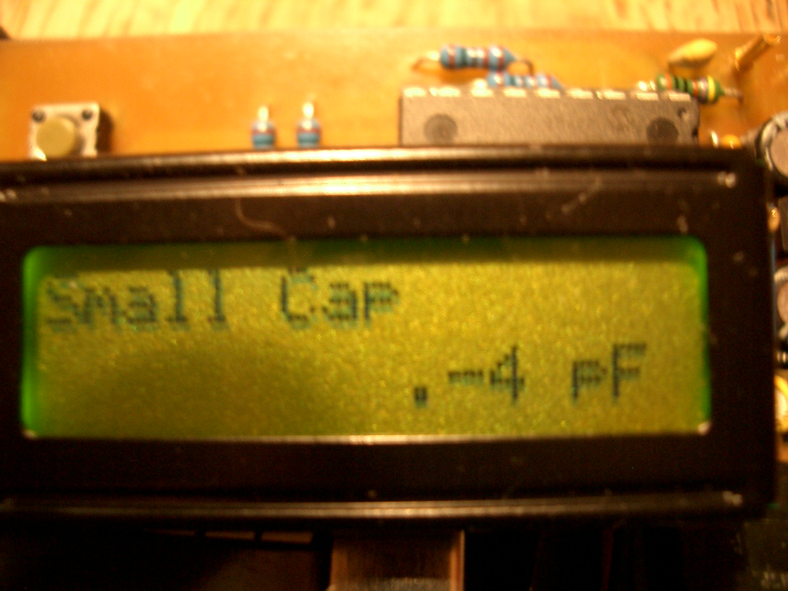

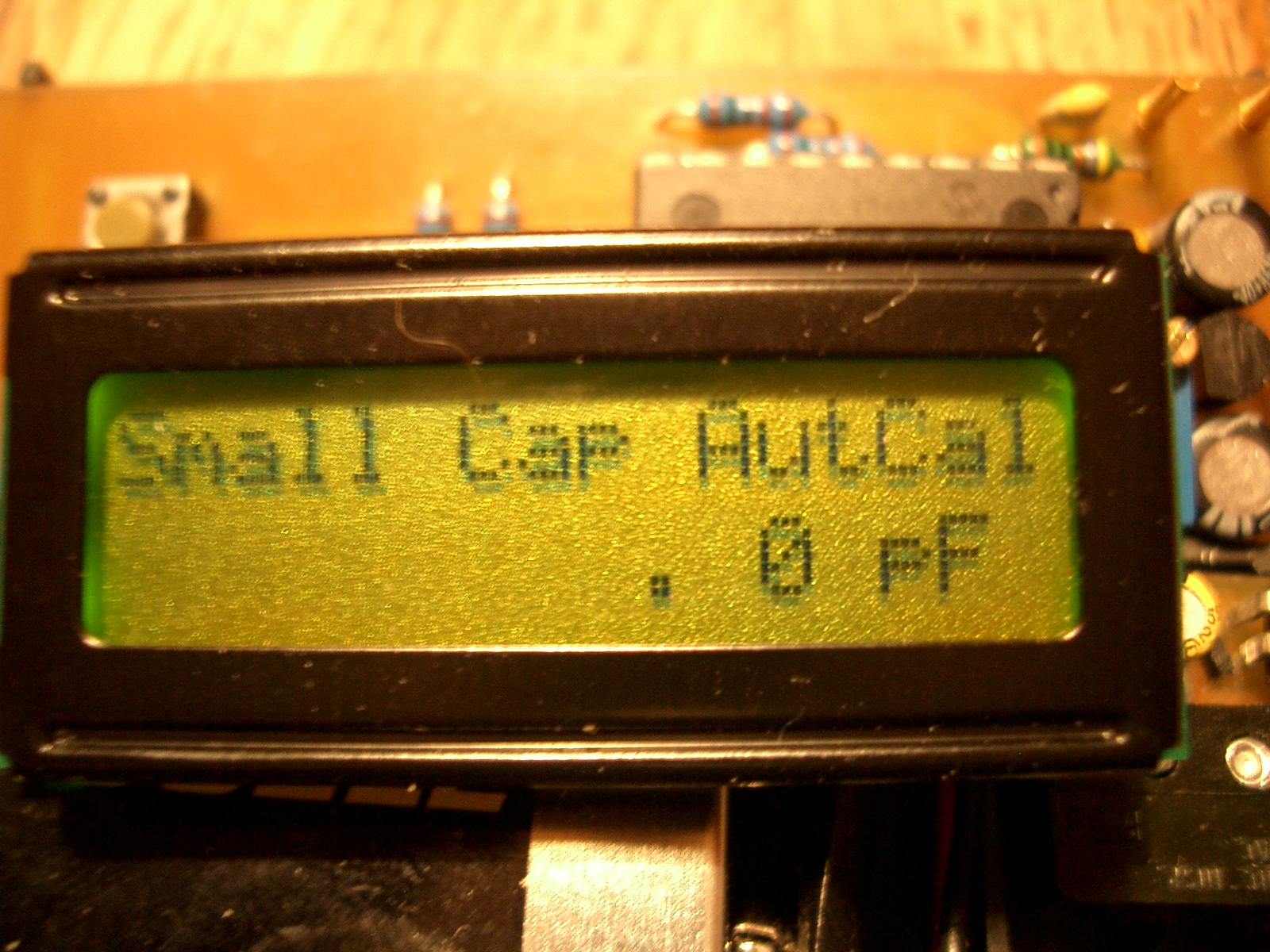

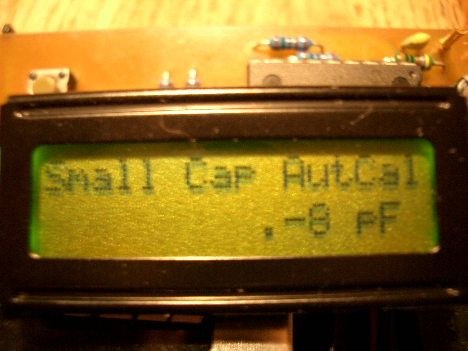

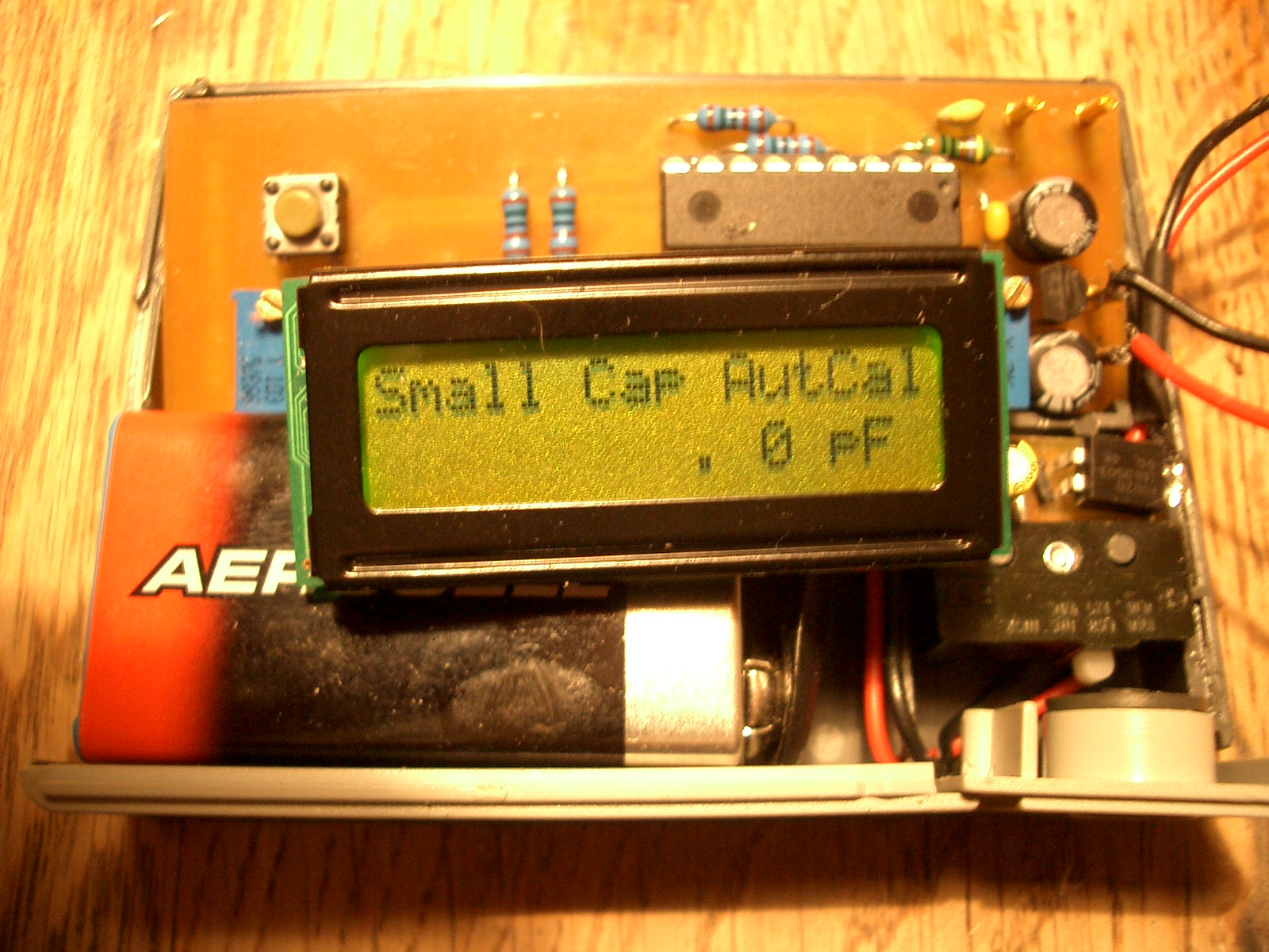

OK, sorry for the delay Wjhos but I finally worked out what you meant. :)
Originally the capmeter code was only JUST squeezed into a 2k PIC, so I left out the nicety of leading zero correction. It was a trade-off to still be able to fit all that 32bit math code into a tiny cheap PIC.
So in the original HEX file it shows; " . 1pF" and " .-3pF" instead of "0.01pF" and "-0.03pF".
However there are probably other fussy (OCD?) people like yourself that really hate imperfect leading zeros. ;) So I found a way to squeeze the leading zero correction into the code.
I have re-programmed my own Capmeter and it seems to be all working perfect, and since this was only a minor display tweak I have not bothered with keeping the old HEX file, so the one on the web page is now the new improved HEX.
And thanks for the suggestion. :)
New HEX file is here;
https://romanblack.com/onesec/CapMeter.htm
Hello,
I read your answer, and it is exactly what i ment. As you asked for some fotos, i was making them just before reading the answer. I have attached them and they show the problem, which can now be solved using the new hex file, which i will download and flash shortly. Sorry, the fotos are not that sharp, but i used a simple camera. I can also post the PCB layout (which is in Sprint 5.0 format)
thanks for your esponse

Hello,
For some reason, the download hex file does not work. I do not remember how i did it the first time, but i think i had to copy/paste the file to wordpad. I did that now too, but when i load the file to my Pickit2, it is not completely the same. In the meter it does nothing at all. Can you provide the file as a downloadable file that can be directly imported to a programmer. It seems now it is a hypertext file ?.
regards
Thanks for posting the photos that looks like a nice neat tool you have built there! :)
And I like your old grainy reflector supertwist LCD, they have great visibility and with no backlight they only use a couple of mA. Those old LCDs are getting hard to find now, all the LCDs now have backlights and use 20-40mA. :(
Re the HEX file, the link I provided above is to the project web page. The link directly to the HEX file is here;
https://www.romanblack.com/onesec/CapMeter.hex

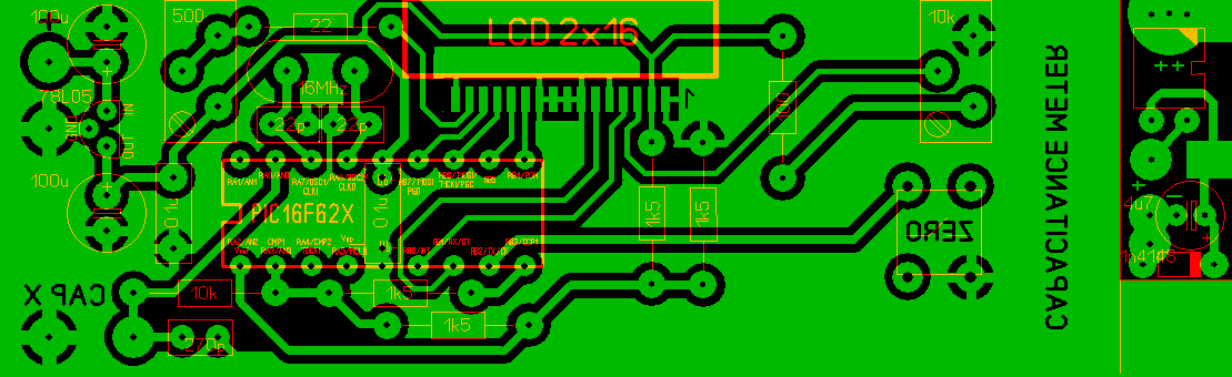

Re your PCB layout, sure if you like you can post it here. It may be of interest to people who want to build their own PCB. :)

I attached the layout of my PCB, without the protection components. It is in Sprint format. A free viewer can be found at abacom.de

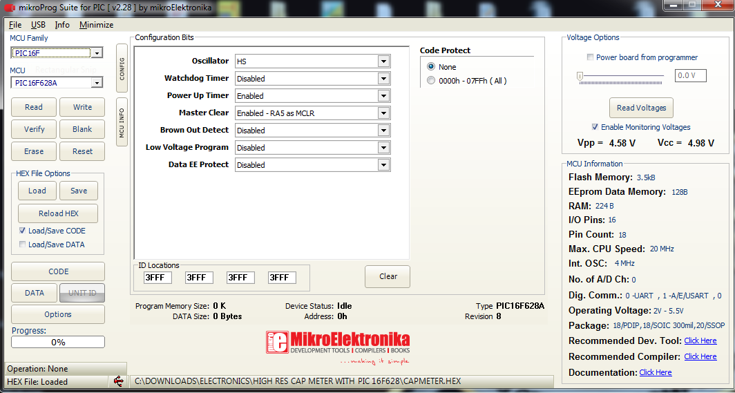

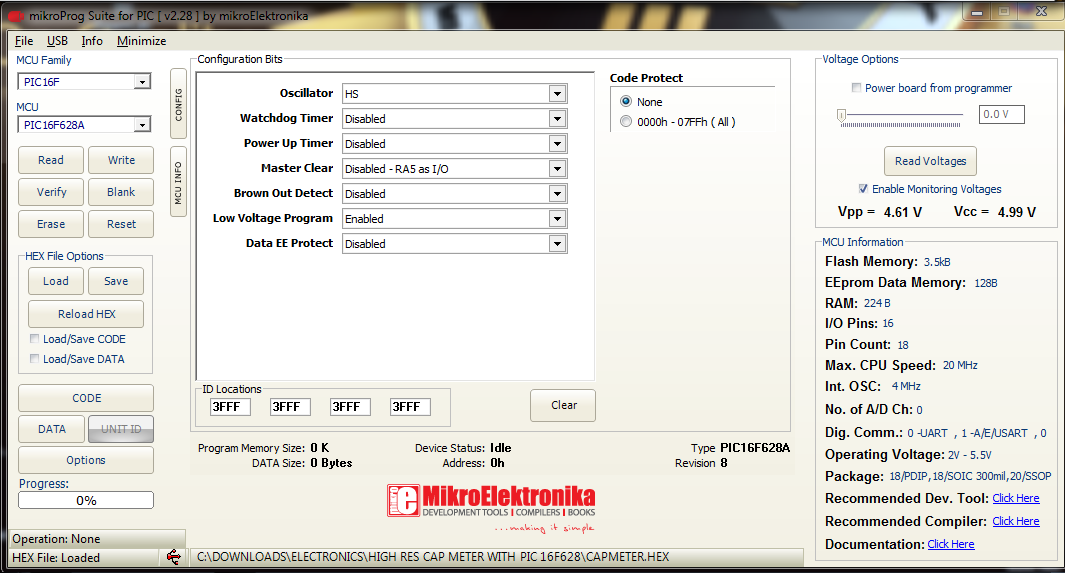

need a bit of help in programming the pic please
need a bit of help in programming the pic please.
i am using mikroelektronika's EasyPic 4 board..
PIC16F628A chip with 16Mhz Crystal..
everything the same as your version..
your new version of hex..
Hi PaulCo, your configs are not correct. I just loaded the Capmeter.hex into my MikroFlash programmer, and the configs read correctly;
osc = hs
wtchdog = off
power up timer = on *
master clear = off
brownout = off
low voltage program (LVP) = off *
data ee protect = off
Yours is different in 2 * places.
I think it could be the EasyPIC 4 hardware forcing the PIC into LVP mode by holding the PORTB pin high.
Try this;
1. on the EasyPIC4 set the PORTB pullup jumper (right hand side of pcb) to PULL DOWN (that stops LVP being activated)
2. open a new PICFlash on screen
3. select PIC 16F628A
4. file -> load HEX -> Capmeter.hex (configs should be correct to match mine)
5. click "Write" button to program the PIC
6. check the configs are still shown correct, and there were no error messages
7. yay! success. :)

Thanks MrRB - going to build one of these to sort out my smd board pulls and other dubious caps!
Is there any advantage in using a resistor pack for the 3x 1K5 resistors? A few 2% ones around, but I assume the relative tolerance of the resistors is better than that. I got a 0.1% for the 10K.
Almost! MCLR (Master CLear Reset) needs to be OFF. The project does not use a Reset button.
found out it was because the mclr jumper was on, when i changed to i/o then it worked when programmed with mclr off..
excellent thank you..
