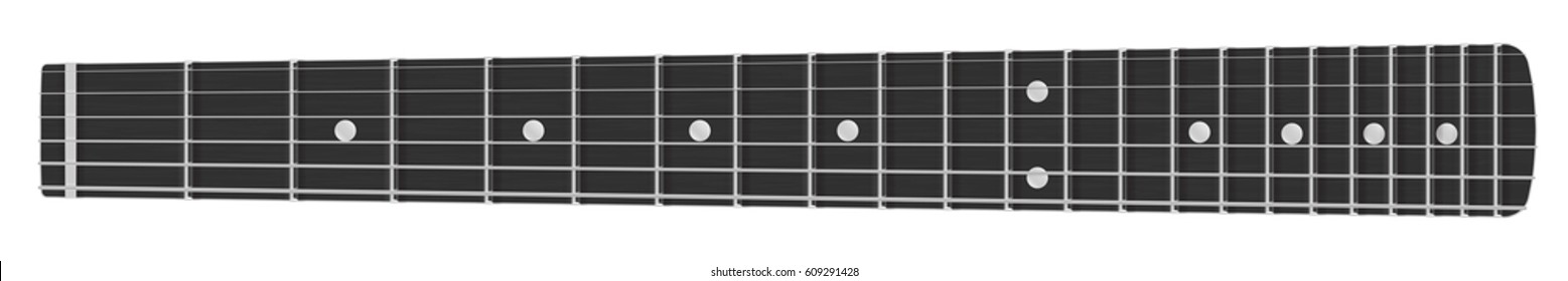

Guitars use all twelve semitones with no distinctions, one fret per semitone.
It's down to the tuning of each string as to what the lowest note each can play is.
The commonest tuning has each higher string starting five (or four) semitones higher, a 5-5-5-4-5 pattern, so the high string on a six string guitar is then two octaves, 24 semitones, higher than the low string.
You can see the progressive logarithmic intervals in the spacings of the frets, wide near the head of the neck and narrow at the body end:

I could not follow your guitar strings. Just use one string. Does a fret, change to one semitone?
And the taut on the string changes wavelength, right? That would interfere with the fret spacing, wouldn't it? A horn would change tube lengths for notes and could be set. But with a string, can the wavelength be changed with taut? Or tension?
Hold on a second, I just got it. We match the frequency to the SET length with taut. And the other fundamentals are set to that same length......and the fret distance remains set.
That's really neat.
