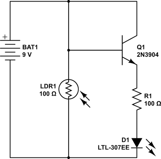

True, it changes resistance when exposed to light. To get it working you probably need a transistor and some other components like in this schematic.
Athosworld , where did you find that terrible circuit?
I'm not sure Q1 will ever turn off with its base connected to 9v. And, why would you do high-side switching with an NPN transistor?
True, it changes resistance when exposed to light. To get it working you probably need a transistor and some other components like in this schematic.View attachment 143163
Worst possible 'circuit' in the world, and then it's even drawn completely wrong with parts missing :D
And where do you found a 100 ohm LDR?.
