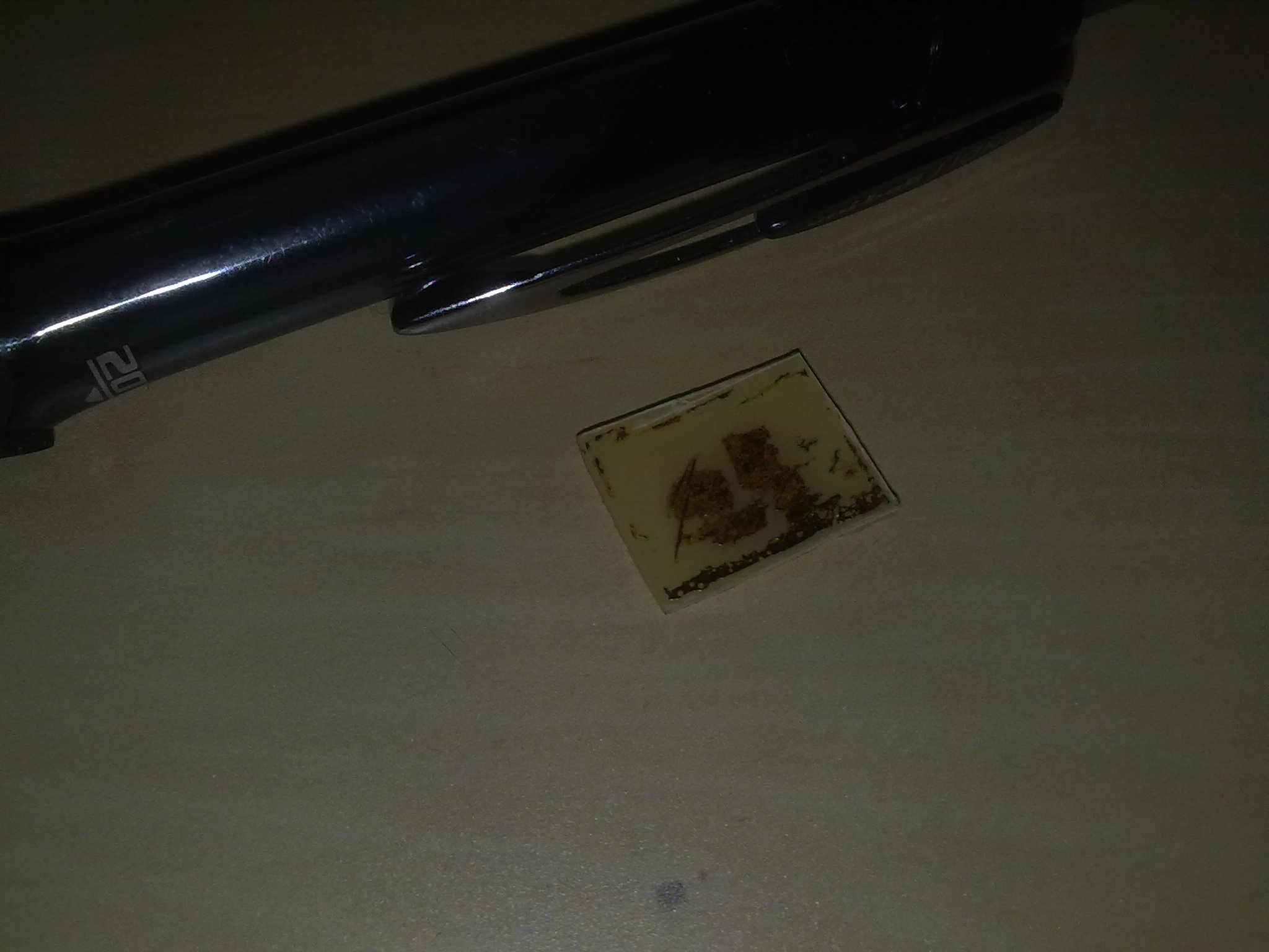

Hello everybody,
I have a project I have been working on it for a while and now it is the time for producing the pcb board...however, It is not so easy as writing....
I have some positive photoresist coated boards. I did not coat them with positv20 spray or smth similar.
before advancing to the original project, I cut some small pieces of pcb board and tired to find exposure and development times...
I find that, with the black light I have, 12min exposure is necessary. I used a NaOH solution for developing step and after almost 2min the patterns were nicely observable on the board.
as the final step I etch the board with Fe3Cl solution. however, it does not go further even though I waited half an hour and put the container in a hot water bath. there are some areas close to the board edge where were partly etched and some spots on the board. put the pattern is not appearing.
the situation makes me quite curious because the main project is a double sided board...
So, I would like to hear your ideas.
The most likely cause for that is under exposure. It could be underdevelopment, but as we know nothing about the particular products you are using, it is hard to say. I doubt it is underdevelopment.
With my photoresist, the exposed areas turn purple when exposed to the NaOH developer. Did yours do the same? Was all the purple gone before you tried etching?
To check for underdevelopment, take one of your scraps that didn't etch, put it in bright sunlight for 15 minutes. Then try your developer on it. If more resist is removed (i.e., you get a purple color), then underexposure is the culprit.
Another way to test for underexposure is to put the scrap in more concentrated NaOH (like you will be using at the end to remove all resist), rinse, and put in FeCl3. If the netal now etches, it was probably underexposure.
You say "blacklight." Please be more specific. What bulb did you use? How is it labeled? How close is the bulb to the PCB? What wattage?

ok, I start with the bulb. it is a 75W UV active bulb brand is omnilux. I exposure from 15cm distance.
the exposured resist turns into not purple but orange-dark brownish color and masked sites stays yellowish after developing with NaOH (10g/L) solution.
I also bought sodium persulfate today and it worked with some scraps but the etching rate is still so slow in spite of the hot water bath and the traces are not well resolved...
I also tried 30min exposure and after that the development was rapidly quick, the traces have disappeared before I decide it is enough or not...
Now I try 45 min exposure, I suppose I will get the result in one hour

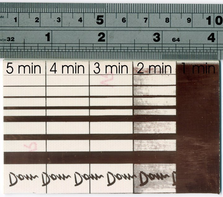

Do a test board and use a few different exposure times masking off different areas. Also have a small part of the board where you take off the photoresist with a bit of acetone or similar.
It sounds to me like the copper isn't being totally and cleanly exposed to the ferric chloride - even a bit of grease on it will slow down the etching so if the photoresist isn't completely removed it won't etch properly.

As for the lamp, I didn't find what I wanted to know. The rating is 75W, which is probably just its power consumption. We don't know the source of the UV and so don't know what the spectrum of light is. The positive photoresists we use will work with light into the near UV.
Did you cover the plastic sheet with a glass plate to keep it flat?
I am still leaning toward under exposure. In other words, only the top layers of resist are getting enough light to become soluble in the alkali, and a thin layer of unreacted resist remains on the board that is blocking etching.

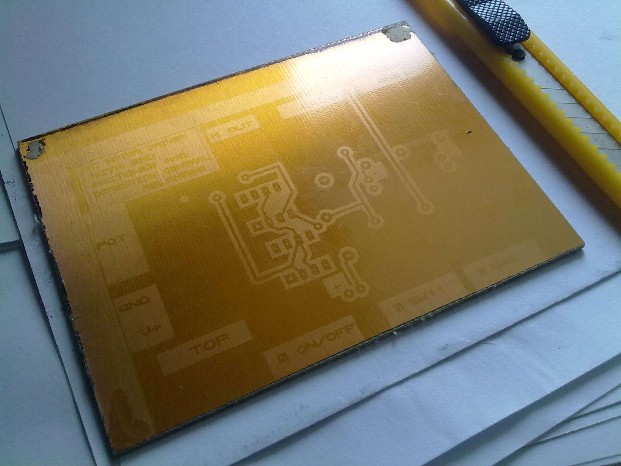

This is the picture of better exposed (first site) after developing with NaOH. What do you think?
The other side which exposed multiple times is not so promising. I can not demonstrate so much with a picture because the pattern is not visible like the previous one.

I use Injectorall sensitized boards. If that photo was one of mine, I would say it is under exposed or under developed. Although the photosensitive layer is quite thin, with reflected light, one can see ridges around the protected areas, which are not evident in your photo. Put a drop of ferric chloride on a clear area, wash it off, and check for any color change or sign of etching. Even simpler, let water run over the board and see if it is wetted. If the water beads up over the clear areas, then you still have resist present.

I think I will not used that pre-coated boards, the one in the picture was exposed more than one hour both with the desk lamp and the UV and I still do not have the exposure that I want... tomorrow I will try this Fe3Cl test and I will write the results here.
