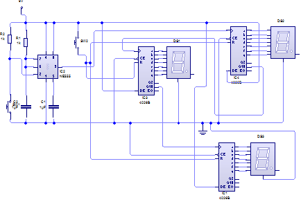

This is the circuit I have designed, I have never made a PCB before , I have only created the schematics.
Any ideas on how I can turn this into a PCB?
Looks like Circuit Wizard
Start by making a nicer schematic. Yours is very messy and difficult to follow. Please read (in its entirety) this sticky: https://www.electro-tech-online.com/threads/rules-for-drawing-readable-schematics.144863/
If this is simply a hobby project, I recommend using Eagle or KiCAD, which are both entry-level schematic/PCB design packages (you create a schematic and then pull it into a board, and it shows you where you need to connect your traces). There are hundreds or thousands of packages out there though, so I suggest just finding one that you like and go with that. Nobody can tell you what package to use--There is no "best". It all depends on how easy you find it to use. Eagle and KiCAD both have great documentation that will help you learn how to use the software.
What software did you us use to make your schematic?
circuit wizard
Thank you will look into that.

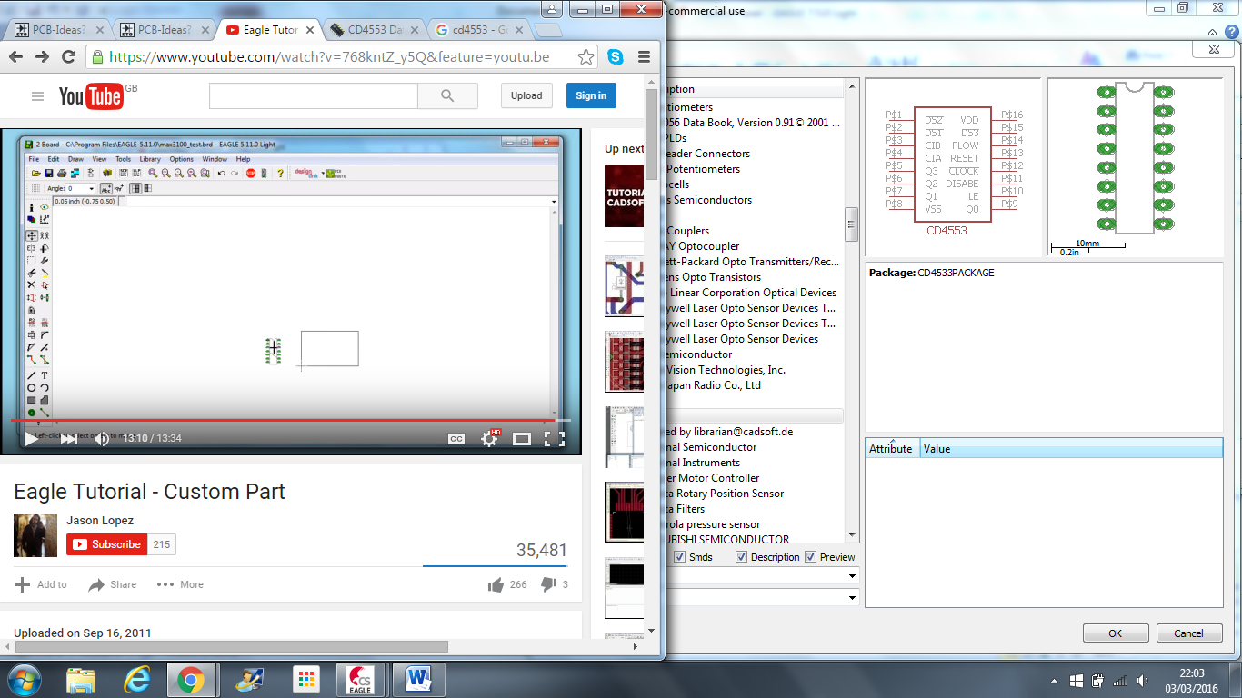

I intend to use the CD4553 IC and I can not seem to find it, Is it my computer or?
Kicad I found easier to use however it's library is very very limited to the components I had intended to use.
Does it have a way to add new components? Or a copy and edit function?
one could make components and add them to libraries yes but frankly when it comes down to that I simply do not have the knowledge and the know how to make a 16 pin IC.
It's not difficult. You only need to draw two things: The schematic symbol and the footprint. Our friend AtomSoft here made a Youtube tutorial for creating components in Eagle.
You should be able to create a 16 pin IC fairly easily provided you have its datasheet.

I'm just making it with the guidelines from a YouTube video, thanks for the help!
Thank you sir,
Just got round to doing it and it was actually pretty straight forward; two more ICs to go!
