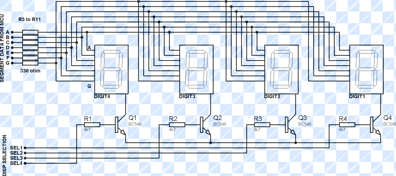

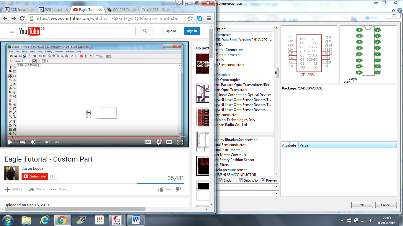

Does anyone know what this 3 digit LEd display would be listed as on Cadsoft eagle or if it is even on it.
Why not just use three 1-digit displays? You can multiplex them by connecting all of their control pins in parallel and using transistors on their common (cathode for CC or anode for CA) pins.

Something like this?
Yes, exactly, though the configuration will vary depending on whether you are using common-anode or common-cathode displays. Also, that schematic is missing something. It looks like the displays are common-cathode, in which case the wire connecting to the emitters of the four transistors should be connected to ground. Common anode displays will have the collectors of the transistors connected to Vcc and the emitters connected to each of the common anodes of the displays.
IMO they are normally shown as individual digits, only when something like the Varitronics VIM-332 that has 7 segment digits in one contained unit would show as one module.

Hy John,
The component library that comes with EAGLE is a complete mess which makes it difficult to find parts. Farnell Element 14 have a load of updated libraries for EAGLE (you have to sign up) and CadSoft have a user group where you can download component libraries. Also there are EAGLE library parts all over the net- an advantage of using the 'industry standard' home/student/small business ECAD package..
Two tips: you should be running EAGLE 7.5.2 as EAGLE 7.5.0 has a problem in that project sheets keep locking as your projects get bigger/more complex. You need to download and install EAGLE Beta 7.5.2 if you haven't already.
The other tip is to set the grid to 0.05 inches rather than the default 0.1 inches (don't use a metric grid or you will cause problems).

That will come in handy for future reference thank you very much.
No probs John- have fun. EAGLE is dead easy to use. :cool:

Go on rub it in!! I find it utterly impossible to get my head around the library system :D
If you think EAGLE libraries are difficult, have a go at Protel99. :eek:
(if you don't already know, the big secret is to 'Use' the whole library every time you start a new project sheet. That way you don't have to do any messing about to place any component, but it does make your projects larger, particularly when backing up.)
spec
Finding a component is my problem, i resorted to looking under the table in the end and still couldnt find any :D
I just match the pin headers, who cares if my 3pin led is replaced with transistor, i dont simulate it, and my circuits are simple enough, or would make a note, or rename to custom part, so i dont forget later on
I would suggest you review your design to review any input where glitches or contact bounce will affect your results. Also you cannot leave any CMOS input floating. (e.g. reset)
Ensure your V+ will not over drive the chip since you have neglected the colour of the LED and the series current limiter, thus V+ will affect I_segment and driver heat.
The other thing John is the Digit positions on the "logic diagram" should be logical, not scattered right to left. Bus lines can always be grouped if you label all the end points, such as segment letters.
