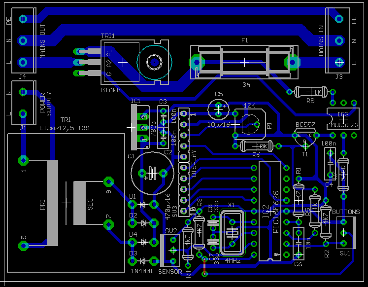

Here is your PCB design.
Board dimensions are 84.4550X65.4050mm
Boncuk

How long did it take you to create that design Boncuk? That would take me a while, but I guess you get pretty quick with practice. I've only tried designing one PCB and it was a spectacular failure, I asked someone to check it for me and the advice was basically to burn it to ashes.
The first design took me two hours including the creation of a package for the transformer.
After having designed PCB layouts for many years you have got routine to place components intuitively seeing possible collisions of traces already by looking at the ratsnest.
As for your spectacular failure I recommend to name (almost) every net when creating the schematic. Print a net list and compare with the intended schematic. There might be unconnected nets to one pin which the ERC won't catch if it is not an input pin. A missing connection can easily happen when switching grid sizes, e.g. from 0.5 to 0.125 inches. You won't discover the missing connection unless you use the "show" function which should highlight two (or more) connected pins.

I don;t want to sound like jerk because your PCB is so nice and finished, BUT might I suggest allowing a full 8mm clearance between any part of the mains voltage circuit and any part of the low voltage circuit? The very closest point between the two should be the optocoupler itself.
If I had the freedom to decide about the board size I certainly would have observed that.
The OP however wanted a PCB layout not larger than 85X70mm.
8mm clearance is a bit much. I normally use 5mm as minimum trace distance between live and neutral. Because of the size limitation that distance had to be shrunk to 2.5mm (still safe if solder stop is used and a final layer of isolating laquer).
Screw head terminals for medium power AC loads (up to 2.5KW) have a pin distance of 7.5mm. Considering pad size this distance gets very narrow as well.
I will think about enlarging the board size to an entire height of 70mm (presently it is 65mm).
