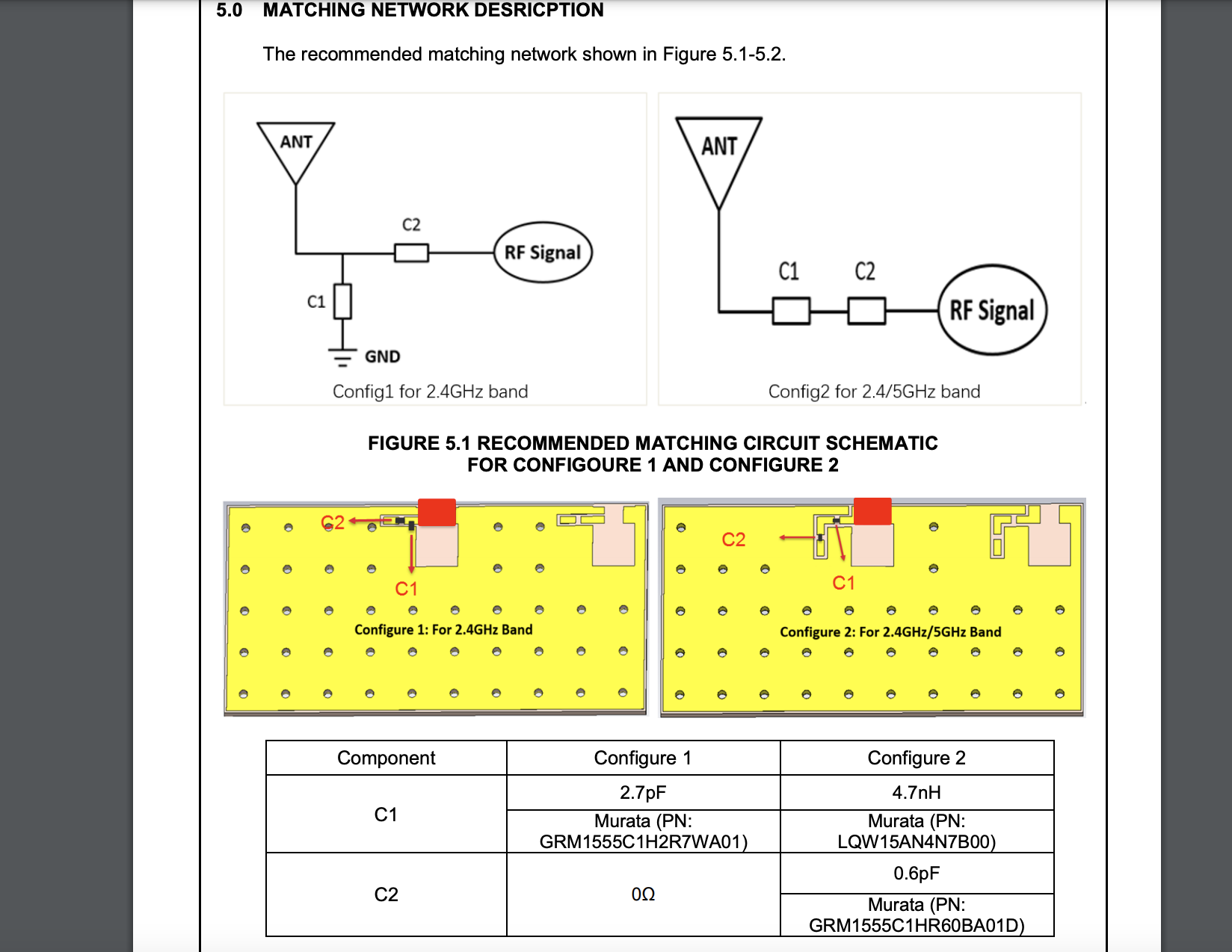

I also would like to know, in the manufacturers description of this product, it says C1 and C2, but C1 (I am running it on 2.4GHz) is a 2.7pF capacitor and 0 ohms for C2. Does C1 and C2 mean components? And what can I do for the 0 ohm resistor? Shall I just connect it straight to the MCU?

C1 is a capacitor and C2 is just continuous track rather than a gap and capacitor.
Note that the track size, lengths between cap and antenna pad, spacing from that to the ground plane either side and ground plane cutouts on both sides are absolutely critical for it to work.
The drawings in the specification document are better; you need the dimensions as on page 8, but for 2.4GHz only you want to use the three connection arrangement as in the left diagram on page 9.
Note that item is a bare antenna for a WiFi or Bluetooth device - it cannot connect to an MCU, only a device with built-in 2.4 GHz RF system and stripline connection.
